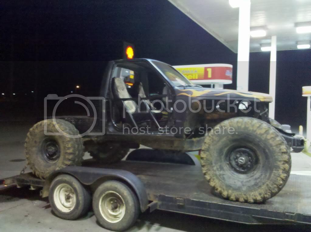

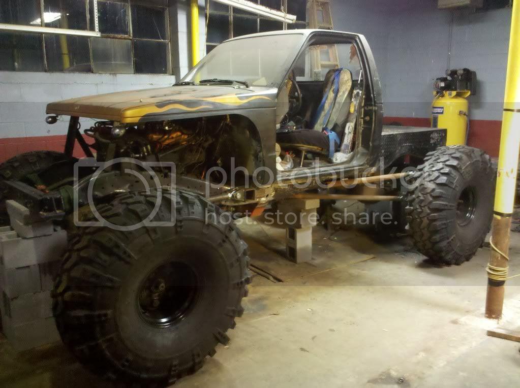

A lot more to come... got it on the downhill drag now :popcorn:

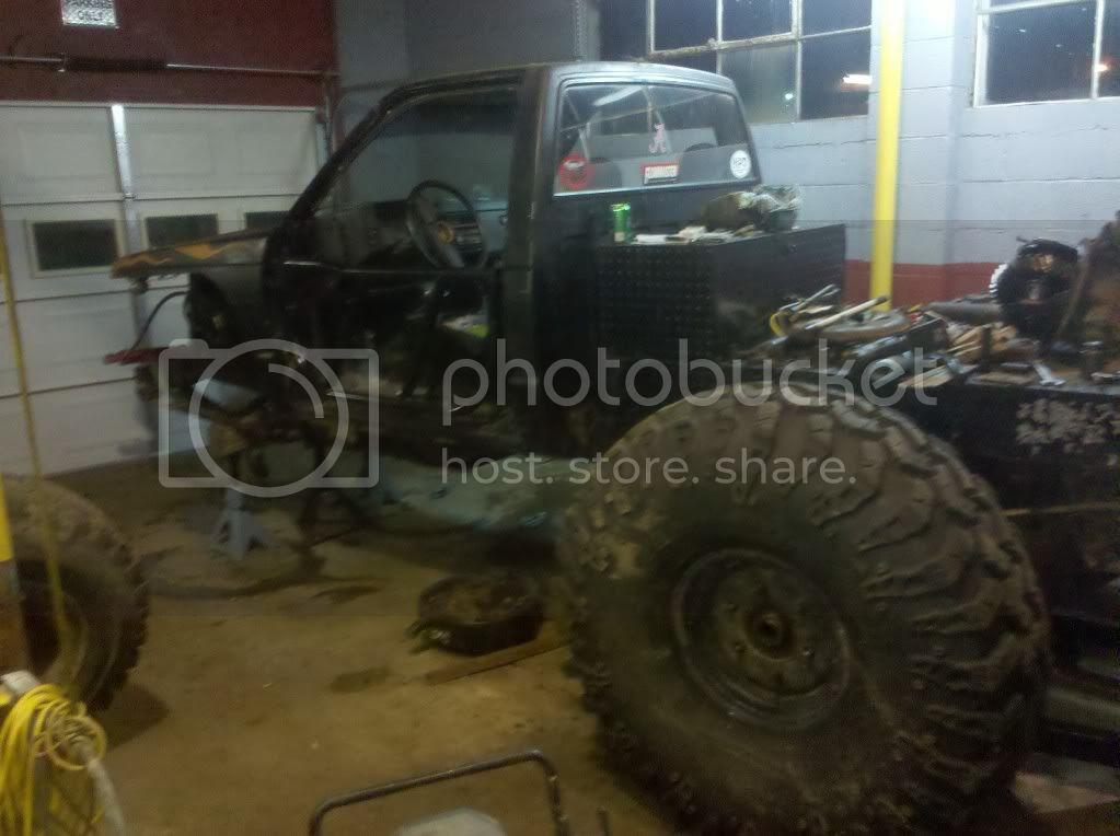

S10 cab on 3/4 ton frame
Dodge 360 (till it blows) on propane
4 speed trans/208 case

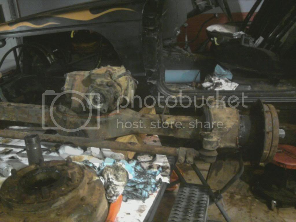

F/r welded rockwells

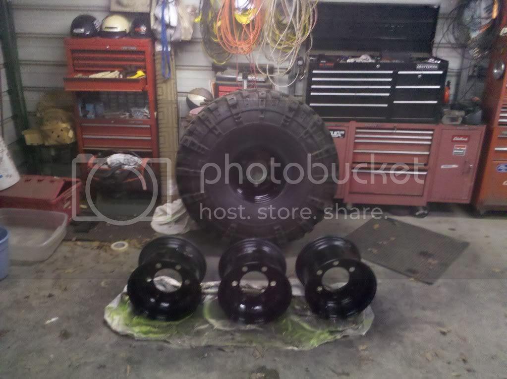

47" swamper ltb

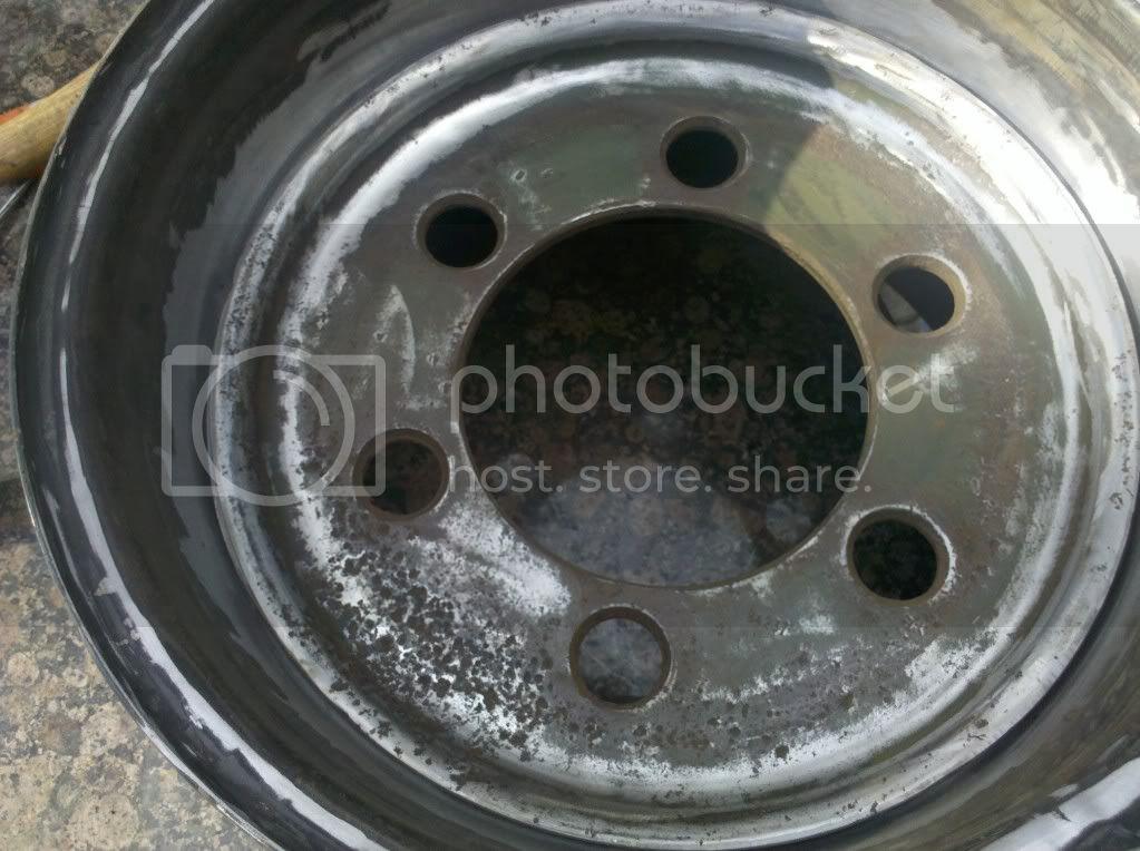

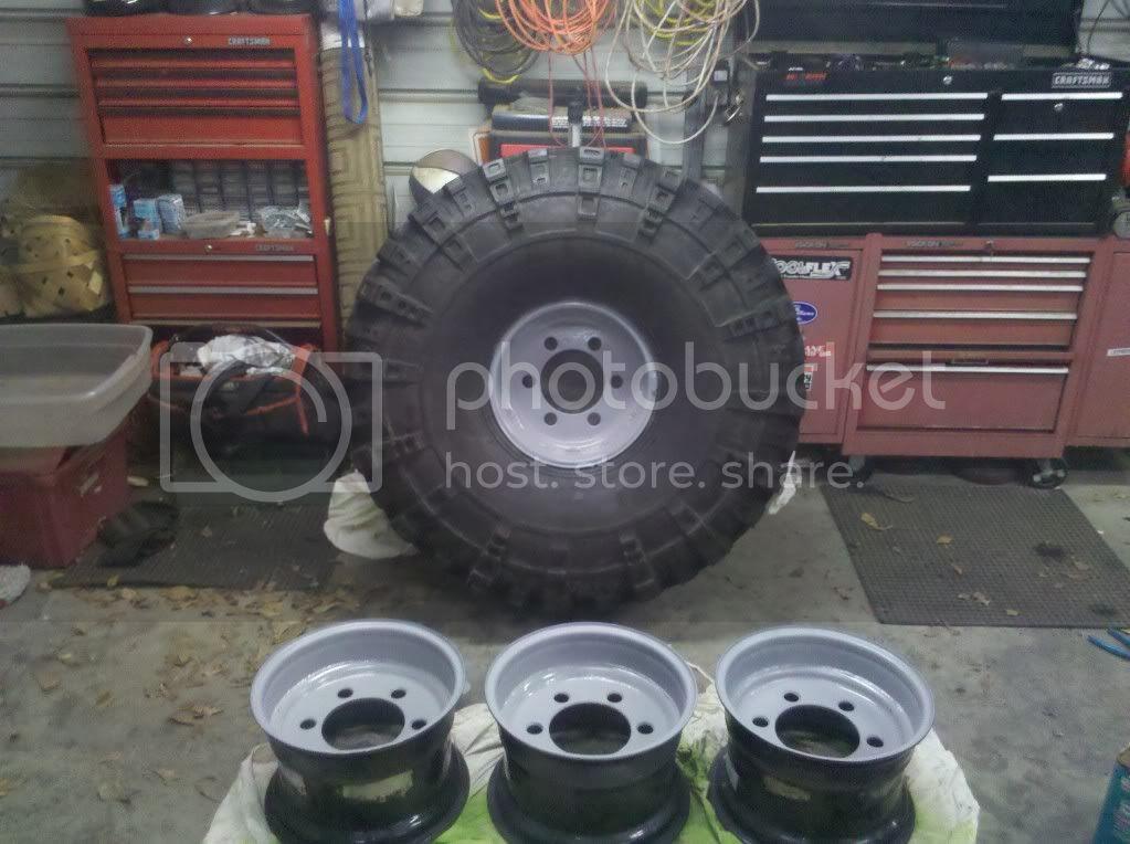

Recentered 15" steel wheels by me fab

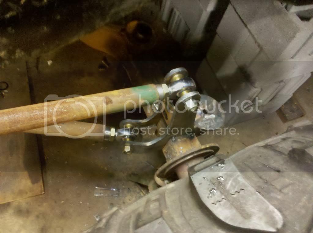

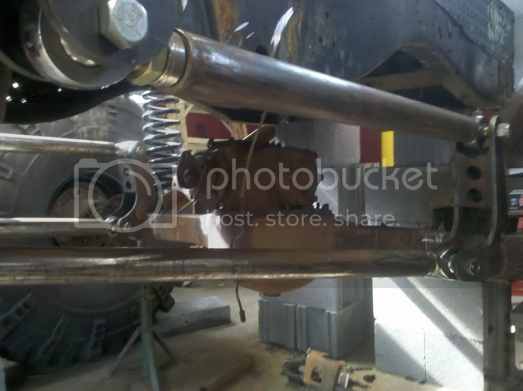

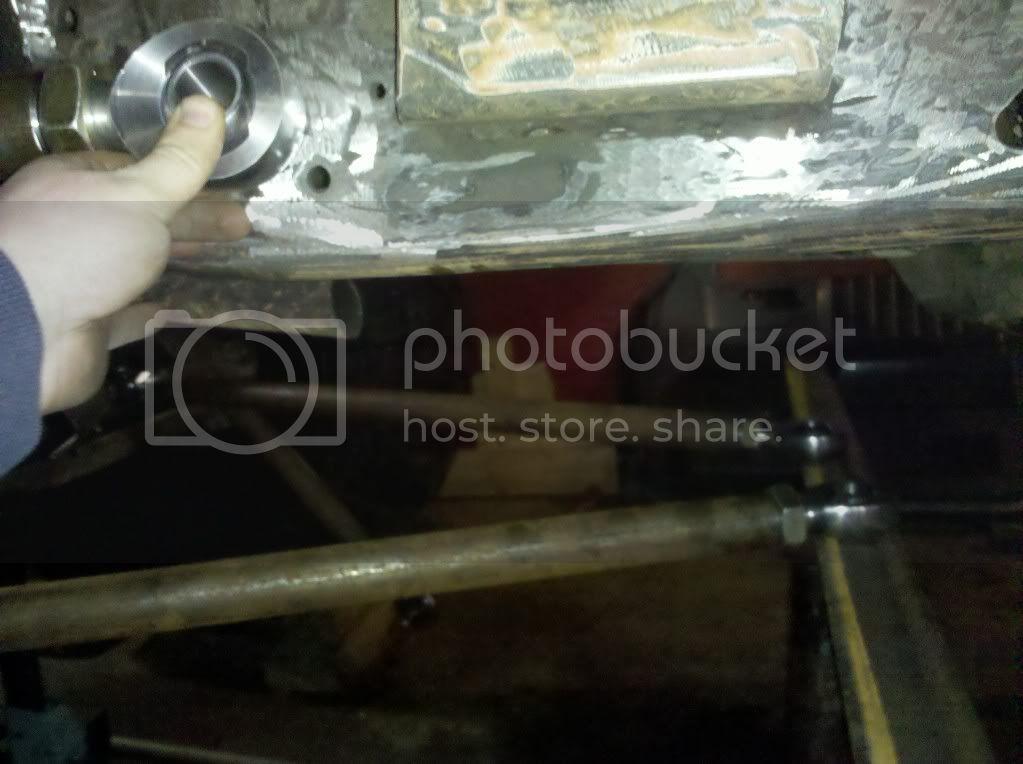

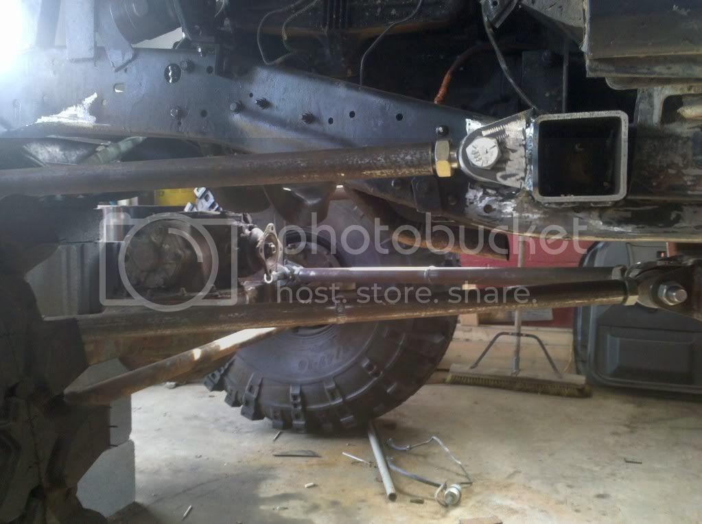

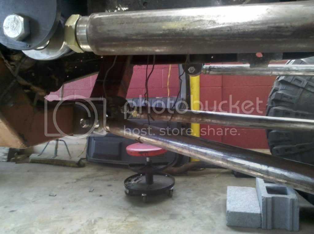

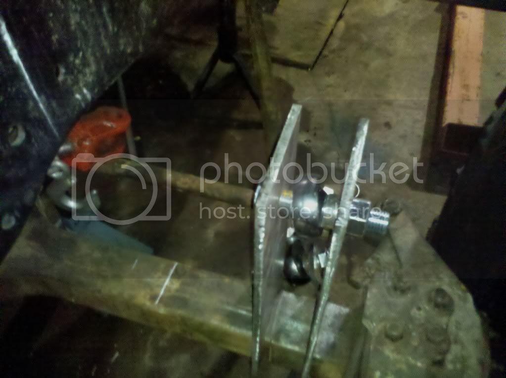

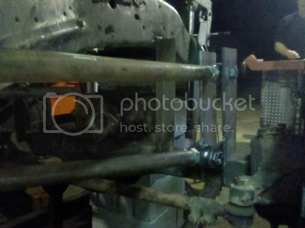

Front reverse 4 link 1 1/4 hms 1 3/4 .400 wall t22 steel tubing

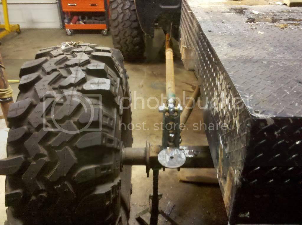

Rear reverse 4 link 1 1/4 hms 2" .400 wall sleeved t22 steel tubing
Wild horses coil springs f/r
Rancho 9000xl adjust. Shocks f/r
Diy4x pinion brakes f/r
This is my first build up so I'm figurin most of this **** as I go . But hell that's the fun part of it
Still have a lot of work to do on it but not too far from takin a test run

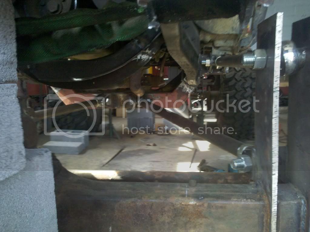

Man its gonna be a bad ass rig. Rockwells are monsters. Ur four link looks good to. I'm having to rebuild my crossmember so I got a place to run my lower links. It been a job so far. But like u said that's the fun part of.

Yea man my crossmembers are gonna be hangin kinda low but it'll be a good surface for a belly skid. I've never done a 4 link before this one but I cycled it and it seems to do what its supposed to. I went with that setup due to too damn many clearance issues up front. Guess well find out before too long
I like it. The only thing you may want to consider is the lowers on the axle on the front 4 link. The rule of thumb is at least the centerline of the axle tube like your rear is but if you gusset it good it may not give you any issues. And I could be wrong about that. Keep it up and you'll be riding in no time. I've only gotten to ride my new rig once but it defiantly made all that hard work worth it.
