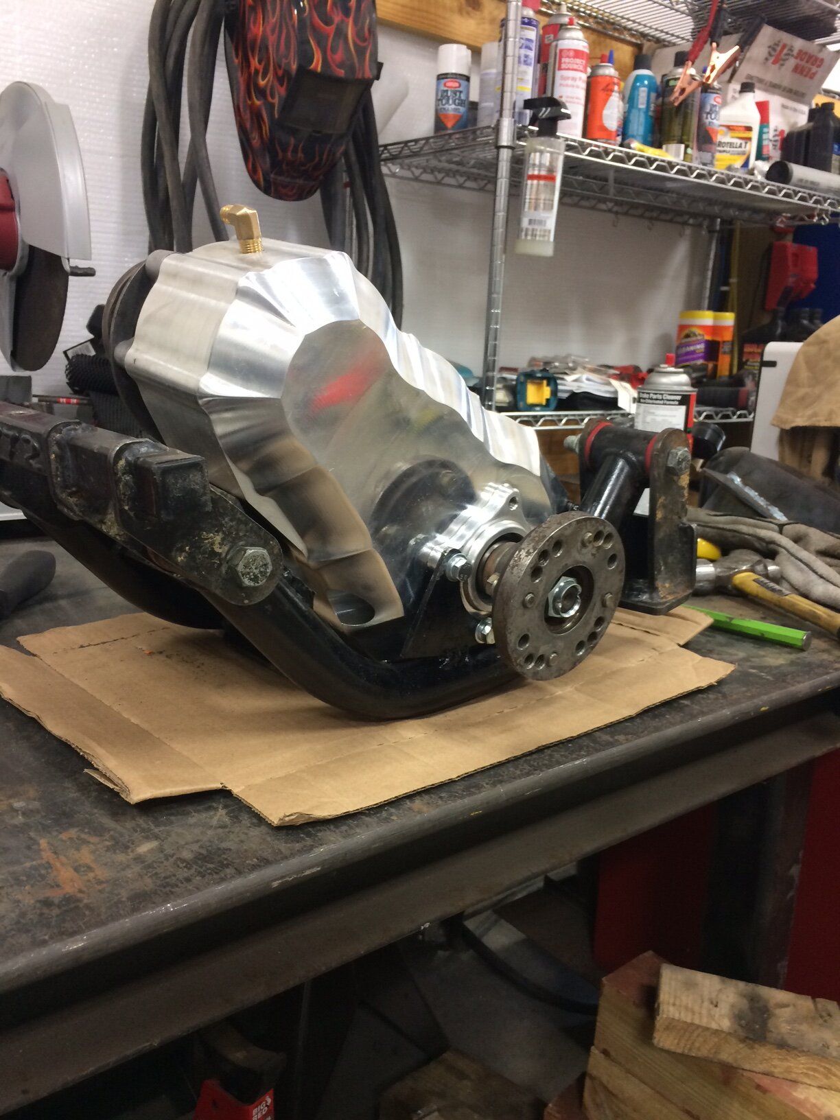

He is still makin a few batches a year. He has started in the front portion of the case now and should be available this summer

I had a heavy cradle with the stock case and still busted it. I just didn't want to take the chance of messing up another set of 6.5:1 gears so went ahead and put the race case with it. Hopefully that will solve my problem because I'm sure not going to put an atlas behind a 1.6 with a turbo lol

OOOOOOOOOOOO thats purdy!

It's an easy assembly for the case but had to do some slight modification to my cradle to get it to fit because the new one has so much more material. I believe the factory back half is 3.5# and the new back half shipping weight is like 14# of billet
