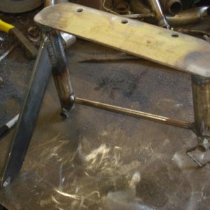

I sure some one has their shock mounted like the Yoda in the pic does anyone got the mesurements on were to put your tabs not sure if there are any pros or cons vs how far they are apart or close at top and bottom. Fixing to do this setup and wanted some input from someone who already built there cus I'm not buying one when I got the tools to build one and thanks for any help

Here's how I did mine. 14" bilsteins, doesn't use all the travel so I have room to grow into them. Shock hoops welded to the frame with some trailgear tabs. I have 63" chevy rears.
Also doubles as a place to mount a hilift and strap a cooler or whatever to it.
