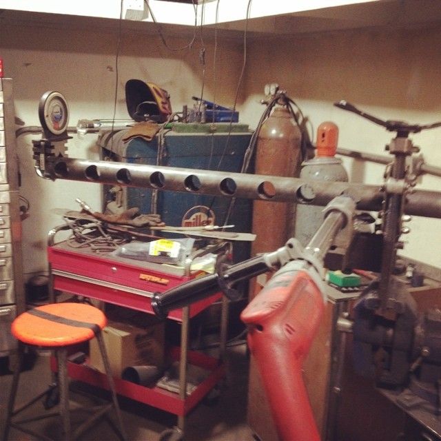

Baileigh TN 250 with Blu Mol hole saws, been using it for 4+ years. Worth every penny...
That's what I need. Worst part about the hf unit is having to loosen and tighten 3 bolts everytime you change the angle.
