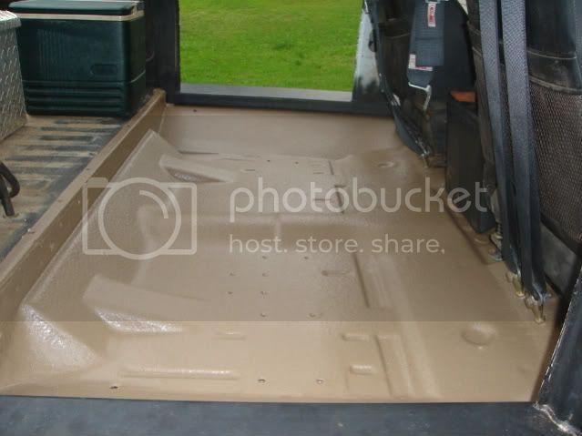

I got my floor sprayed today. Thanks to Daniel and T-Sup. It turned out great I love it. thumb.gif
Man that looks great Neal !!! :eek:
Get that pig ready to go son !! You gonna drag it to MMORV next month ?? :woody:
( saw the work you did for Capt Carls stuurin, NICE ! )

Im hoping to . Waiting on tubing for the exo now.

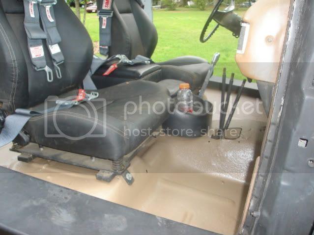

Wow that looks great. Now then when are you going to move the sholder harness anchors? Please dont leave them on the floor.
I plan on moving them after to cage is done. At that time i had no other choice but to mount the there. Dont think theyre just bolted to the sheetmetal. Thers a 10x3x1/2 flat bar under the floor. Its plenty strong for mall crawlin
nothing wrong with the seats. harness anchor points. need to be no more than 3 or 4 inches lower then your shoulders. Seats should be tied to the cage along with the harnesses.
I meant cage mount them when you do the cage. fine for now. pat's right though, in a bad collision, those will collapse your spine and cripple you if the back of your seat gives up. very low likelihood, but hey, one more thing that'll kill you. (there are so many these days, just watch the news) :flipgotcha:
