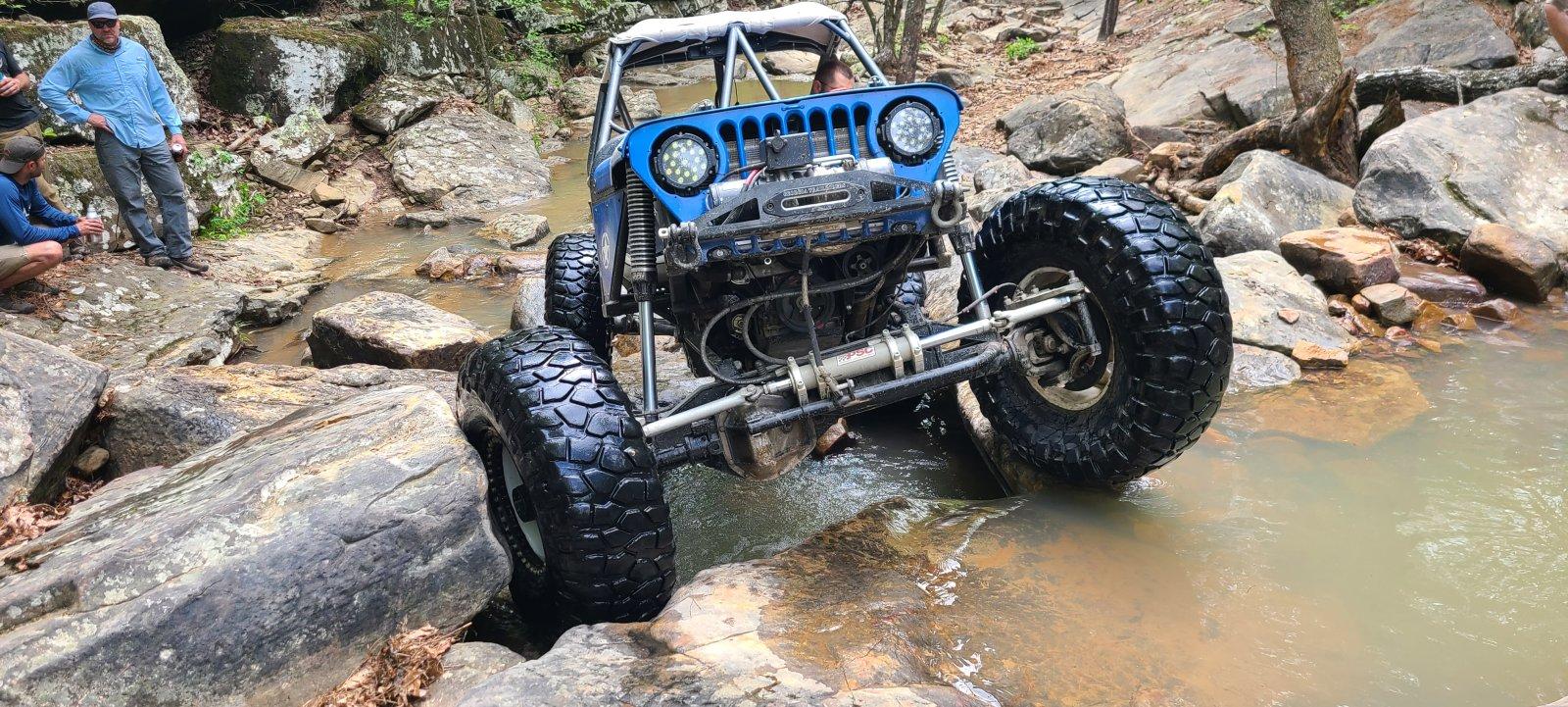

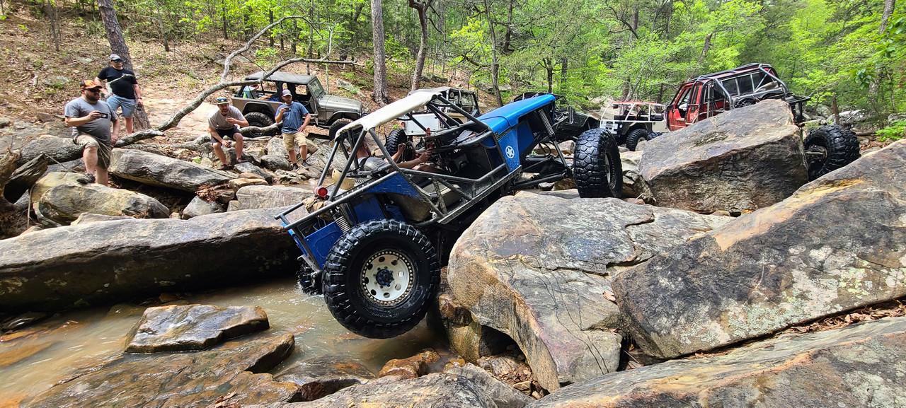

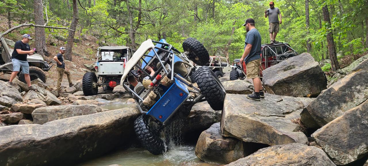

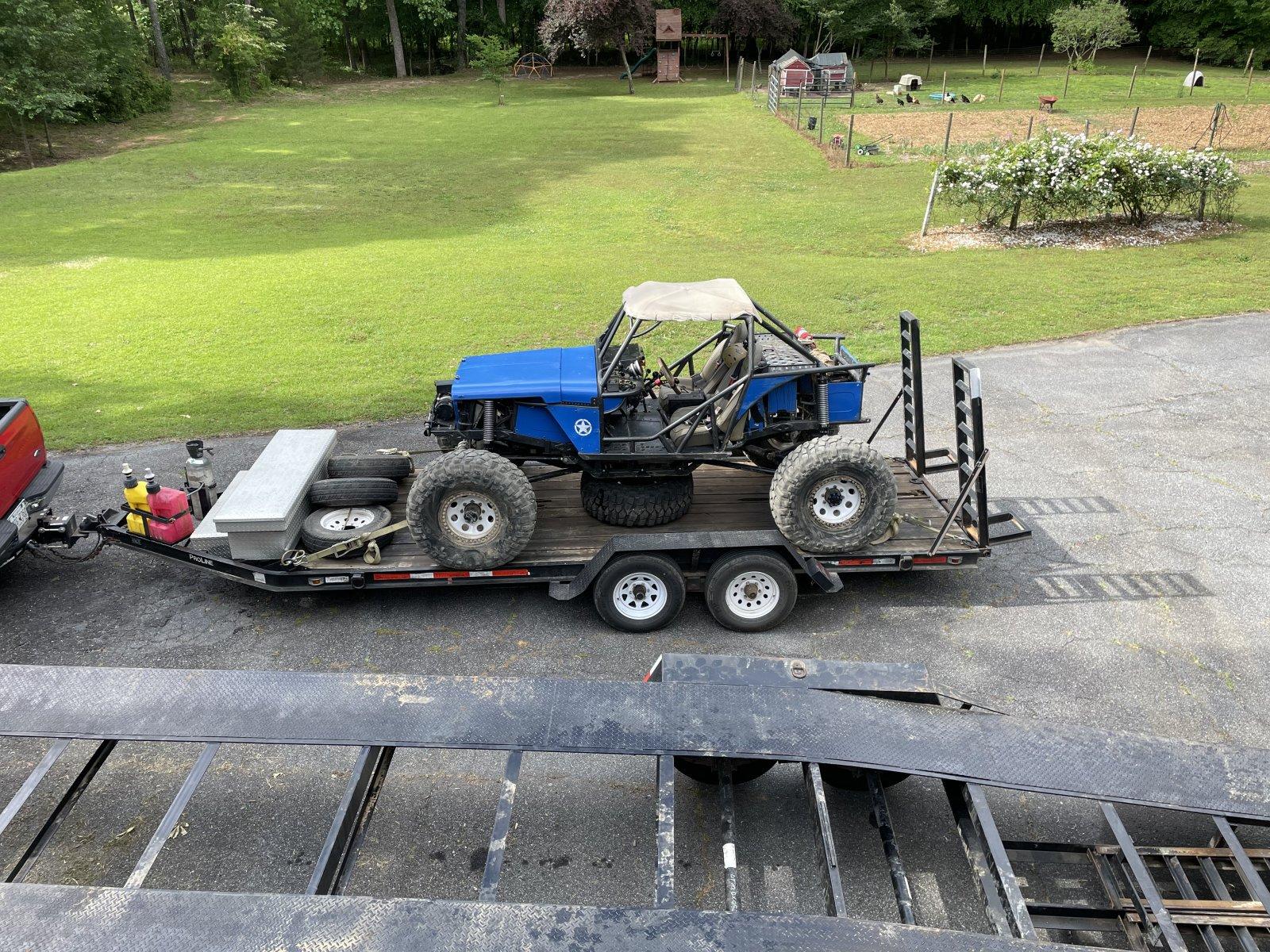

I built my rig with a Sm465 for stupid reliability. I actually bought and had a th400 rebuilt but never put it in cause I love the man tran.
I got a build thread on here. Go knock the cobwebs off the thread and check it out.
I'm stock LS, sm464, np205, rockwells, 43s and first gear is awesome for crawling. If anything I might be too low. But I like it
