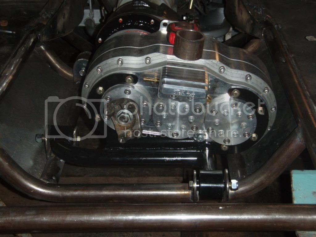

4.3 turbo 350, 203, stak 3 speed front and rear steer rocks, 16 in radflow coils front, 16 fox air/nitro rear , 47LTB and plan for it to be a 2.5/ 3 seater

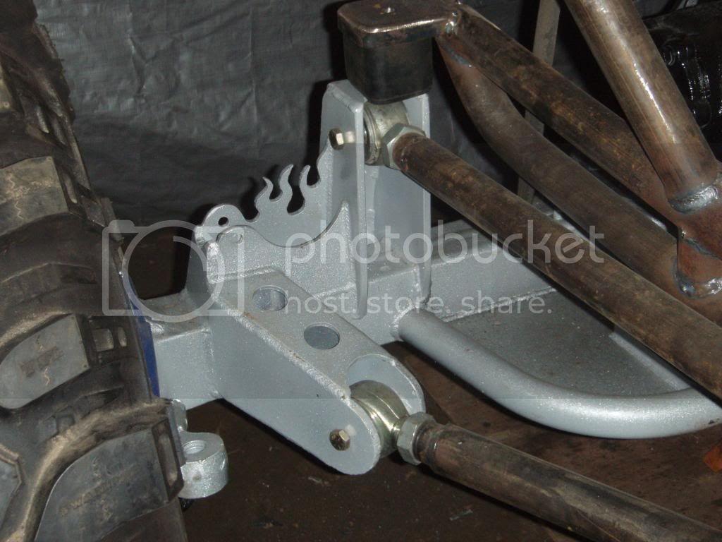

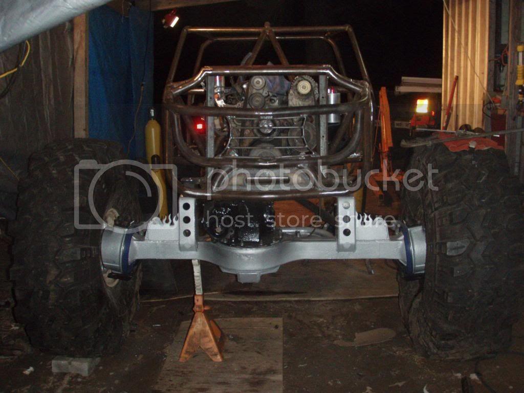

Link bolts will be a problem, just my thought
those are getting changed today actully, just happend to have those joints for mock up. the bolts in the pics are 9/16 the new joints will have 3/4 grade 8 in them.
the 4.3 is a starter motor, this is going to a lucky 12 year old, as he grows so will the motor. thanks for the replies, keep them coming. I am open to any critisisum or thoughts.
yea gearing is going to be crazy low, I would have thought the stak would be fine but the owner wanted the 203 in there as well.

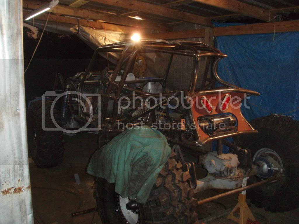

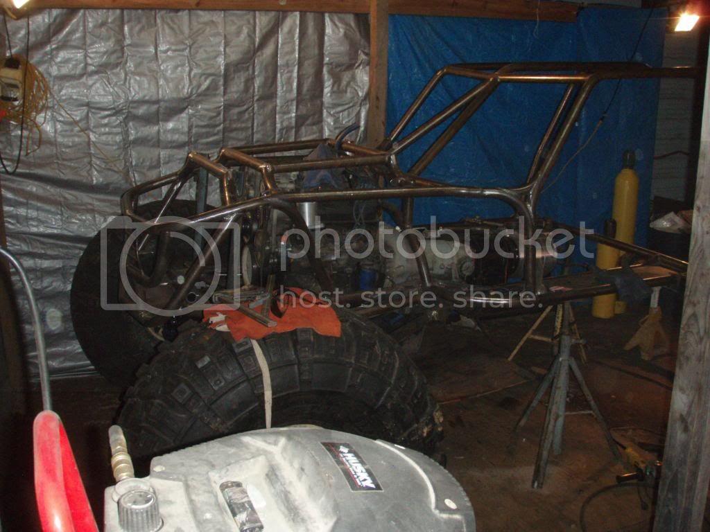

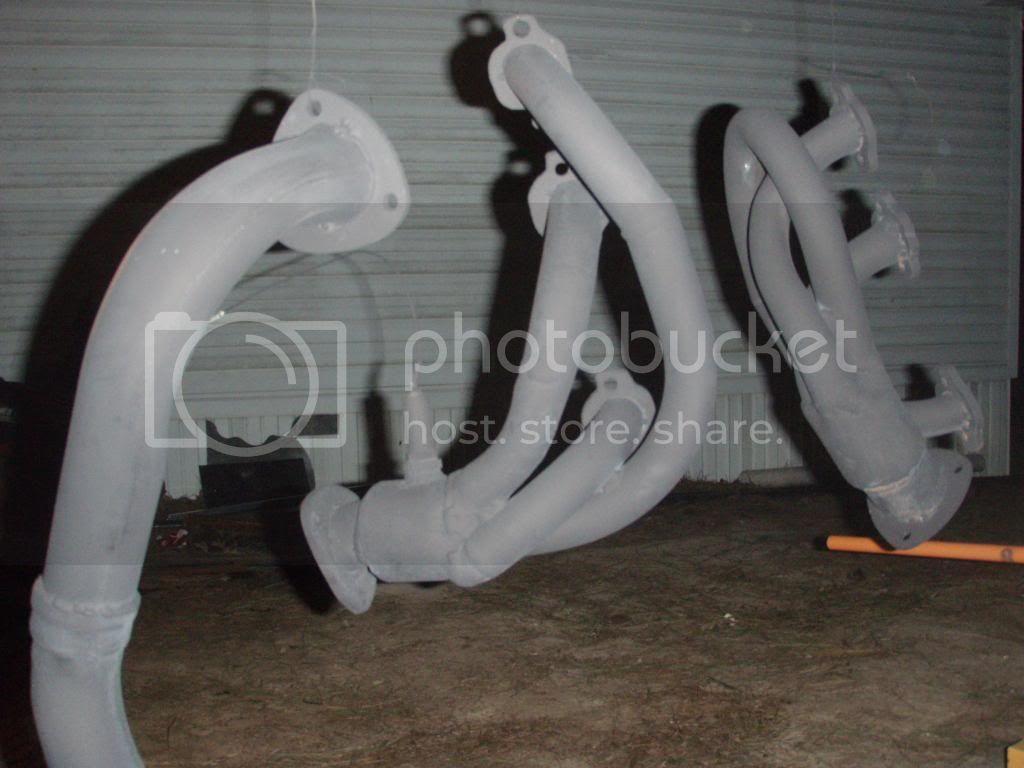

got a bit more done, my make shift headers

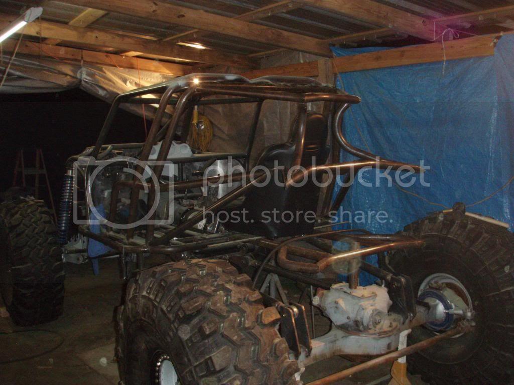

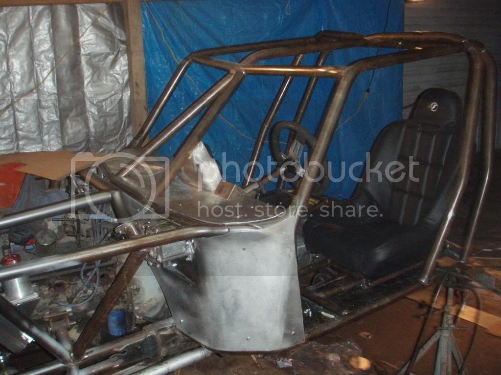

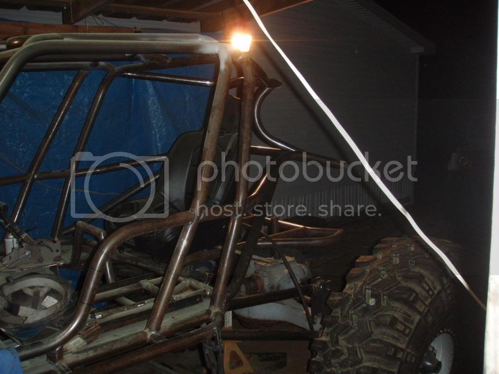

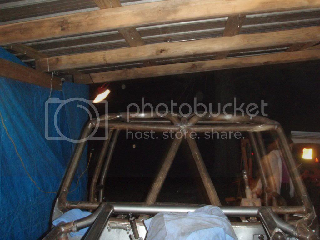

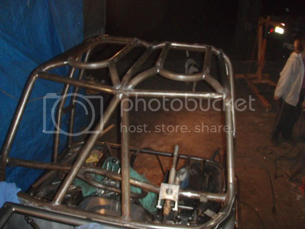

top off cage

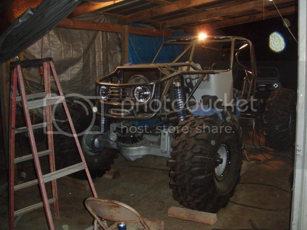

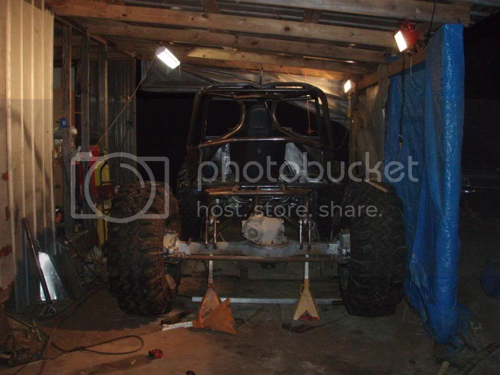

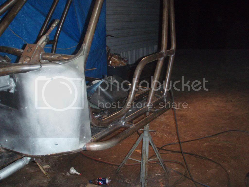

and the nerf and door bars

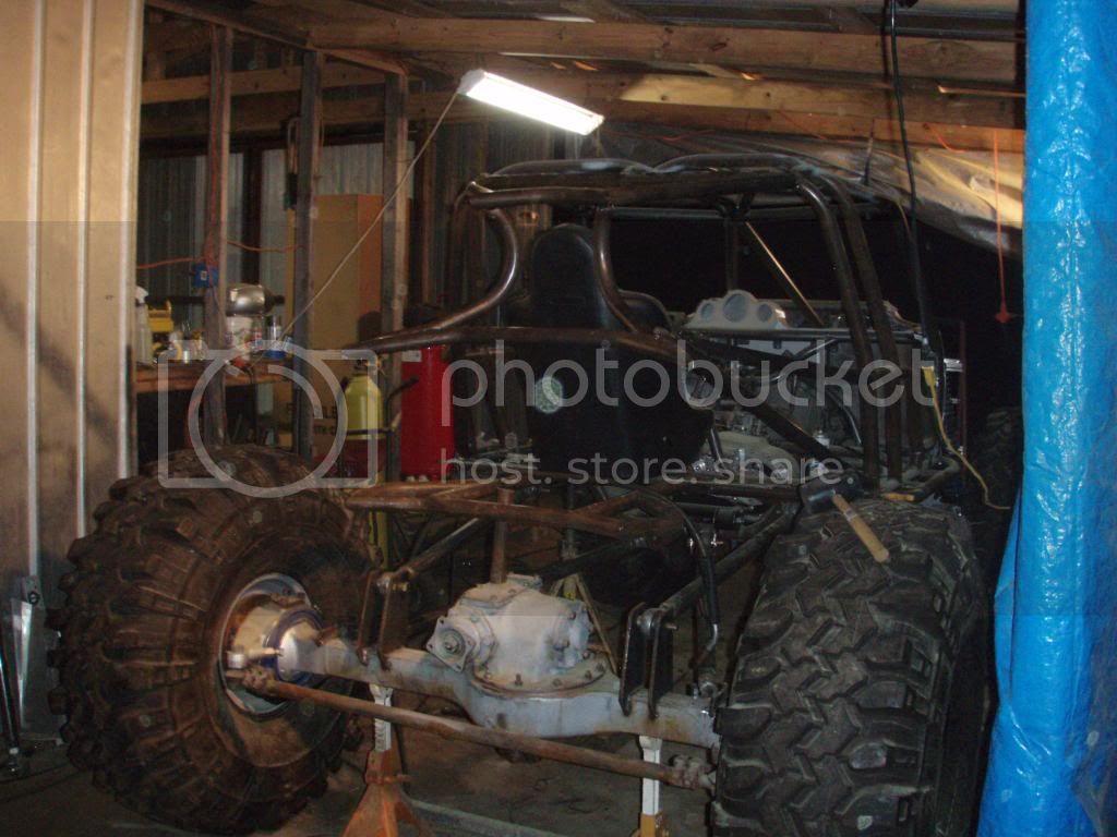

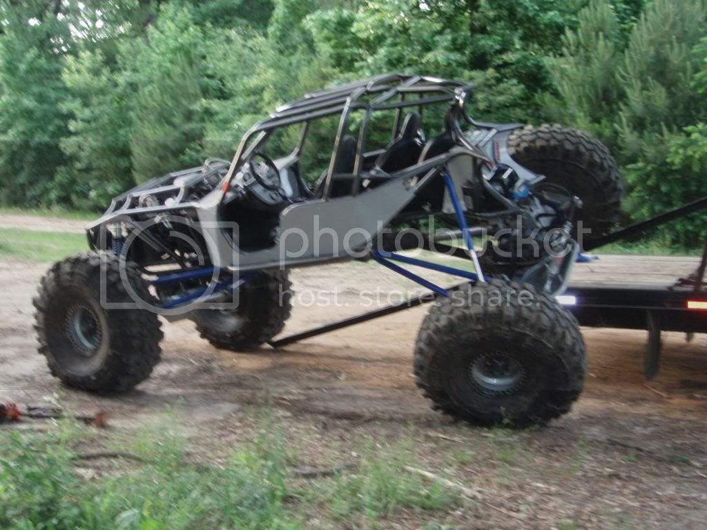

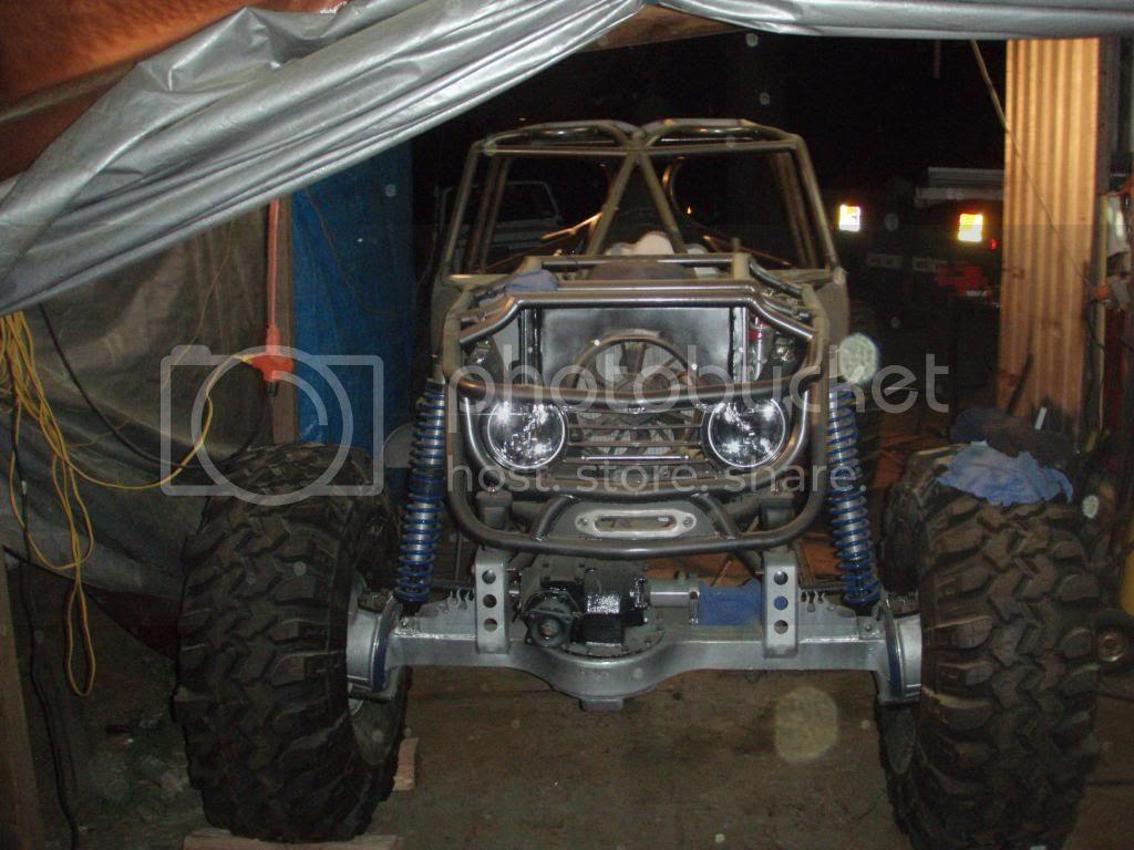

well it is a roller, still got a lot of work but it is starting to look like something
onetoncrawler said:
lookin good, how tall is it? looks pretty low for a big girl :cougar:
not exactly sure on top of cage hieght, but will get a measurement asap. should have another test shake down run this weekend. had to redo the coilover mounts on the front, the tires were rubbing and they broke a shaft. It was originaly built for air shocks.
lookin good get rid of the grade 8 fastnr on suspension we been breaking 3/4 grade 8. go too grade9 have twice the sheer strength we broke alot grade 8 3/4 link bolts on fat girl rockwell project never broke grade 9 also called L9
thanks for the comps guys. I dont think this buggy will be beat on like fat girl but thanks for the info on the grade 9, if we start breaking them I am sure they will get upgraded.
