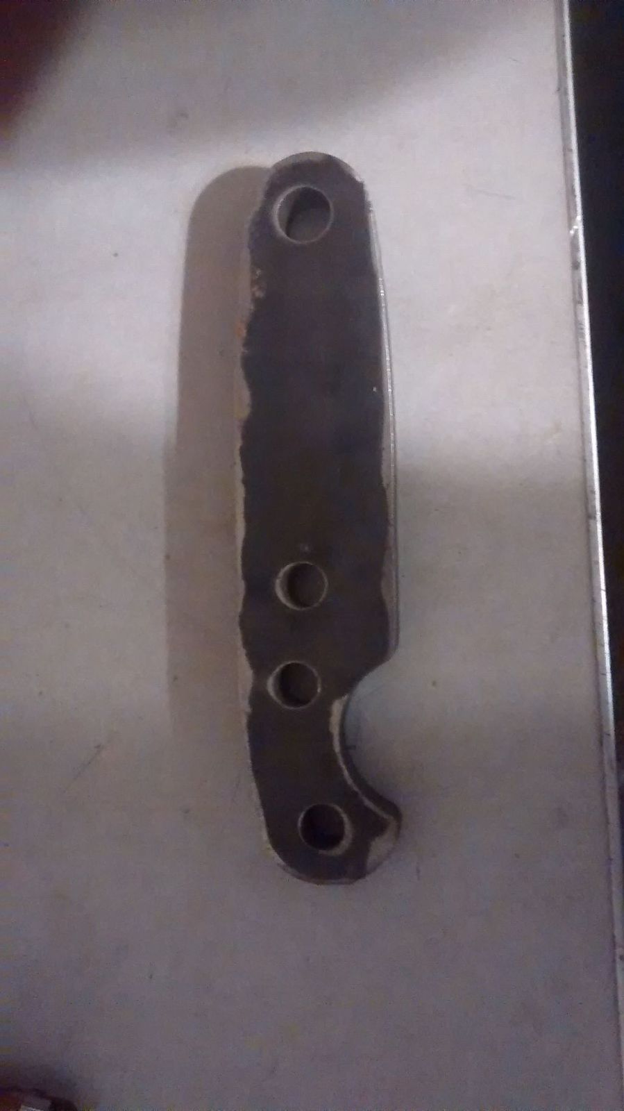

got a question i got a 10 bolt 3/4 i know the knuckles will inter change on 1/2s also and i know dana have flat tops all i can find on ebay is a flat arm i doing singal sterr from driver side bought one years ago from jims off road he went out where can i buy a raised arm

Oops.... mis deciphered ur cypher....
You looking for something like this?

well kinda like that my brother had one one time it was made from 1 peiece steel bolted to the 3 studs on the chevy knuckle then went forward they up and had a bored tie rod hole i get a pict of it and post tie some tiome
I had one like you are talking about. I got it from Jim years ago. He was having a local machine shop make them for him. I doubt you will find anything like it on the Internet.

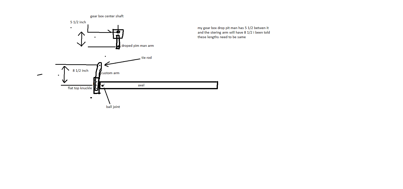

i agree biggun i goint to eather do cross over and weld it to tow in bar or build me a custom arm problum i am geting in to is that the drop pit man arm is 5 1/2 inchs back from big nut on botom and if i build a hi sterr driver side arm from where the tie rod goes in its like 8 or 10 inch in frount of the center of the axel i just wounder how it will steer with not haveing equal lengths
