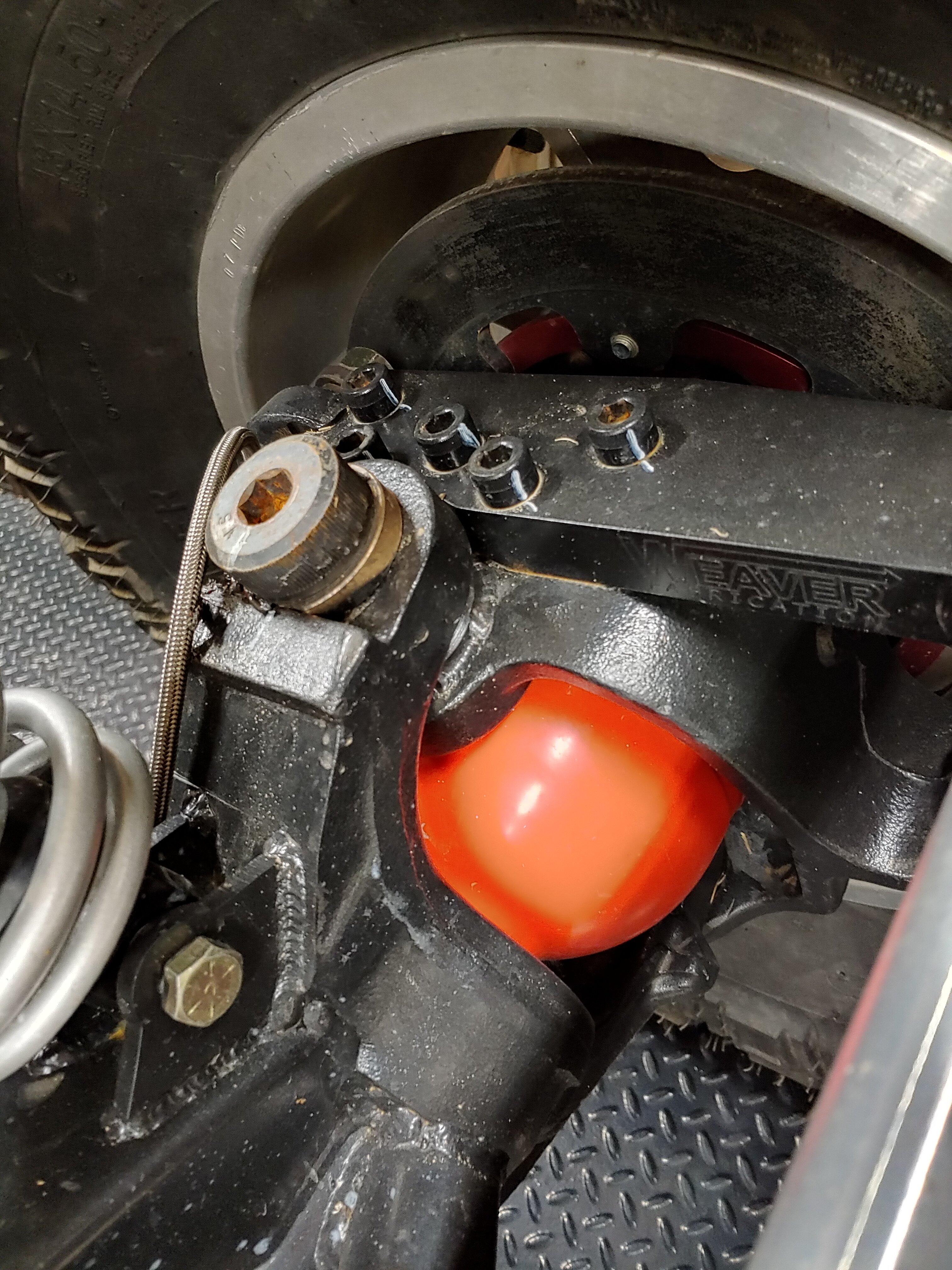

I went with Weaver Fabrication too. The picture below shows the arms mounted to the knuckles. I don't have any good pictures of the machined knuckle surfaces. For each of the five drilled and tapped holes in the top of each knuckle, counterbores were added to accept sleeve dowels. Of course, those same counterbores were added to the bottom of each high steer arm, so the dowels have engagement with both components. They're a tight fit, so I won't insert the dowels until I'm ready to go together for the final time.
