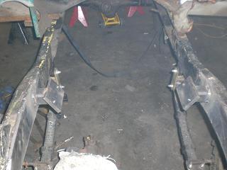

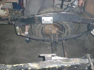

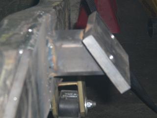

the motor mounts are in and the front of the frame is boxed. coming soon; radiator mount, cross member, grill, hood, steering colum, and brakes. hopefully toyzuk has the motor rebuilt and ready to go in by then.:D
