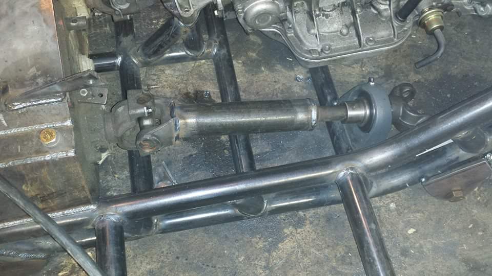

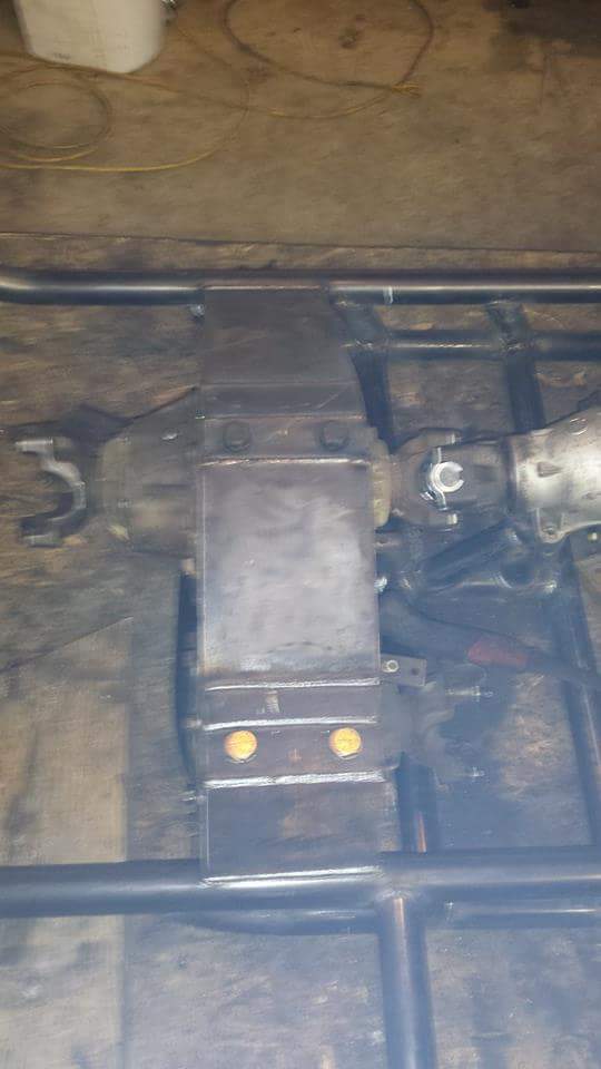

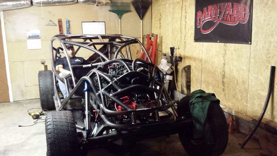

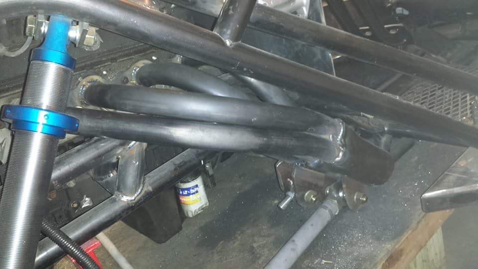

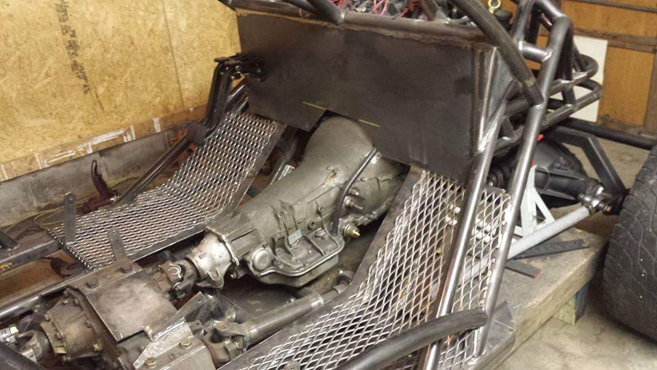

I'm running a divorced 205 also but put it behind the seats so I could smash everything as low as possible. I've bolted them straight up like that before and if its not perfectly in line it'll go through a u joint almost every trip out.
Bigfkr I try to take of our customers there three of us partnered up and i just picked up the buggy to fix acouple problems overlooked cause it happens.the rzr build was a lost cause and its does happen cause nomatter what u cant make everybody happy...i built 16 chassis last year and only one comes back thats pretty good if u ask me for the first year.
