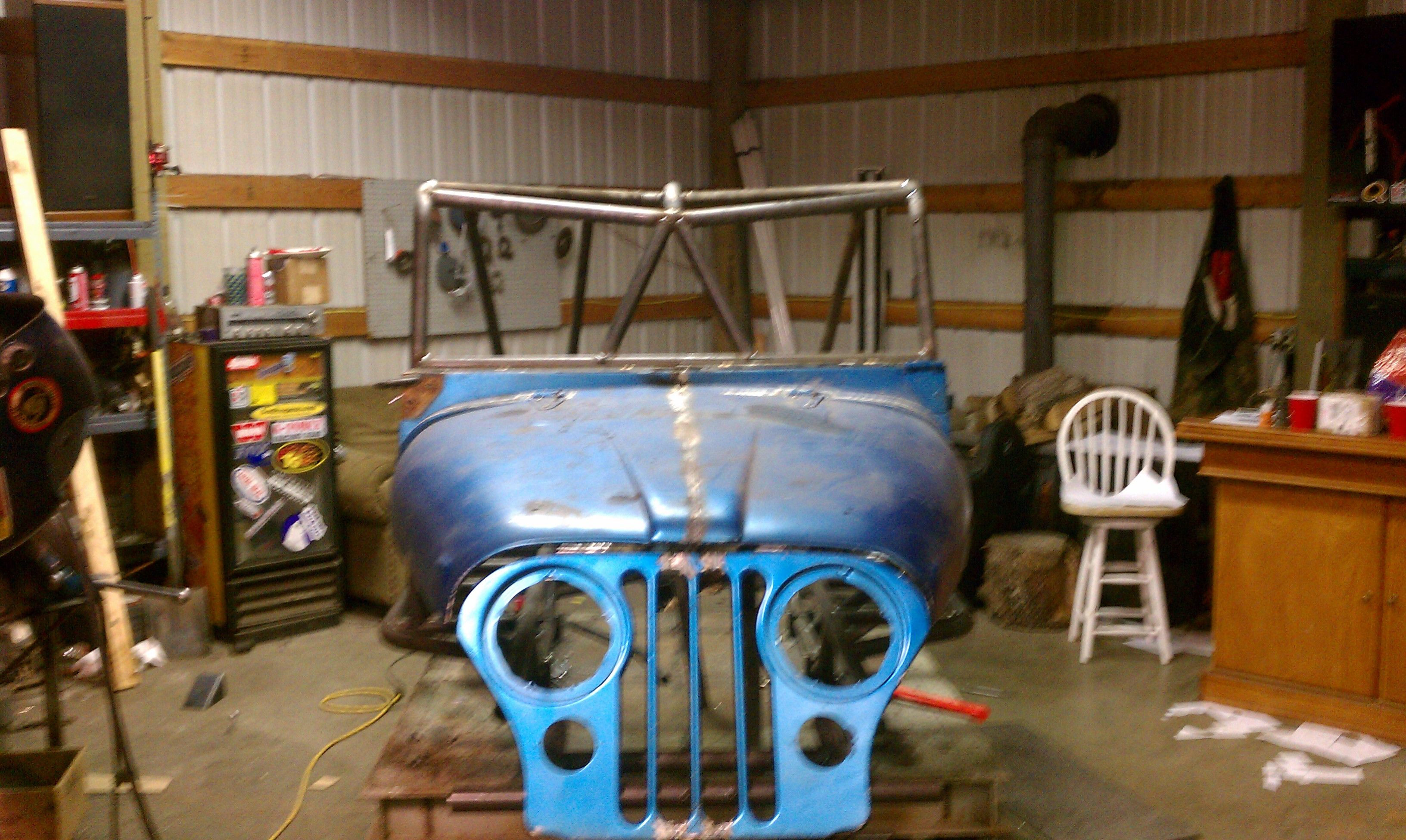

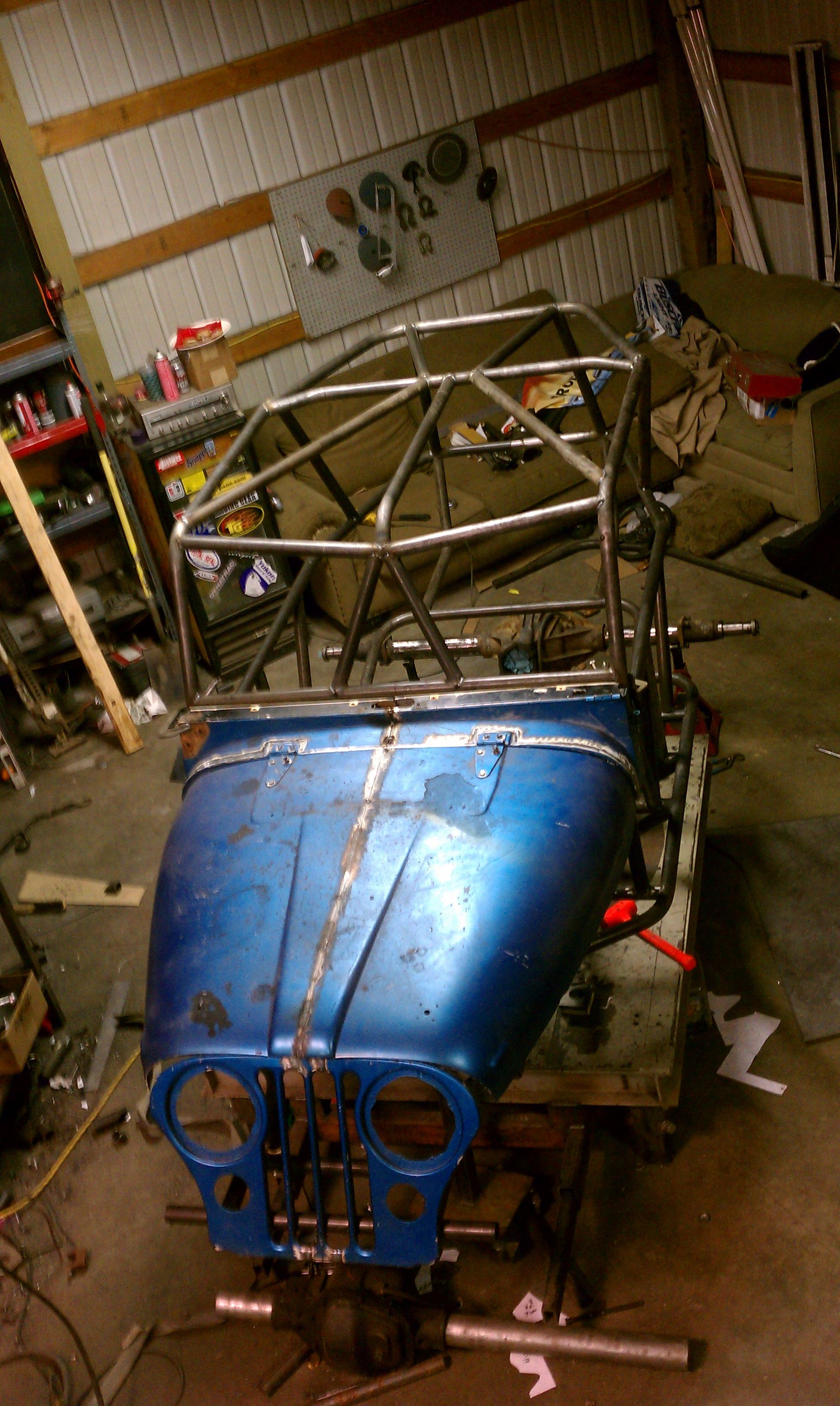

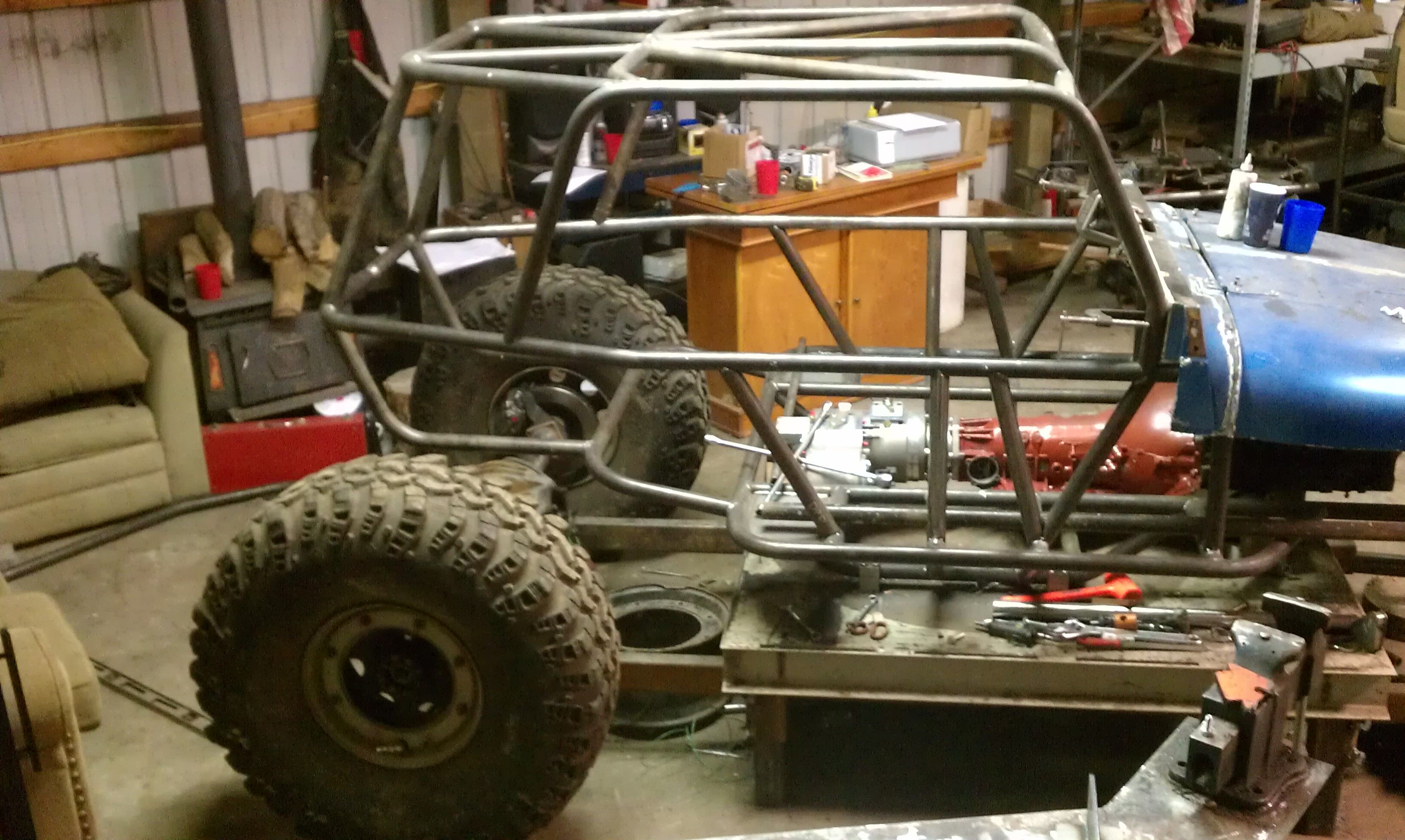

Hi guys love the site and thought I might share a pic or two of a build have have going for a guy up here in yakima wa.
Spec sheet
Insanityfab 3 seat chassis. ( my shops first full chassis build)
6.0
Turbo 400
Atlas 4 speed
King pin Chev 60 front narrowed to 64 wm to wm and a jantz 76 kit.
63 wm to wm 14 bolt rear
4 Link front and rear with 1 1/4 hiems
Shocks will be 14 front 16 rear ( type unknown as of now)
Narrowed CJ7 front clip
That's about it for now let's see if I can post some pics. :dunno:
Still have tube to add at the a and b piller tubes for added support but you can see the basic chassis design.
