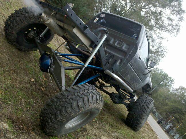

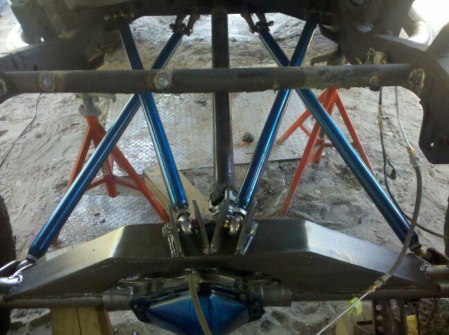

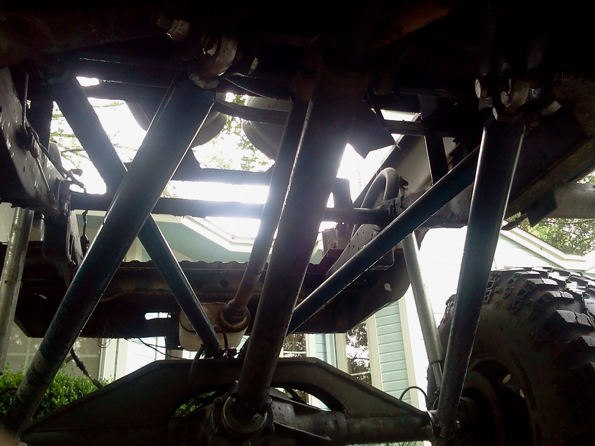

My internet is messing up thats why i havent posted back i can post pics soon ive got two propane tanks in the bed thats it 2.0 air shocks for the rear i was running 30 pounds in the rear because i was driving it on the road i lowered them a bit an it helped a little bit still had wheel hop i think its got alot to do with not having alot of weight back here most of the inside of the bed is tore ot ill try an post some pics an im running iroks on 15x12 with 2 in backspace
Few pics
A side shot on flat ground would be more telling. Seems like a lot of the Toyota link setups I see with 4-5" lift had high AS. Running the links closer to parallel could help but I'd plug your numbers into the 4-link calc just to make sure you know where you are starting, and what you can expect with different changes. No point just moving bars around and hoping you get it right.

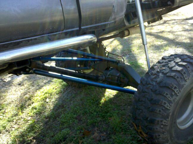

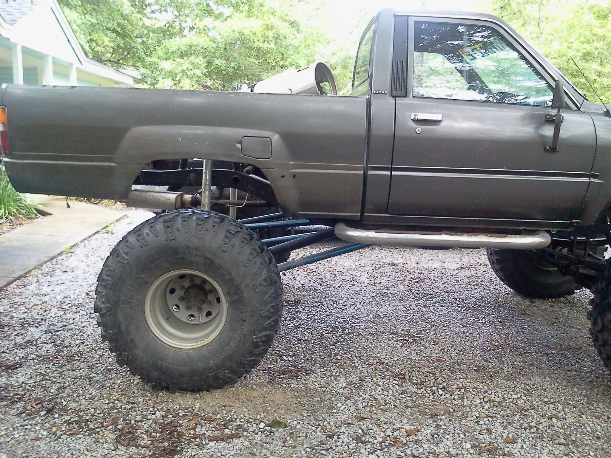

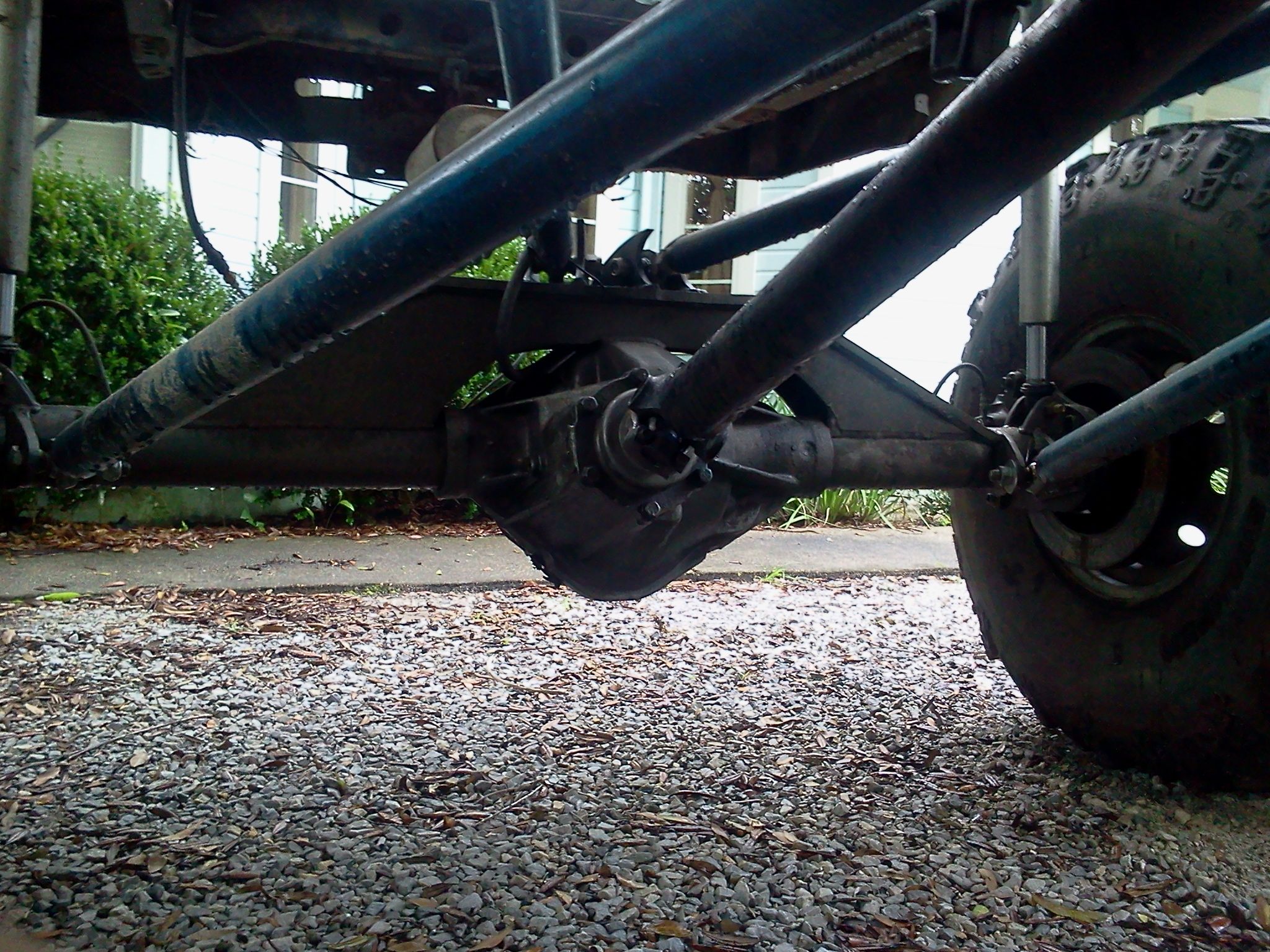

More pics
All you need to do is buy shorter shocks, or relocate your shock hoops higher and drop your ride height by 5" or so.
That would probably take care of 90% of the problem.
The rest could most likely be solved with tire pressure and shock tuning
Moving my shock hoops up an closer together was my plan because if i flex to much one way the shock hits the tire i also have to make a limit strap for it.i appreciate the help an ill try an get it its a work in progress for my first build
