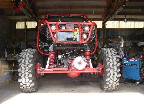

I am getting ready to get my rig out of the garage, however, when I turn the steering wheel lock to lock my truck leans in the direction of the turn. Track bar issue?? Any help would be appricated. Thanks, Lynn

How are the diffs locked up? The lean is being forced becuase of the traction at the ground. If you do it in gravel does it still happen? Is it linked up with coils?

Patches your track bar is SHORT and the angle sucks teh ballz.... longer and flatter and it shoudl help your issue among other things you'll run into shortly...
Crash, I have spools in front and rear. And it dosn't really matter if I'm in grevle or pavment. And yes it's 4-linked front and rear. Sounds like I need to flaten out my track bar.
Thanks all for the input, Lynn
Full hydro steering? It shouldn't matter when you turn the wheel.
Or is this only when moving?
Does it lean in the direction your turning or away from the direction your turning?
