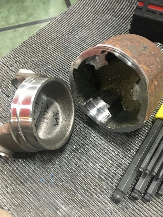

Then get a buddy or shop to machine your cv cups to accept a weld yoke and walla
Kindof like I did. This pic is from a honda setup, but same concept as yours I think.

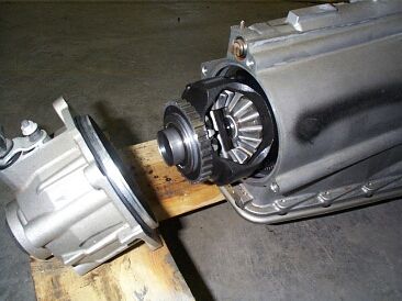

That was the pic I was looking for I just decided to tear into it this am and got that far. I'll weld the spiders in the am and put it back together. I'm going to see if I can get a spare set of shafts since we are going to Ben in Moab a week and want spares
