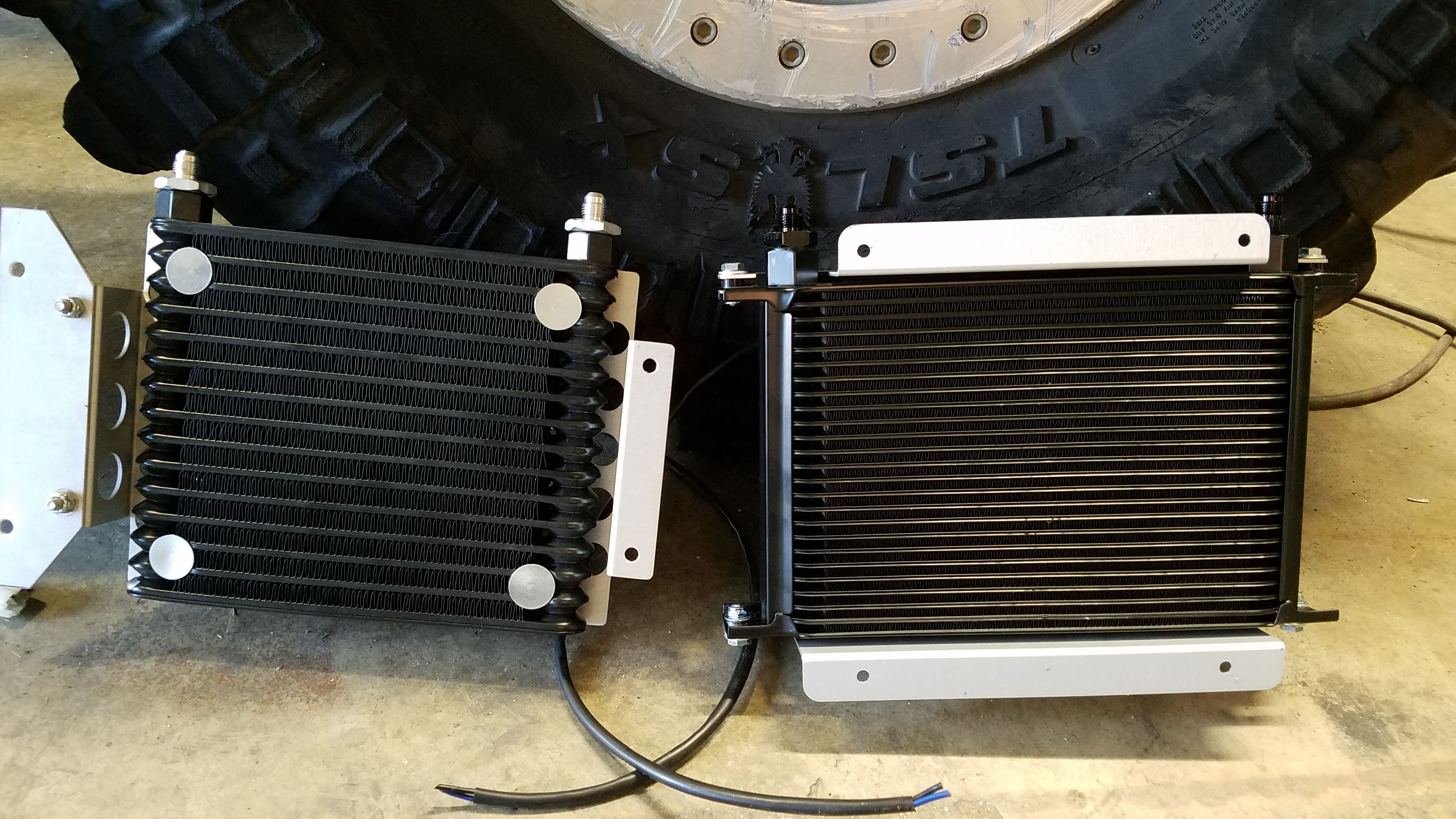

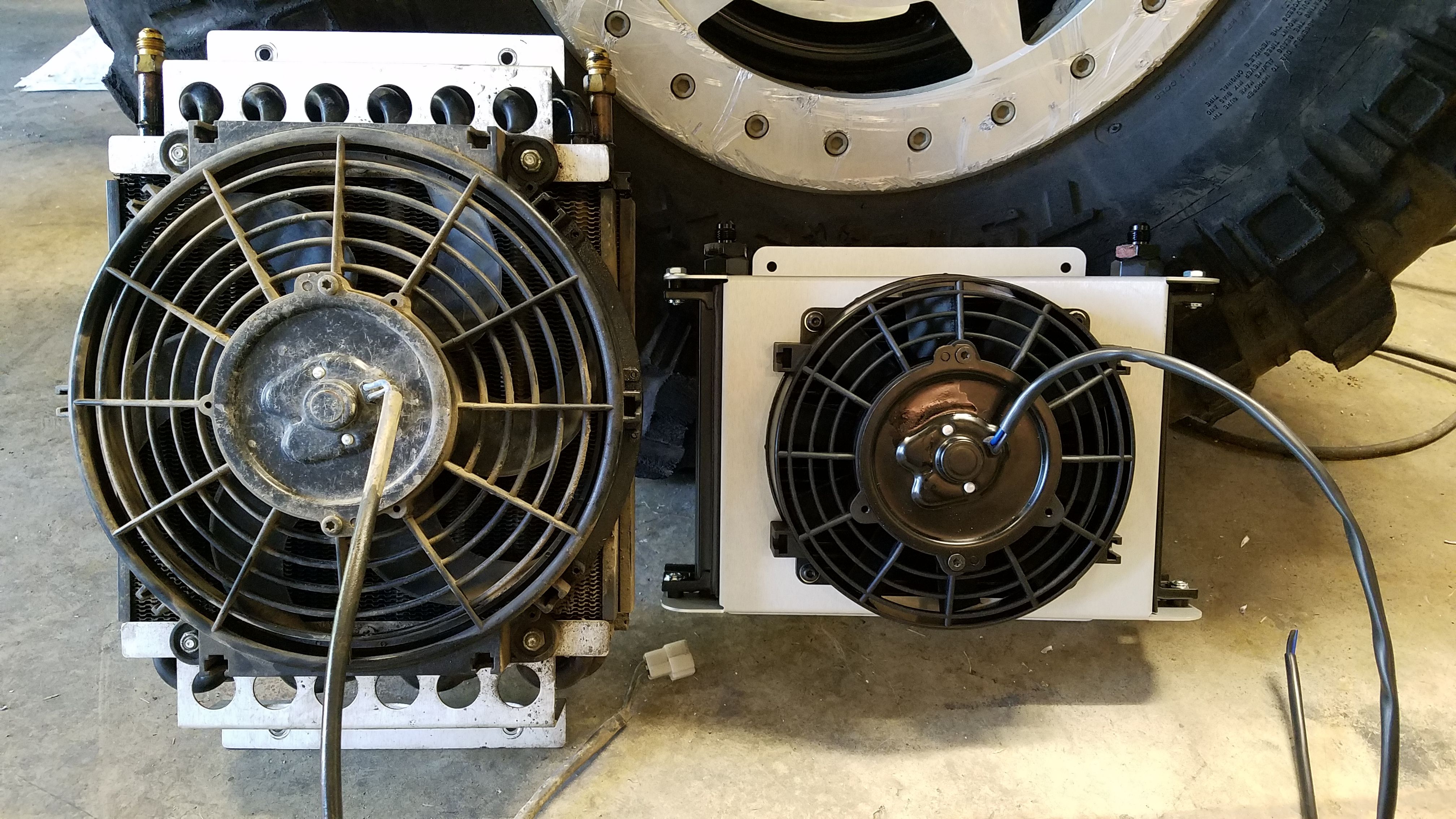

I'm actually working on swapping in a 13760 right now. It's quite a bit smaller than the one coming out so hopefully it still performs better.
I've got another stacked plate cooler thats just a little smaller. Wondering if I should just throw both in right away.
Actually, I guess the other one is a plate and fin style. Can't even find a btu rating on it so probably not worth the hassle there.
The 24 row is smaller but should definately cool better than what you had in my experience. I think you would be fine to run both if you have room. I know you already bought the 24 row but if you have room and are still concerned that 40 row is obviously better. It didnt sound like temps were really getting out of check before anyway. My 2c
Yeah. I ended up just doing the one 24 row. As long as it's at least as good as the tube/fin that was in then it'll do for now. Plenty of room to go bigger in the future and this 24 row could always go in the wifes yj that has a low stall and will be mostly street driven. Fwiw, I've never had to shut down in the middle of an obstacle to cool down. Usually just let the fan run while I watch other people go and it's good by the time we get moving again. I guess we'll see how it does in a couple of weeks.
