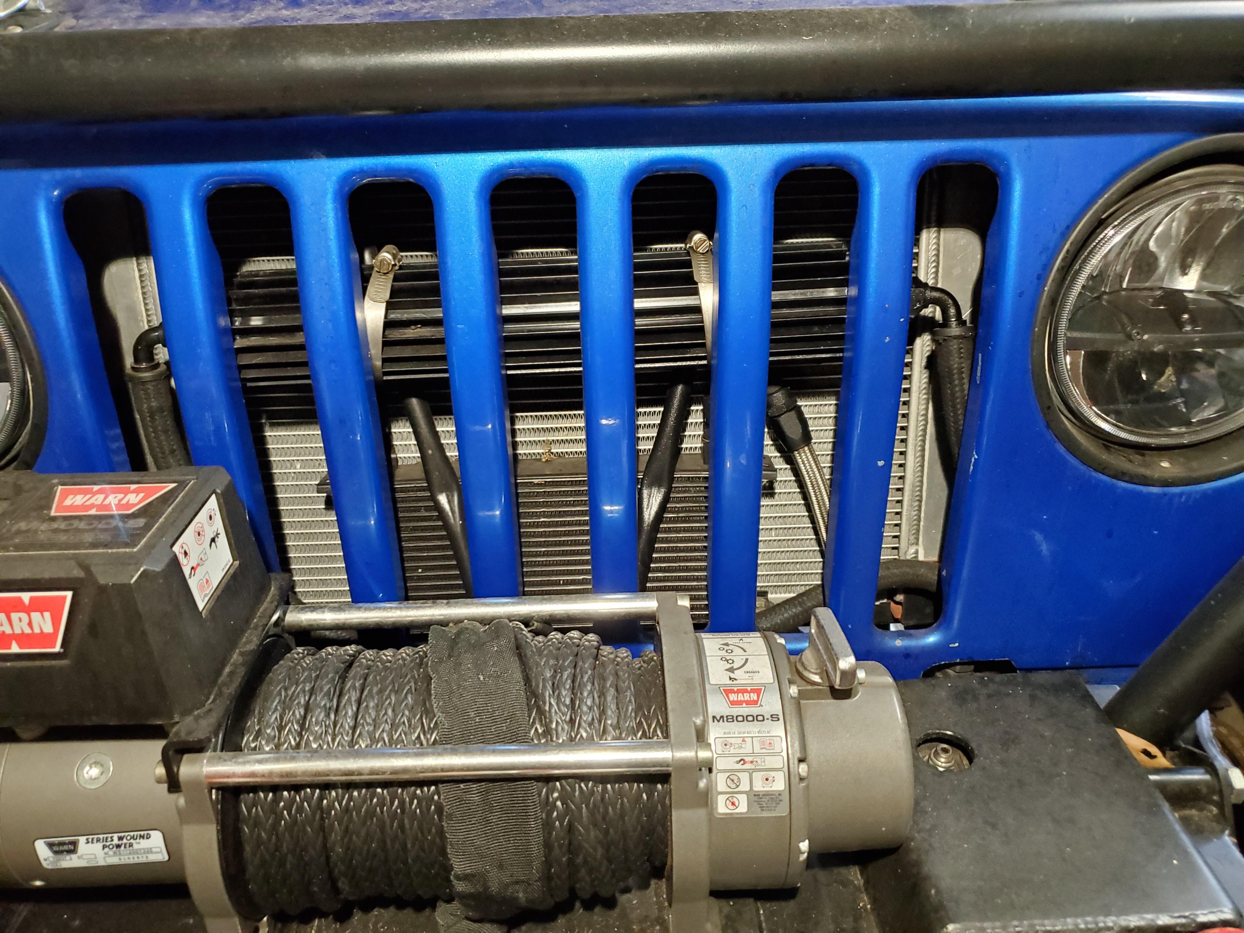

I use a big cooler ( Tru-Cool - Max LPD47391 )
That's what it looks like

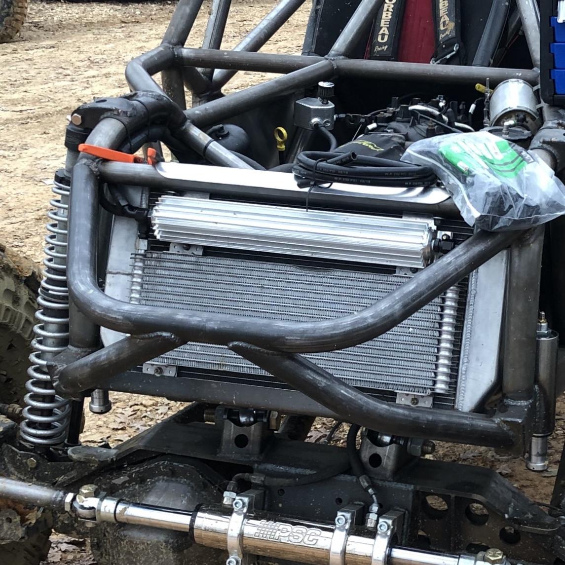

When you say you have a Derale stacked plate cooler, is it a remote one with a fan (like the Derale Atomic) or something else? I had been cooling the 32RH trans in my TJ with a Derale Atomic that was mounted under the hood, but had an air inlet through a series of holes in the inner fender and an outlet through louvers in the hood. It would tend to get to ~ 180F (the fan would come on) withing about 10 minutes and would tend to run a little warm (~ 200F sensor in pan) if you ran for extended times at highway speeds. When I stretched the front out, I swapped to a Griffin wider/shorter radiator ( GRI-1-26221-x) for clearance and added a Derale series 10000 16 row stacked plate cooler in front of the radiator. This cooler is fairly small, so it doesn't block a lot of the radiator, and is very efficient (~ 32,000 btu). I have that plumbed as the first cooler, and then it flows to the Derale Atomic under the hood before returning to the pan. So far with this set up the fan in the Atomic has never come on and trans temp stays ~ 175F or lower.
Long story short, a higher efficiency cooler can be smaller, so if you mount in front of the radiator it would potentially
block less area. I'm using a single 16" SPAL clone with a shroud.
I run that one in my tow pig

Long story short, a higher efficiency cooler can be smaller, so if you mount in front of the radiator it would potentially View attachment 119850block less area. I'm using a single 16" SPAL clone with a shroud.

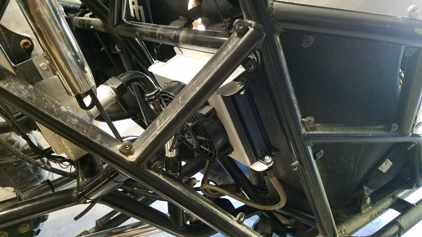

Fwiw, this is my current trans cooler.

How did you fill/bleed your current cooler? With the lines down like that could there be a trapped air pocket reducing your cooling efficiency?
Ummm, I didn't do either of those. But you're right, I could see how air might have a hard time getting out of there. I should look into that.
We'll see, maybe I'll try to snatch it out of there this winter and send it in to them. I actually haven't even gotten it too hot yet, highest was maybe 190° but I'd be happy with a little cooler.
I would not change a thing if 190 is the hottest you have seen. Waste of time.
GM and Ford both have been running factory trans coolers in that orientation for years with no issues. I have replaced them in trucks before after front end collisions and never bled them. Mine is mounted in the same orientation in my rig and my trans has never been over 190°. Never bled it after install. I'm with redneckengineered, if you've never seen anything over 190° keep on keeping on.
