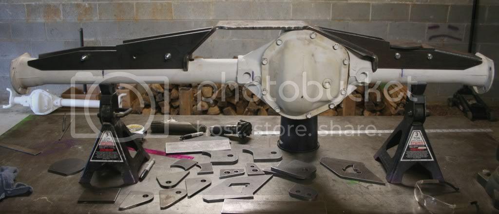

And also any good tips on bracing the front and rear? I have had a tendancy to trophy truck it through the hunting club and on the power lines for no apperent reason and bent one rear housing thinking of a small truss between the perches

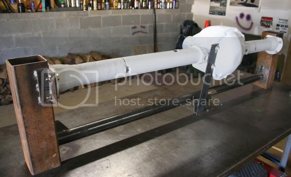

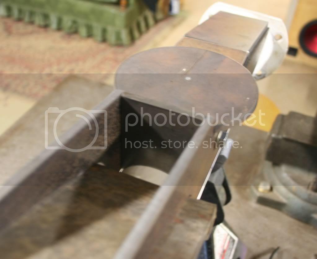

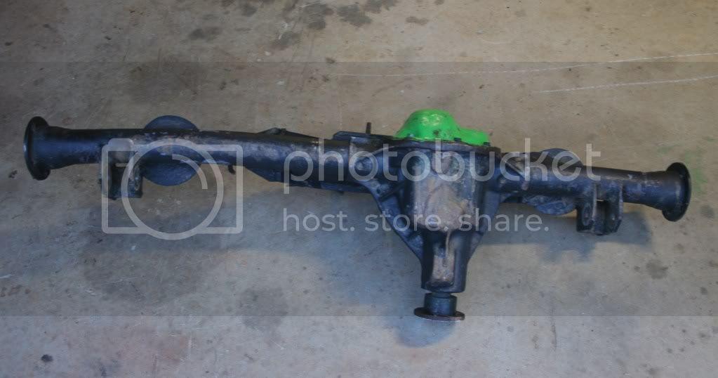

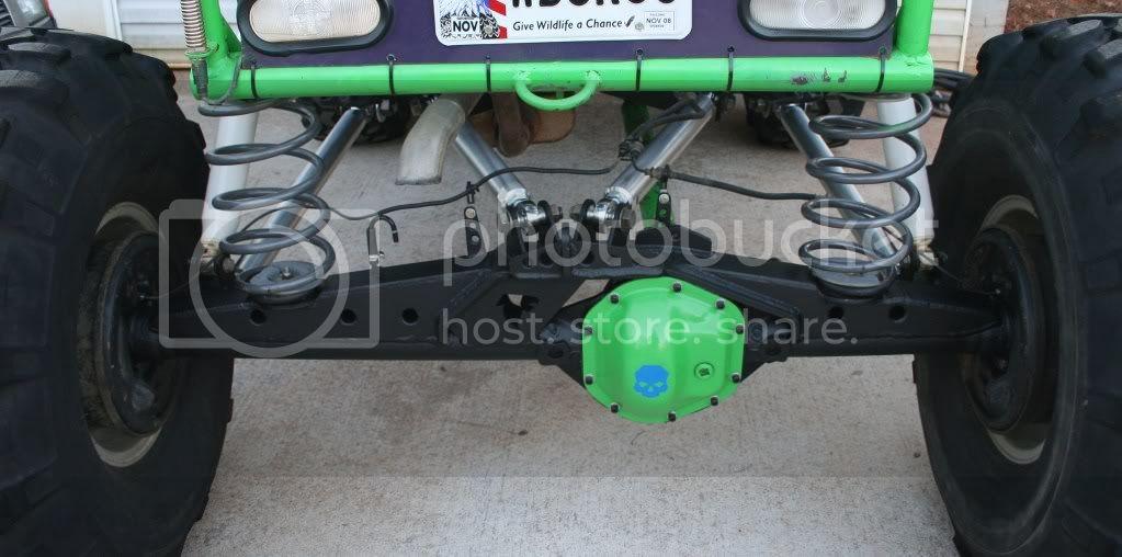

Heres how I did my rear waggy 44 truss, have not 4 linked & trussed my frontend....YET....
The middle "bridge" peice is a 14 bolt truss I ground down & turned around backwards .

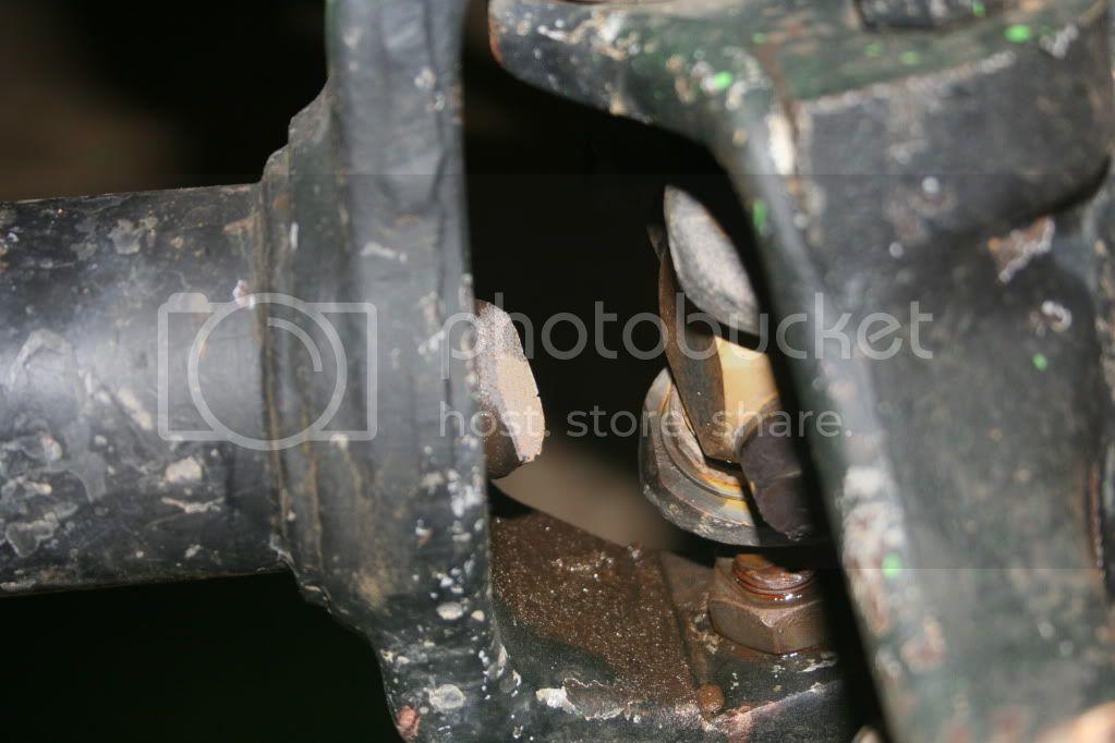

Heres how most of my YUKON shafts broke, SUPER JOINTS are tough though, just get more caps & o-rings & put em back...

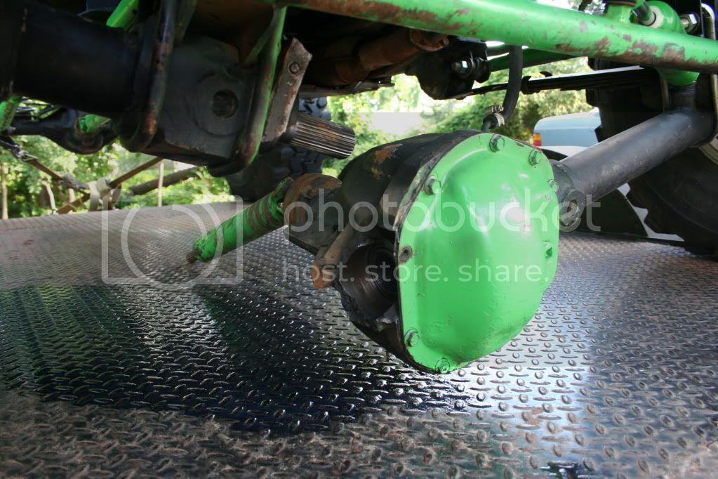

heres a front 44 I broke.........
OH YEA .........that right front axle you see pokin outta that broke off tube is a SUPERIOR SHAFT, it DID NOT break....but it WAS bent and not reuseable :eek:
that would have broke a YUKON into SHARDS :****:

But a STOCK dana 44 housing is not as strong as you would think, ...so far I have broke 1 front in half, 1 rear in half, and bent 1 rear into a non usable state,
good "ear to ear " trussing is the answer though :dblthumb:
