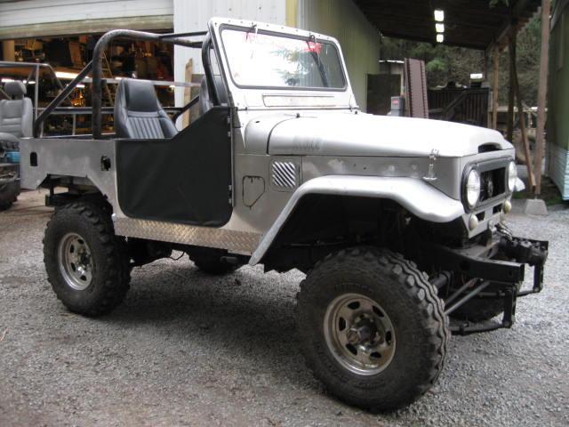

This is my land cruiser.
I got it from TLCruiser66 on the board here. He stored it safely indoors for me for many years.
I am its first American owner. Its was a Canadian rig before then. Never registered in the US until now.

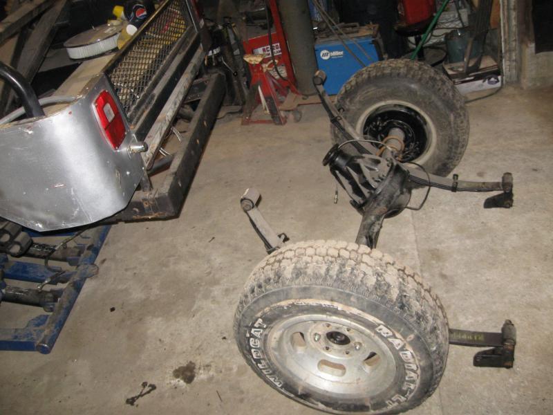

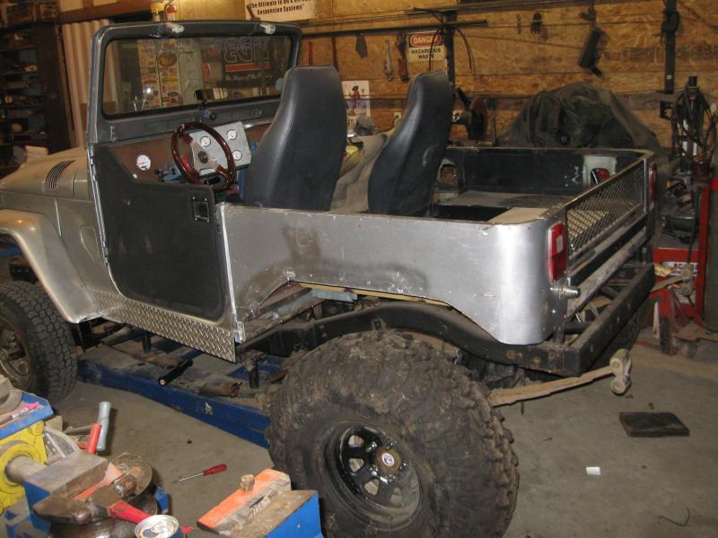

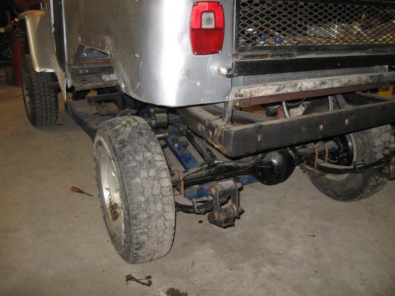

I started by removing the rear axle and springs.
It is going to get a ford 9 inch rear with 4.88s on a spool with chromo 31spline Yukon shafts. Going to be bolted to waggy rear springs and Rancho RS9000s.
Hope to keep this rig light and low.

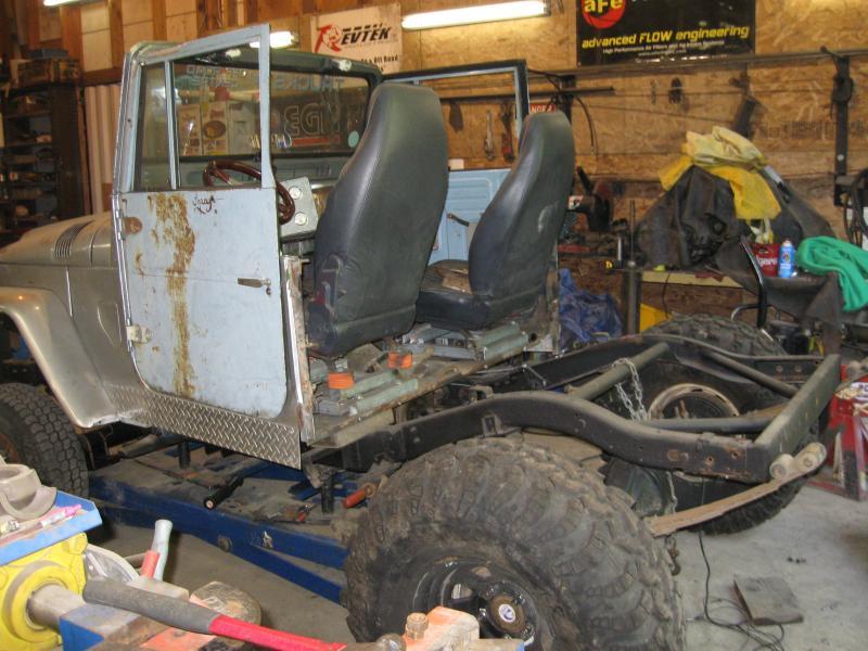

Then I tossed in the rear ford axle and waggys for some reference. It sits nice and low. Perfect.:awesomework:
Tires are gonna be a set of 36x13 iroks and a set of 33 inch paddles. :cool:

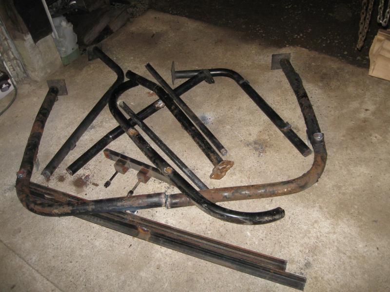

Also removed the cage and broke into pieces by hand so it could never be used again.:eeek:

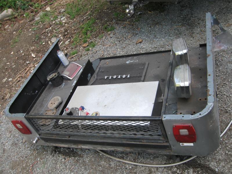

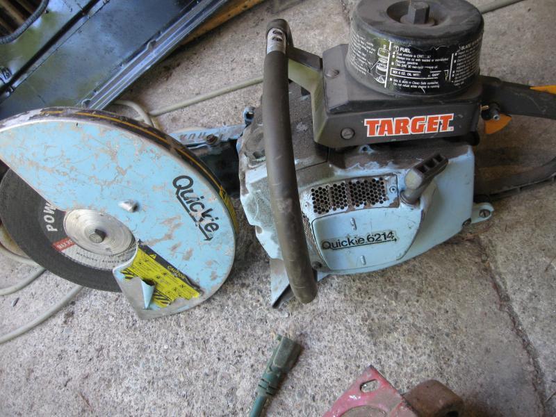

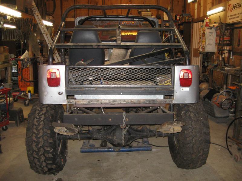

The rear was kinda ugly so I cut it off with my favorite tool. :FIREdevil:

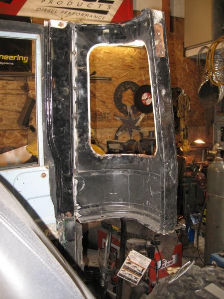

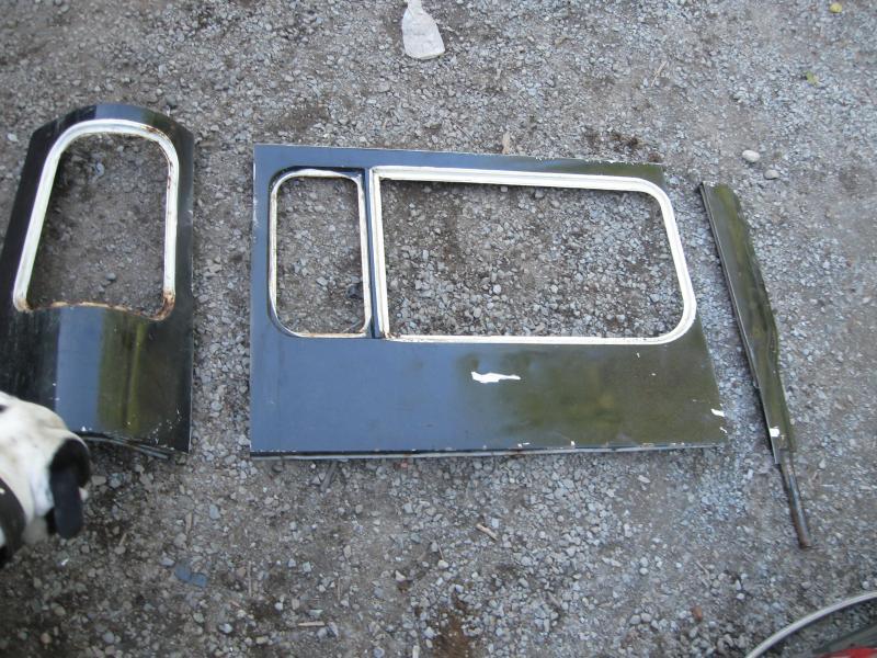

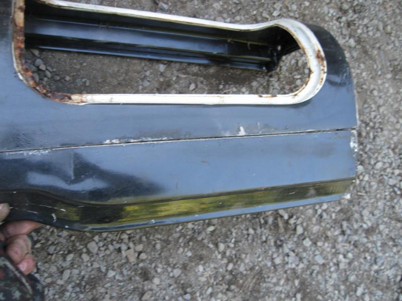

Heres the donor side panels. Goona cut them up and put them back together.

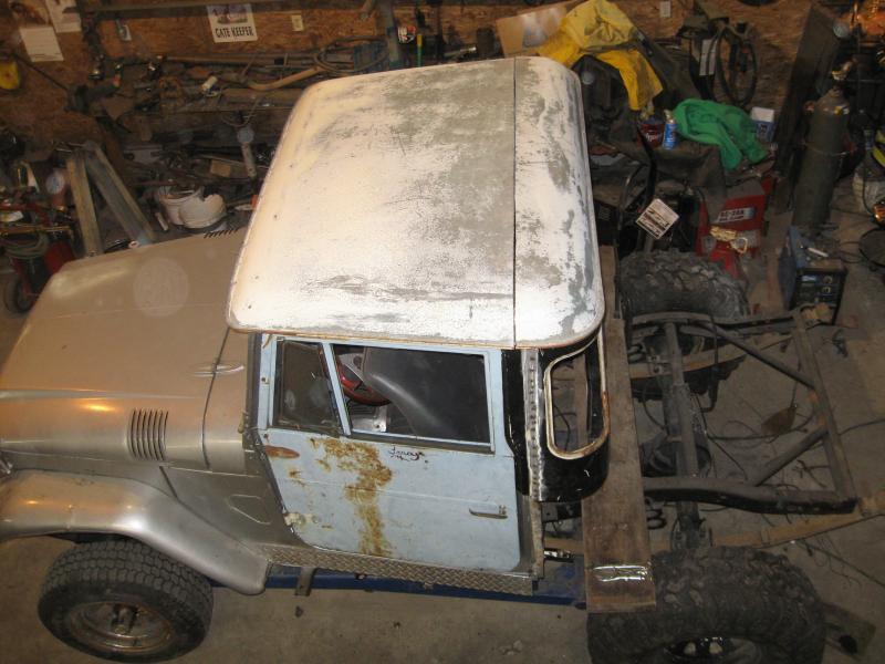

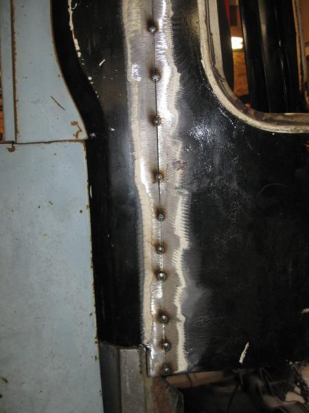

Heres the roof corners all tacked.:awesomework:

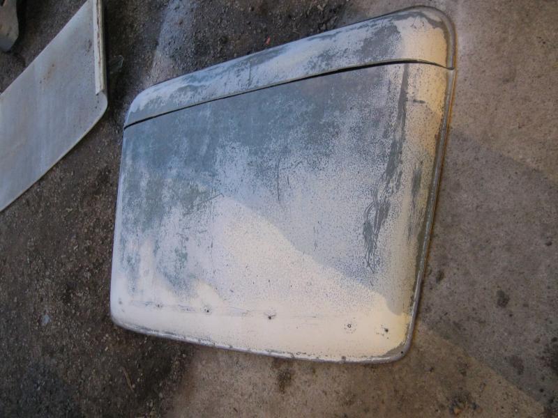

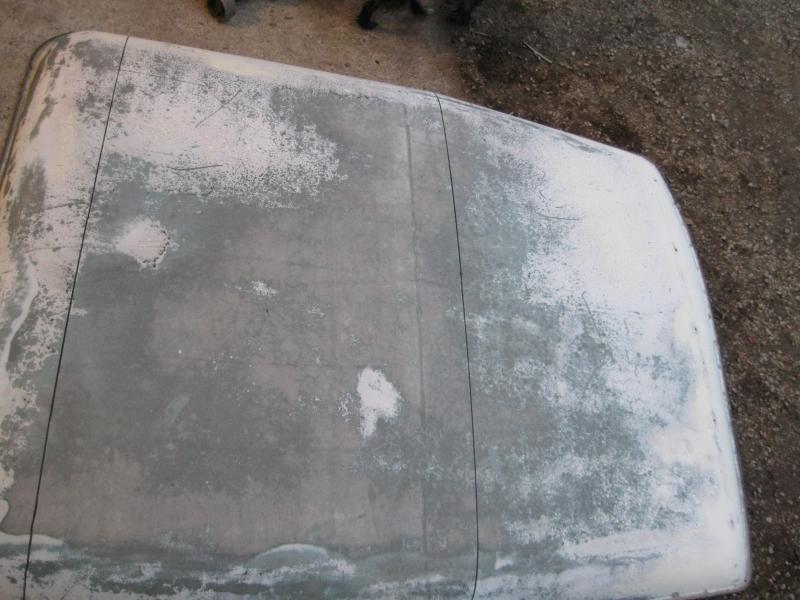

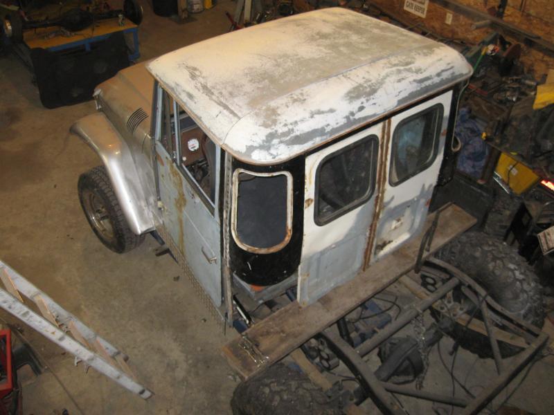

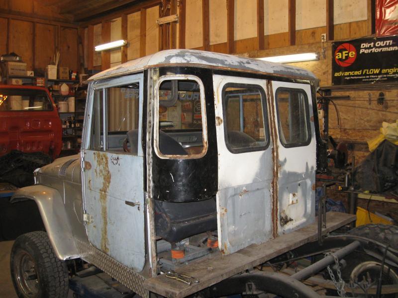

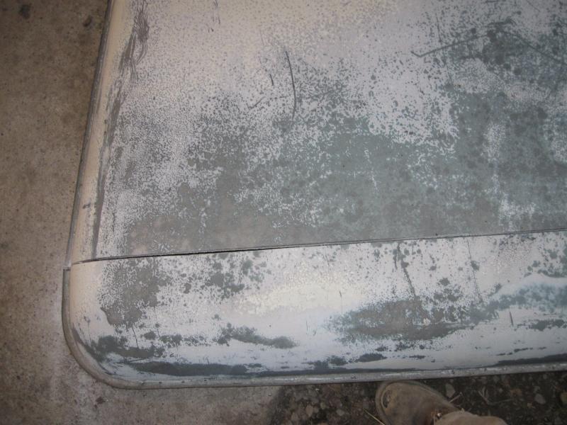

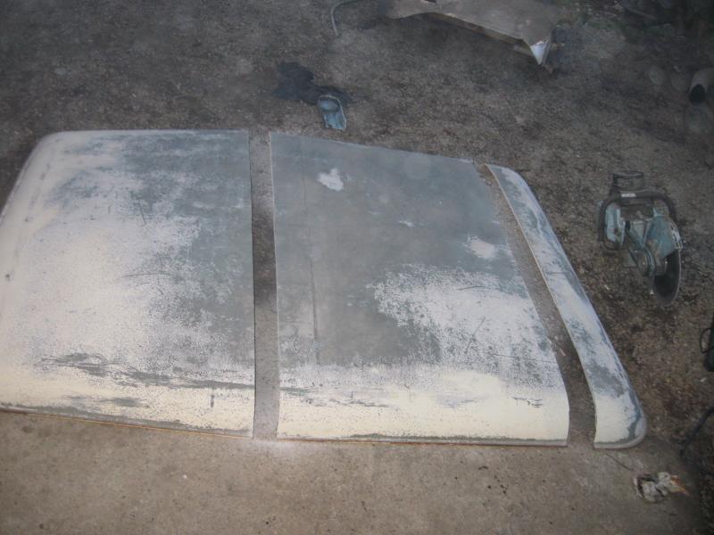

Then I chopped the roof up too.
Then I sit it on for some fitting.

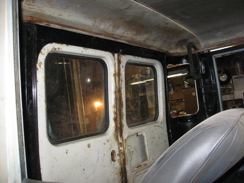

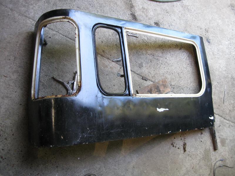

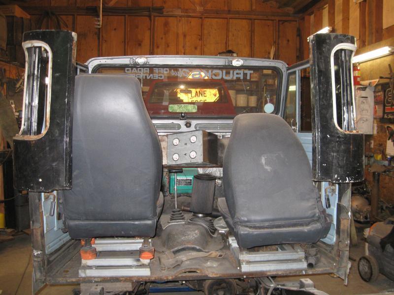

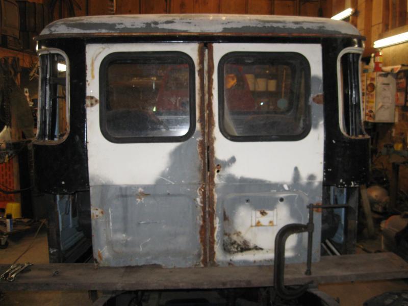

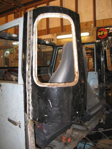

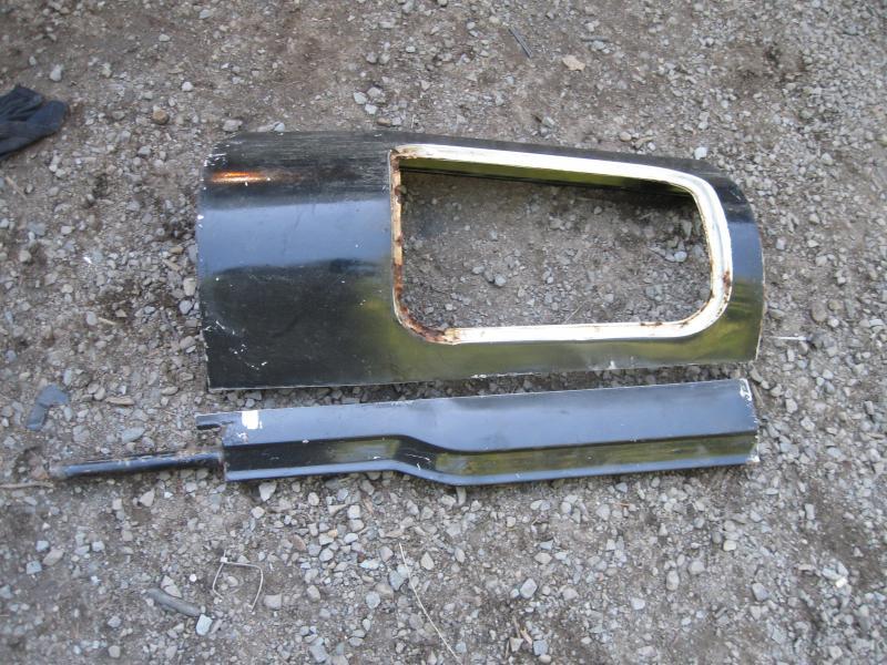

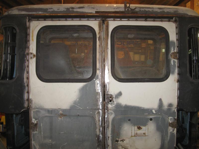

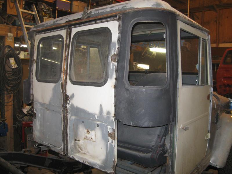

I think Im gonna use these ol FJ40 amberlamps doors to make the rear cab panel and back windows.
Anyone have any more ambulance/barn doors or just the windows?

ssweet looks like those barn doors arent going to be operational...Or are they? :redneck:
Nope. Just want the dual windows. Plus I got them for free cuz someone tried to weld them up at some point and it looked like millions of bbs glued to the edges of the doors. I have a pic of them.

Pretty ****ing slick...
Love the hot saw...:cool:
I'd get myself in all kinds of trouble with that...:redneck:
Thanks. I have to be careful and hold back a little with that saw. :redneck:

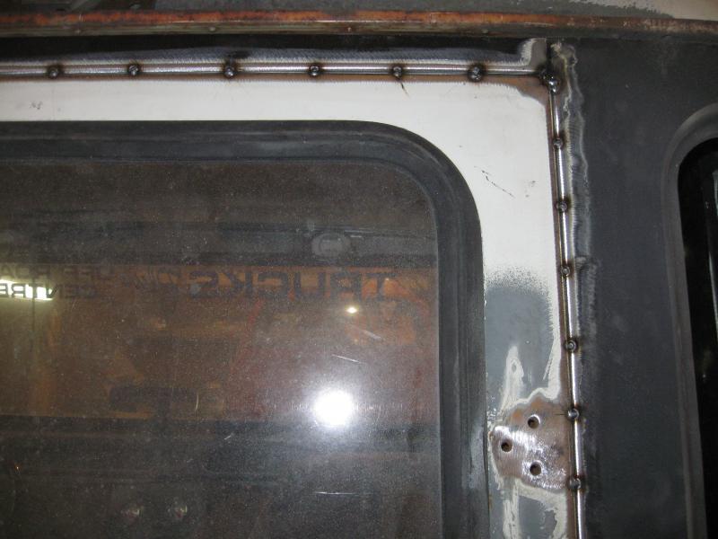

Heres the doors and prep and tacked in.
