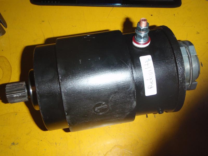

just got my motor rebuilt on winch got it back today:cheer:
$140
