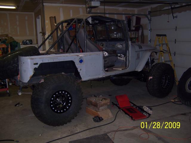

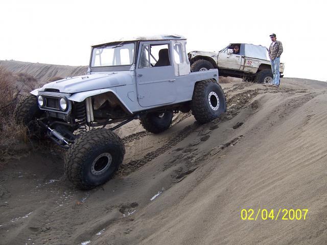

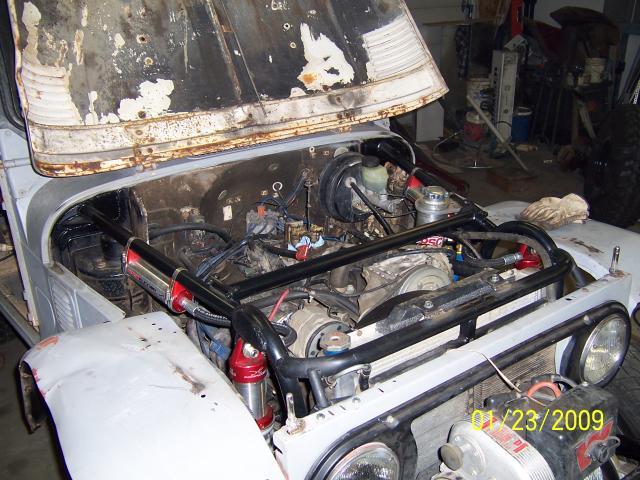

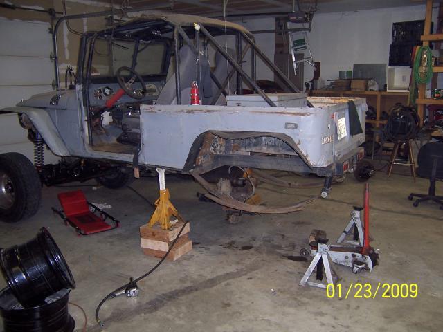

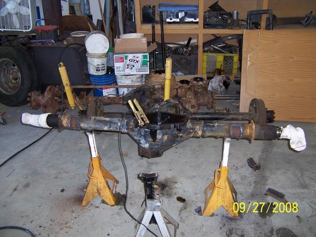

not too many pics but you git the idea.

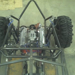

as luck would have it the snow and cold kept me from making money so i stayed home and spent some

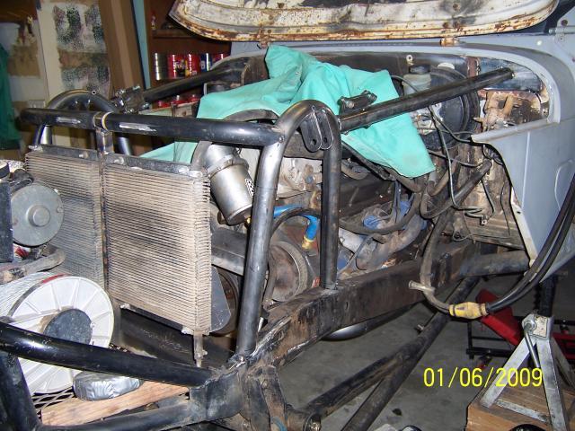

Dam it the bright orb is back. must resist the temptation to go back to work. sunshine = money, Build = poor house damit:mad:

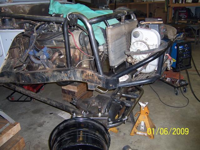

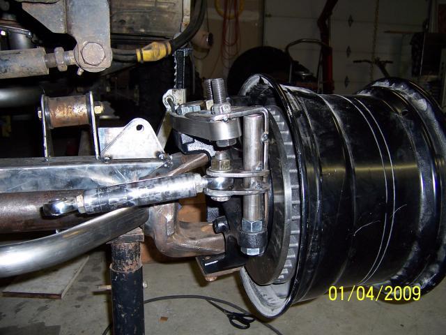

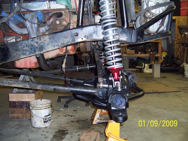

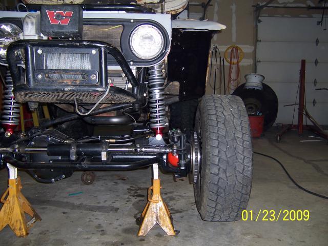

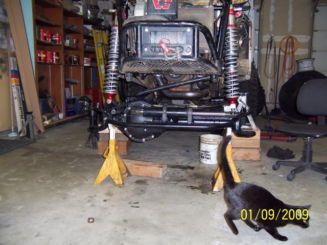

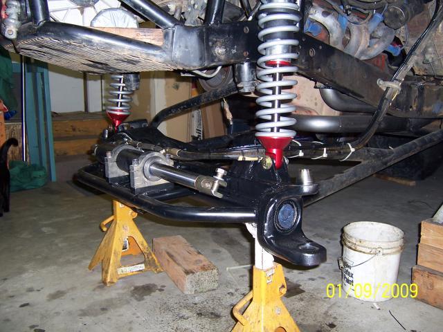

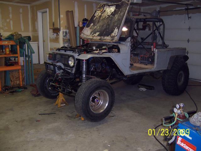

it is ride higth but only temp . ill address that issue and new top mount later.my old front set up was very close to that angle and oddly enugh worked well. no bumpstear with hydro.
Wasn't thinking bump steer with full hydro, just side hilling would be more stable if it was inverted from where it was or at least horizontal if you have room.
i think i have the room it was a patence thing ive been looking at how others have run thairs and it makeing smoke come out my ears.there's allot going on up front
no its not and yep im up for sug. or good pic's of others to copy.
Drop the frame mount side down as low as you can and raise the axle mount side as high as possible, and like mauler says, captivate it in a double shear mount.
Lot's of single seat buggies use a three link with a pan-hard, should be able to find some pics on Pirate.
