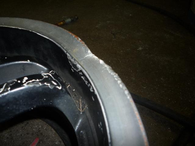

it's cracked on the outer lip, all the way through it, roughly 3/16 thick in that area and roughly 3/4in long, i brought it to a knowledable welder friend and he told me that he has made repairs just like this on more then one occation(SP) and he told me i would be fine to use my spool gun.. so thats what i am going to do, if it works awesome if it fails i guess i will be buying a new rim... shitty thing about that is that they no longer make this rim any more...

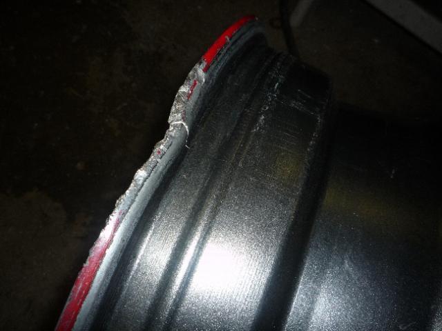

posting picture for James.

My opinion. Dont make a potentially expensive mistake since your cheap. Some where there is a rim like yours for sale.
Even if you do manage to properly fill that crack, there are probably thousands of microcracks around it that you can't see, but will continue to crack when it get's jolted again. Volkswagen, along with a few other carmakers do not "allow" the use of refurbished wheels on their cars. (guideline that insurance companies have to follow in the repair of vehicles.) That being said, I think it would be fine if it had a tire with any kind of sidewall on it, but from the looks of the rim, you probably have low profiles on it? So next time you hit a pothole and the rim explodes, is it going to be worth it? :corn:
yes:awesomework:
This is not the "cracked lip" I was expecting.
I was thinking it was curbed and folded over then pulled back over and straight leaving a crack in the crotch of the bead lip.
That rim was potholed or speed bumped and is JUNK. Repeat, JUNK.:;
the rim runs perfectly straight, i fix'd the flat spot and i am going to attempt to weld on it tonight or tomorrow
that being said i am running low profile tires and from the looks of the red paint on the lip of the rim, my guess is we was drifting in the rain/snow out of control and nailed a curb... well see how it turns out
i am going to use die pen to locate the end of the crack and any other potential cracks that are on the surface
What kind of insurance do you have on your car?
Has anyone ever said "I told you so" to you?
Dont do it, You got too much to loose.
