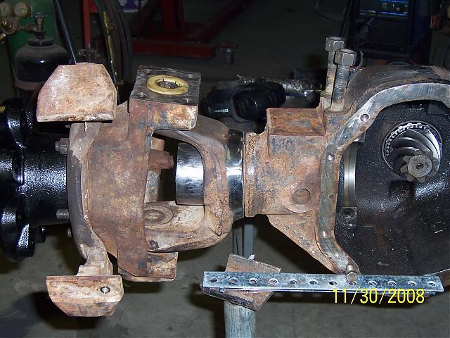

Your caliper is pointing the wrong direction:flipoff: Why not leave just a 1/4" gap? Or put a big bevel on the centersection and end forging if you insist on doing it the hard way.If you were to leave the 1/2" gap you could weld the end forging to the tube normally and just plug weld the centersection to the tube like factory. Would save alot of work.250 degrees is WAY to cold. I have been doing alot of research (books, not the internet) on how to correctly weld to the centersection. To do it "correctly" you would heat everything in an oven at 900 degrees, an hour four every inch of thickness.Then weld with Nickel Rod. You would then slowly cool by putting it back in the oven or insulating.
