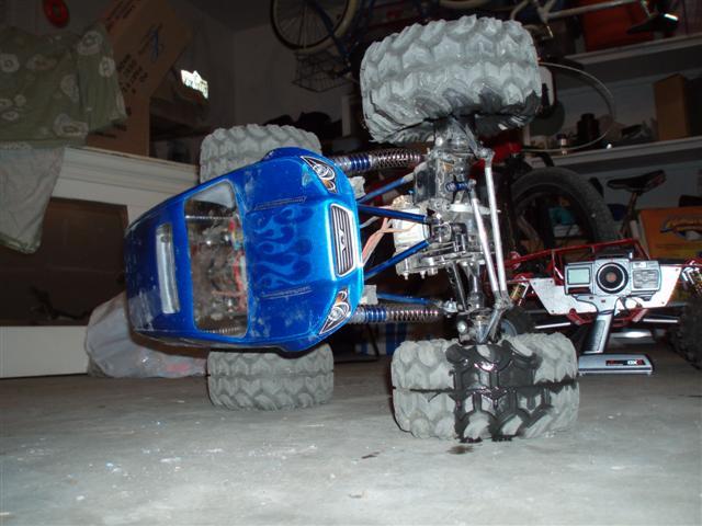

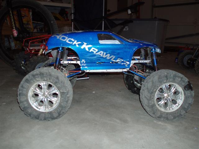

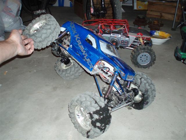

Chassis is 16 7/8 wheelbase(I think I might need to be 17 1/4)
15 inch from outside tire to tire
80 bb's in each front tire. 0 bb's in rear tires
Seems kinda tall(might do some limiting straps)but, It will balance on it's side RTR with Batt installed.( is this impressive?)
Thought I might get some opinions if you guys don't mind since this is the rig I will bring on the 12th. Thanks for any and all comments. JASON

Looks like the front wheel bearings are leaking! :D
Actually it looks like you are on the right track. The only thing is that it seems to be sitting a little high, but you already mentioned that. You might try lowering by some method other than straps, so that when you are at neutral ride height, the suspension can droop when one wheel drops into a hole. Looking forward to seeing a new Super class competitor on the 12th. (It will be my first comp with the big trucks as well).
I wouldnt worry about ride height or COG when it is able to stand on its side, pretty f'n impressive. the body is kinda :rb: though I would put an early bronco body on it.:cheer: :cheer:
