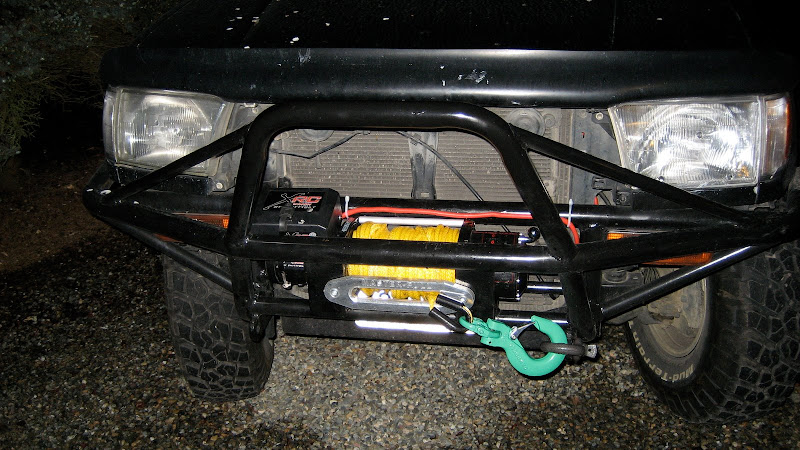

R RusM Well-Known Member Joined Oct 24, 2009 Messages 796 Reaction score 0 Location Oly Apr 13, 2010 #1 Will a hook/connector that is rated for overhead lifting WLL of 8800# be safe to use with my 8000# winch?

crazybluerider1 Well-Known Member Joined Sep 6, 2007 Messages 894 Reaction score 0 Location Portland Apr 13, 2010 #2 I would say yes. Because things that are rated for both usually are rated for less in overhead lift.

R RusM Well-Known Member Joined Oct 24, 2009 Messages 796 Reaction score 0 Location Oly Apr 13, 2010 #4 Money Mark said: What are you using it for? What are you lifting? Click to expand... A hook for the end of my winchline. Just winching out the truck an other trucks when they get stuck, hopefully there is no lifting!

ain'tstuckjustresting RIP Mister 12/5/12 Joined Jan 18, 2009 Messages 3,102 Reaction score 0 Location Spanacompton Apr 13, 2010 #5 Yep, most import winches your lucky to get a Grade 43 hook in the box while I believe Warn ships G70 hooks which is the same as legal tiedown chains. All hooks legal for overhead must be G80 or better. Your good man:awesomework:

8 86tuning Well-Known Member Joined Nov 9, 2007 Messages 84 Reaction score 0 Location Vancouver BC Apr 15, 2010 #6 crazybluerider said: I would say yes. Because things that are rated for both usually are rated for less in overhead lift. Click to expand... True. If it's rated for overhead lifting, it is more than adequate for winching.

R RusM Well-Known Member Joined Oct 24, 2009 Messages 796 Reaction score 0 Location Oly Apr 18, 2010 #7 I think it will be able to hold up to any load I can put on it!
2 2slow4you Well-Known Member Joined Oct 4, 2007 Messages 1,360 Reaction score 0 Apr 18, 2010 #8 Other then the puke green uke: and no grill I would say it's looking good Rus. You coming to the May 1st shakedown run?
