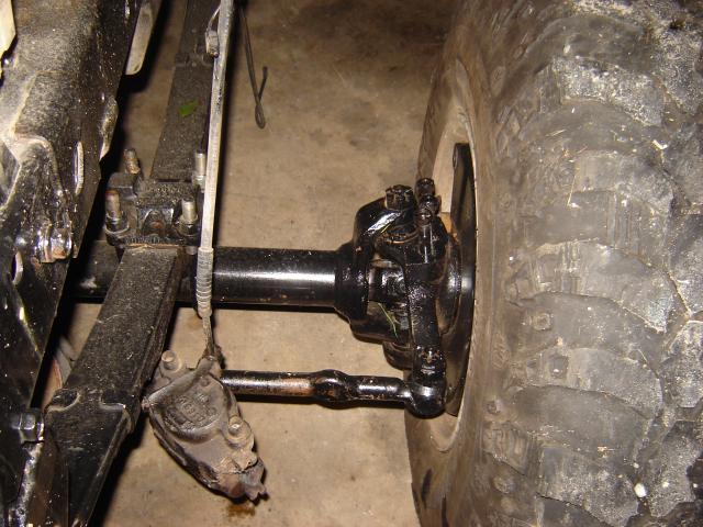

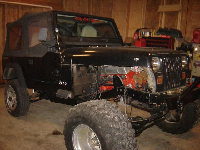

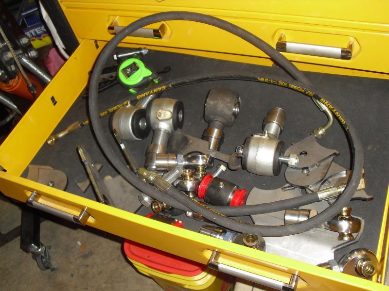

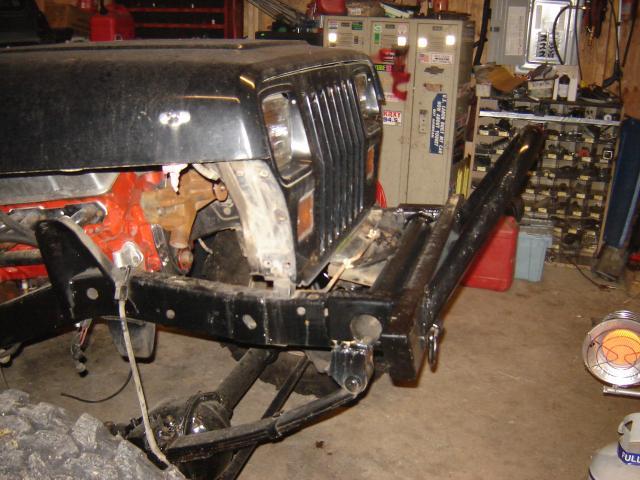

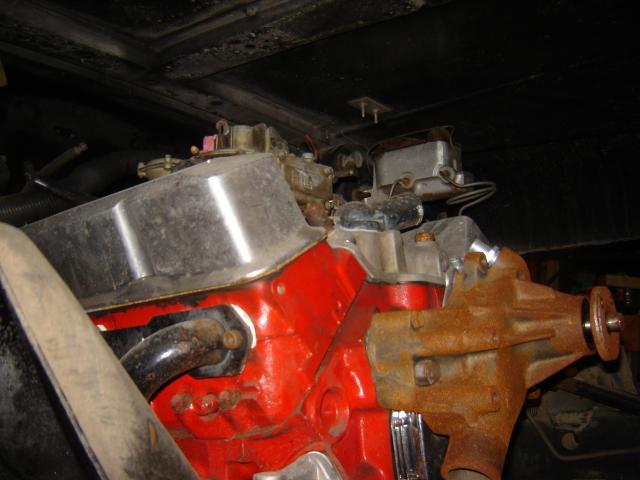

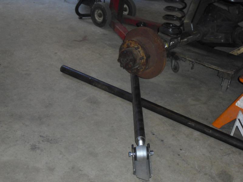

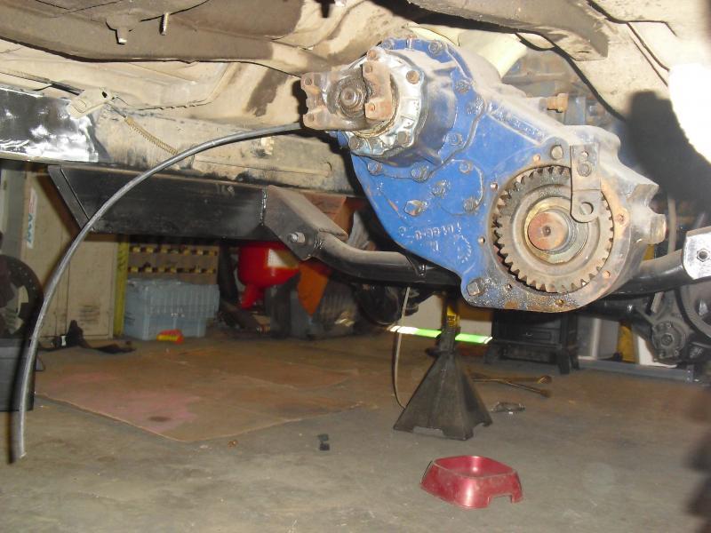

Any body got any steering tricks for this d chevy 44 setup highsteer which is best or least expensive or if hydro steering is the best bet

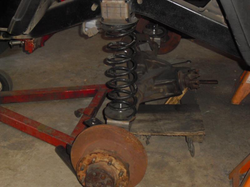

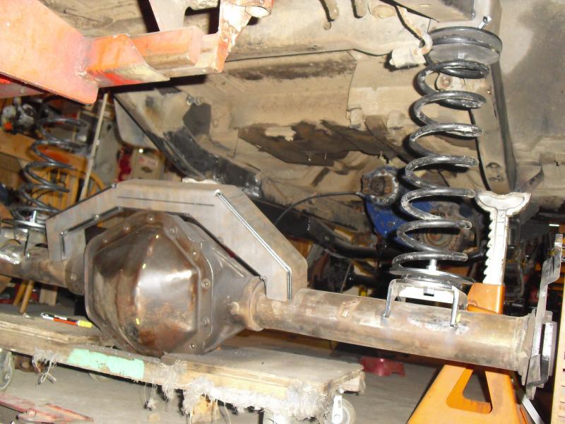

update as of today
been full throttle on this piecer last few days:cool: HUH

Looks good man. Are you looking to go full hydro or just hydro assist? My cj I'm building (SEE Jay Slevin) Im gonna keep it street so for now I machined, drilled, and tapped the passenger side knuck for a high steer arm. So for now I can run cross over steering to get my drag link like this --- and not like this /. Eventually I'll go full hi steer for better clearance and Hydro assist to take some of the grunt work off my steering box. I have succsessfuly drilled and tapped ports for my steering boxes in past builds so it can be fairly inexpensive to do. I don't know much about full hydro but I do know you'll want an orbital steering valve that will return to center so you can go faster than 25 mph without putting it in a ditch.
