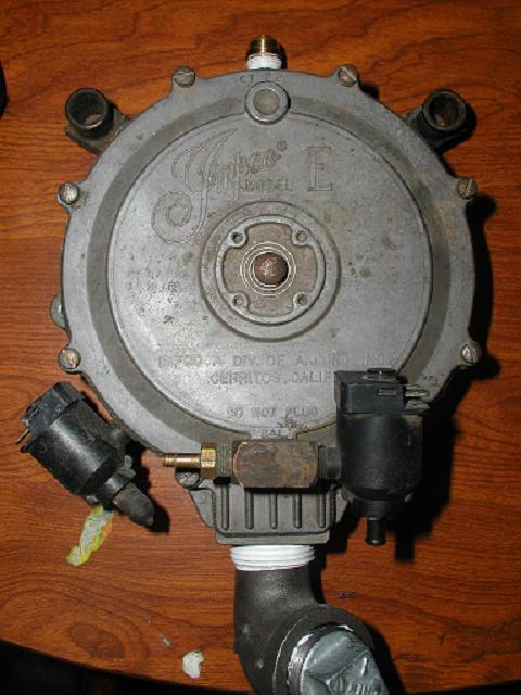

Here's a picture, not the best angle but you get the point. One of these is coming off the front and the other comes off the side.

ok, what you have is a electric prime on the side of the regulator with the two spades. remove piece and plug off. not needed i'm sure in your application. the piece on the front is a feedback solenoid also probably not needed in your application. remove and install a pipe plug with a fitting and connect a hose to it and run it to your air cleaner. it has to be open to the atmosphere to properly operate. now, that brings up another problem. if this system was used in a feedback system the mixer will be stamped with FB and some numbers. if so then it probably has a rich cone in the mixer instead of a standard cone. it will run like troy's for sure and won't be right.:D :corn:

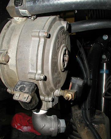

The piece of the side of the vaporizer came plugged. So I'm thinking you're correct about removing it putting in a plug. What does the feedback solenoid do? The port is marked BAI? I tried applying 12V to it and it appears to open up? I also looked all over and no where on do I see FB stamped on it. Here's a better picture too.

a feedback solenoid opens and closes applying vacuum to the topside of the regulator shutting off fuel. a computer monitors the exhaust stream o2 making changes to the air/fuel ratio through the feedback solenoid. as i said remove and discard. since the filter screen has been removed to allow this fitting you need to install something to keep debris out. the port is marked BAL instead of BAI. which is a balance port. the FB would be stamped on the mixer not the regulator. it very well might not be stamped. this may not have been a complete system off a running vehicle. which brings me to another point. i would always rec. purchasing from a reputable rebuilder or brand new. i would'nt fall for the cheap e-bay stuff as you never know what your getting. if the system came off a running vehicle and ran great why take it off and sell it?:rolleyes:
