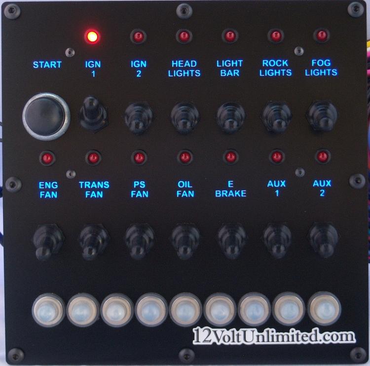

I have used these twice, super simple because they come already assembled and wired!

12voltunlimited.com
is another choice similar to 12voltguy. I had a winch switch panel from him and loved the backlit led feature. You can do rockers, toggles, fuses, circuit breakers, choice of backlit color. All kinds of stuff.

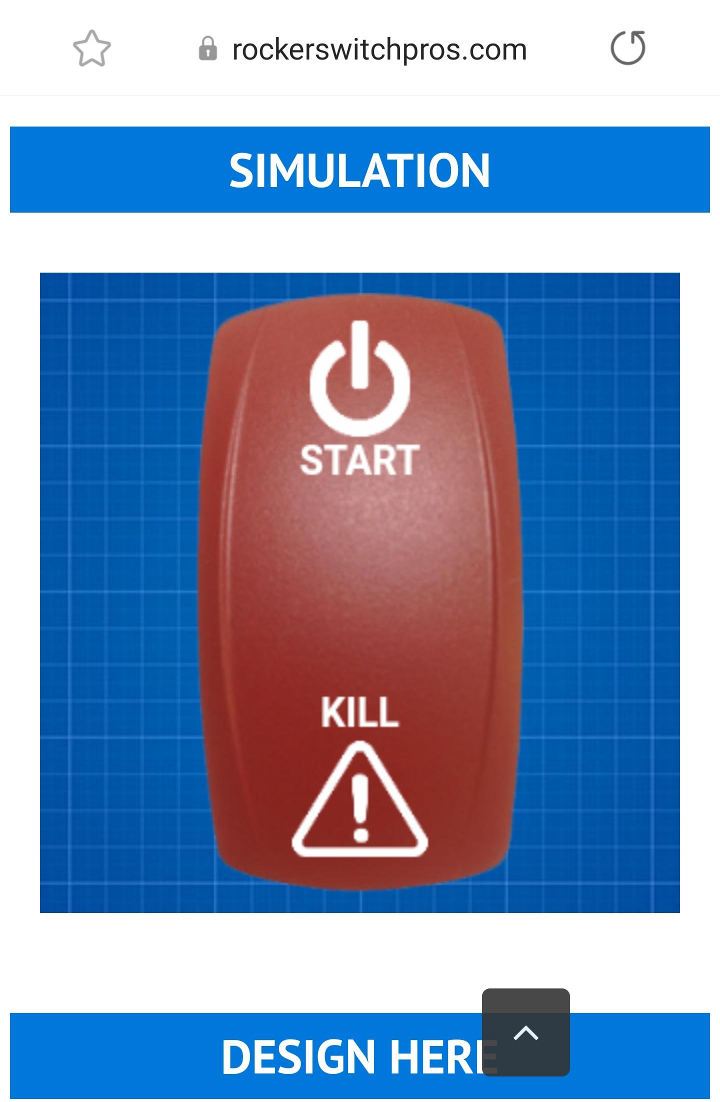

After once fumbling for the toggle kill switch in an emergency situation I knew I had to make a change. My solution..... a custom double throw rocker that provides both start & kill within easy slapping reach right next to shifter. When pushed forward it lights up & energizes my backlit start button (and everything else), and to KILL its just a simple slap. Easy to see day or night and simple.

After once fumbling for the toggle kill switch in an emergency situation I knew I had to make a change. My solution..... a custom double throw rocker that provides both start & kill within easy slapping reach right next to shifter. When pushed forward it lights up & energizes my backlit start button (and everything else), and to KILL its just a simple slap. Easy to see day or night and simple.View attachment 121861
I do not like this solution at all.
Wire a proper main kill switch, that's what you should use in case of emergency.
With your solution, if the emergency is real and you're panicking (or in a rollover) there is no way you will for sure hit the switch the right way. On the other hand, the proper kill switches will be spring loaded and return to the open circuit position on their own as soon as you touch them.
What's a proper kill switch?
(besides a tether switch like on boats/pwc/trials bikes)
because what Waffle is describing is an on/off 2 pos switch. IMO it should say "RUN/KILL" or just "ON/OFF" instead of "START/KILL" (because it's not a starter switch)
