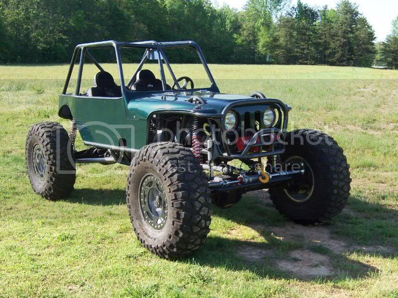

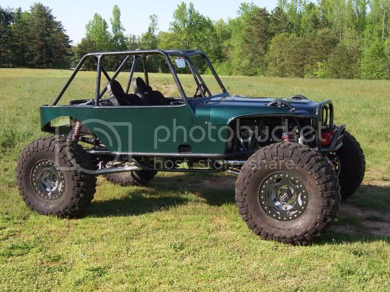

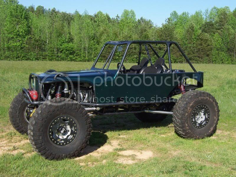

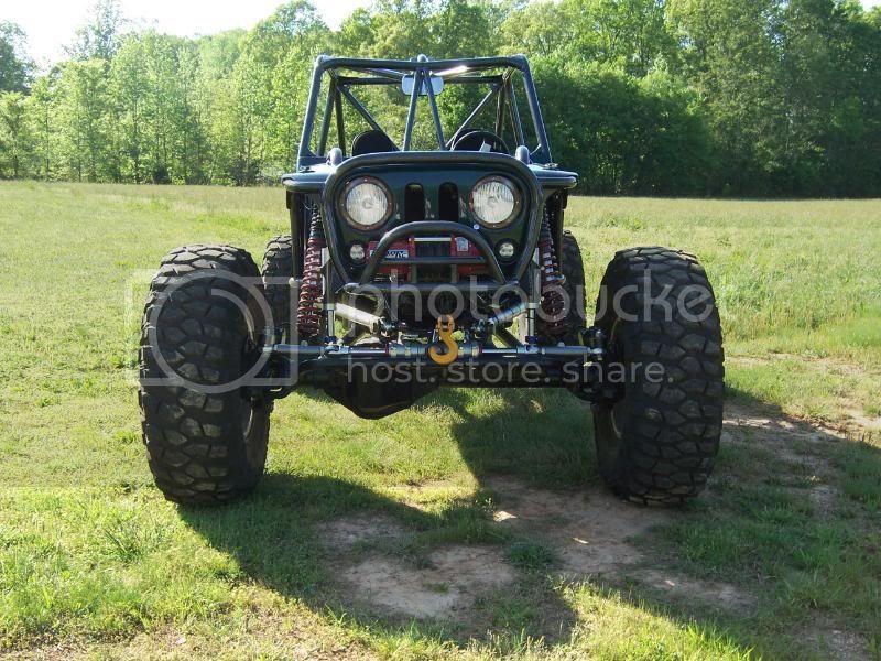

J.A.B said:
I lust the cooling system in that thing drool
x2 having enough cooling to be able to sit and romp and not worry about it is awesome
get that thing outside in some sun so we can see all the pimpin in that paint!!! :woot: :woot:
Damn that rig looks great...I am happy for you Cole. All respect to Jim again. Great job..... :dblthumb:

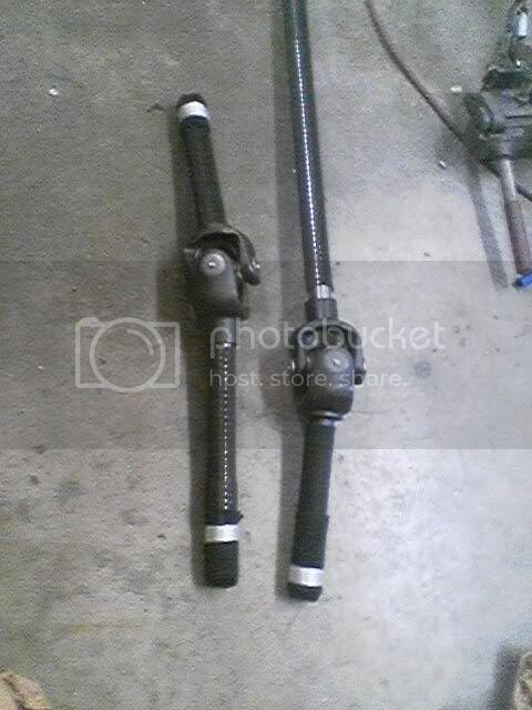

What output shaft and adapter did you use to mate the Atlas and TH400? This looks like a really short combo
http://s199.photobucket.com/albums/aa164/jimsgarage/Number%2013/?action=view&current=100_5829.jpg
It is short, and a POS. AFAIK it is a t400 with the shortest output shaft that would go in front of a 203. It is very hard to get the studs in it, had to grind down several of them because they hit the trans case, had the tcase in/out 6-7 times, and it only mounts with 2 3/8 bolts, instead of 7/16 or 1/2. I put an atlas support ring on it as well.
http://advanceadapters.com/product/2327/%28P/N-AS-6401%29-T400-ATLAS-ADAPTER-1.25%22.html
If you use a longer output, from a 208 or from a 205/2wd t400, it will use a longer adapter.
