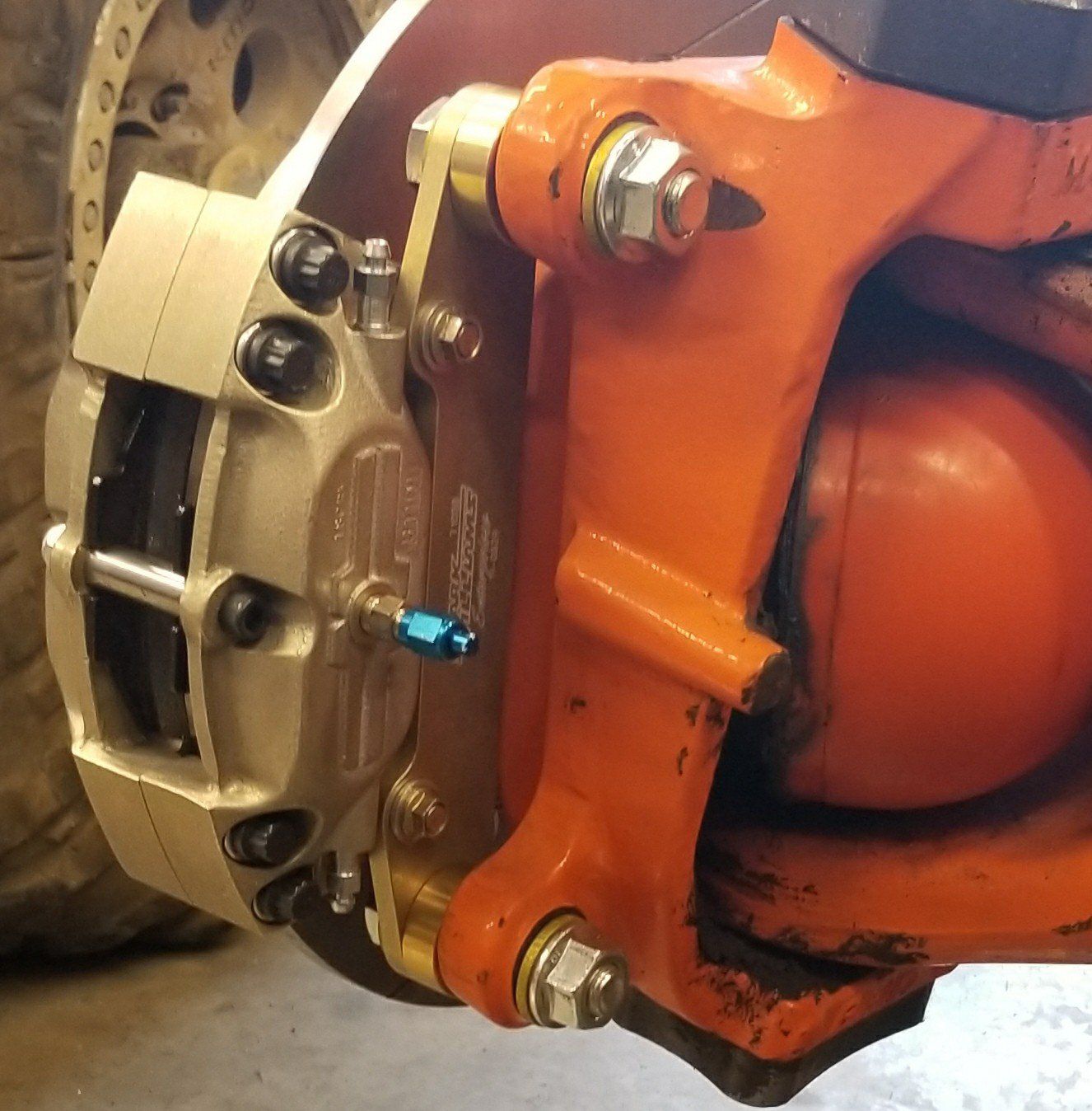

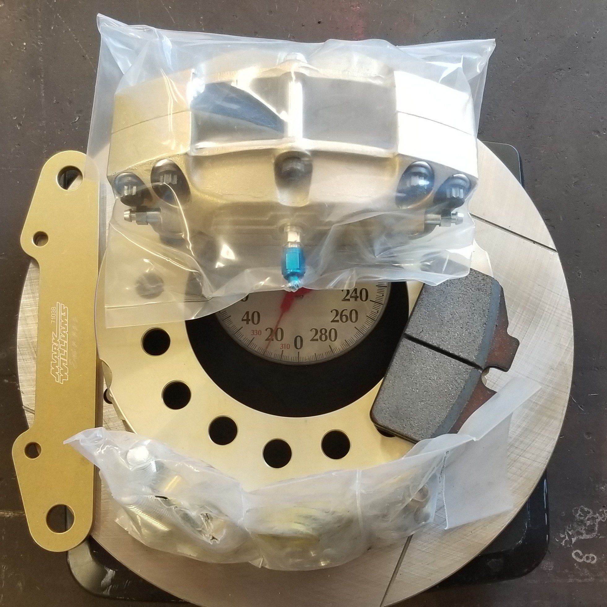

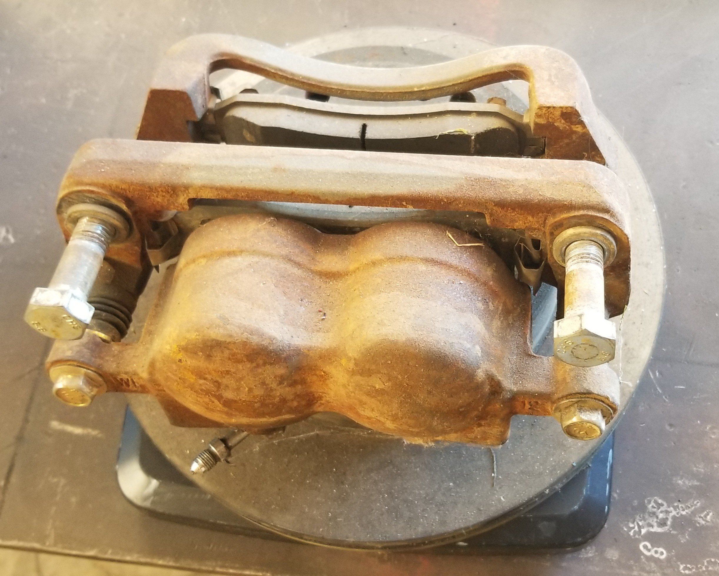

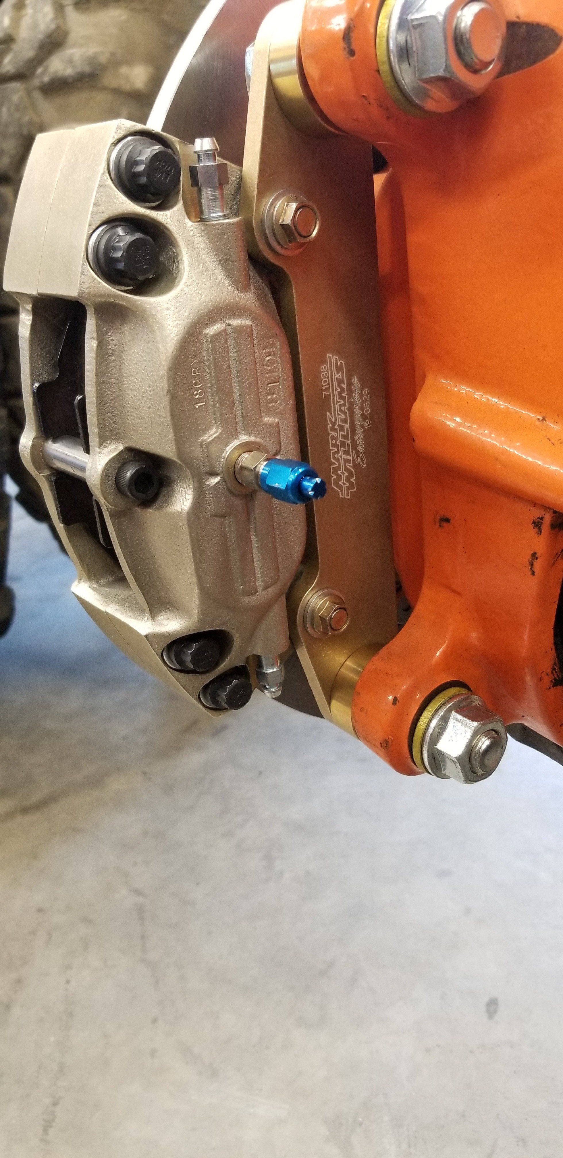

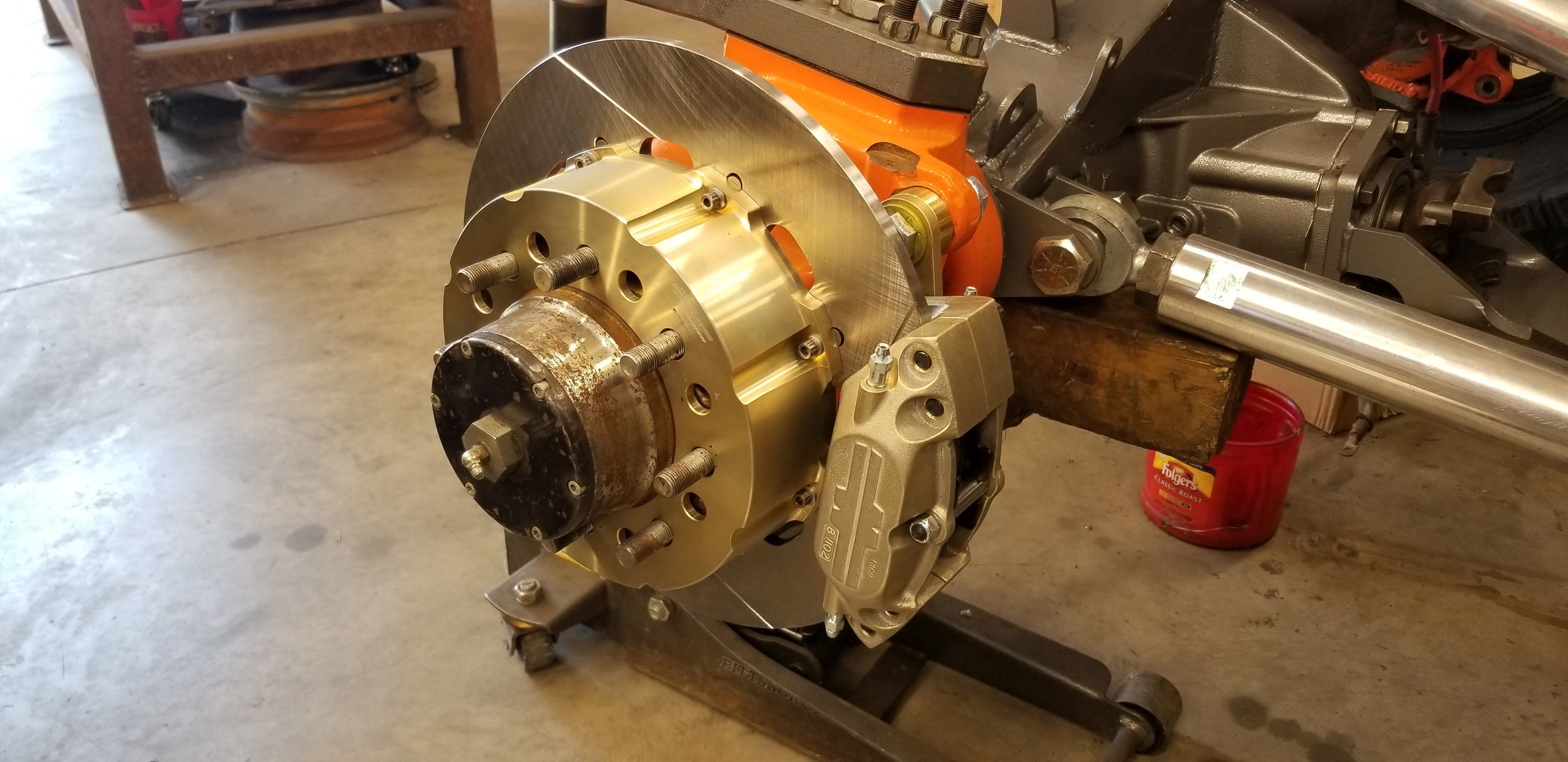

Wizzo on the board has been working on these brakes in conjunction with Mark Williams for months and they are a game changer. 40lb savings per side. Complete kit down to the brackets, washers, bolts, etc, all made in the USA by Mark Williams. No more piecing together kits from multiple manufacturers. Hit up Wizzo on the board for more details/pricing or email ([email protected]). And if you do Facespace or Instabook give Diddy's Big Block Race Shop a follow.
Kit pictured will fit the Reid Super Kingpin knuckles and Ford 05+ 250/350 factory knuckles. More applications in the pipeline!

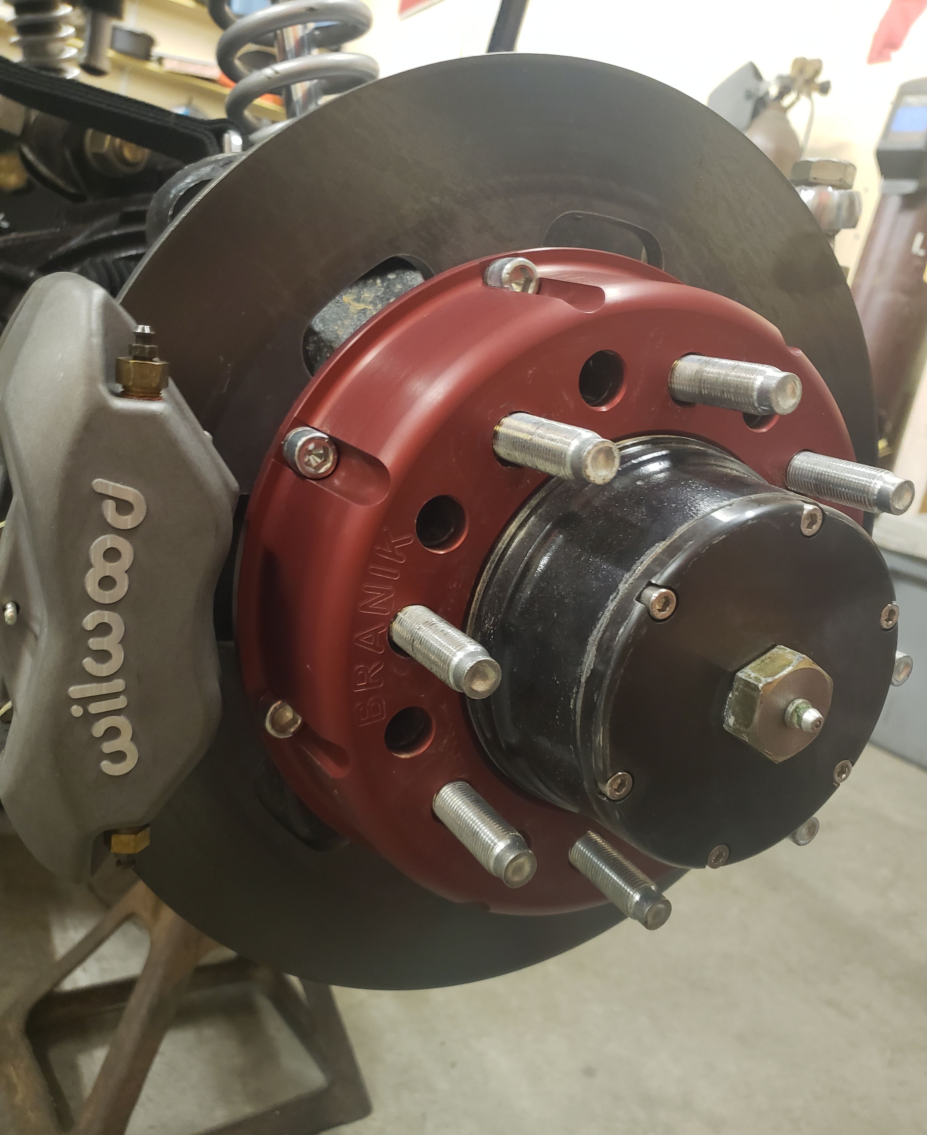

Here are the brakes on my axle. I built this axle very similar to Redneckengineereds axle, minus some of the high end parts. This is a good thread to go by when building a ub 14b front.
These brakes are not the Mark William's but they work very good for me.

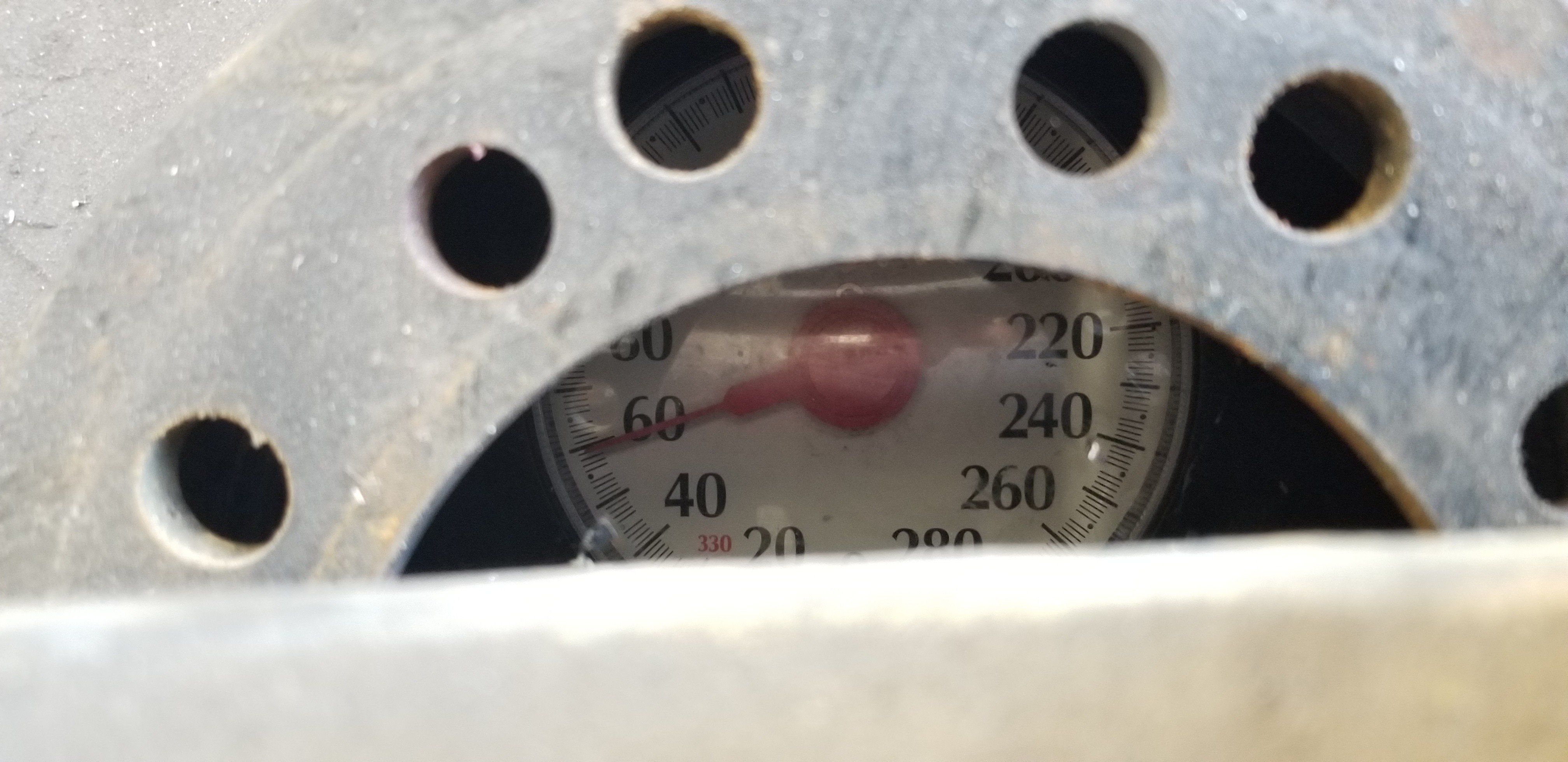

Did you use factory Super Duty Knuckles/Cs?
Did you happen to weigh your setup?
