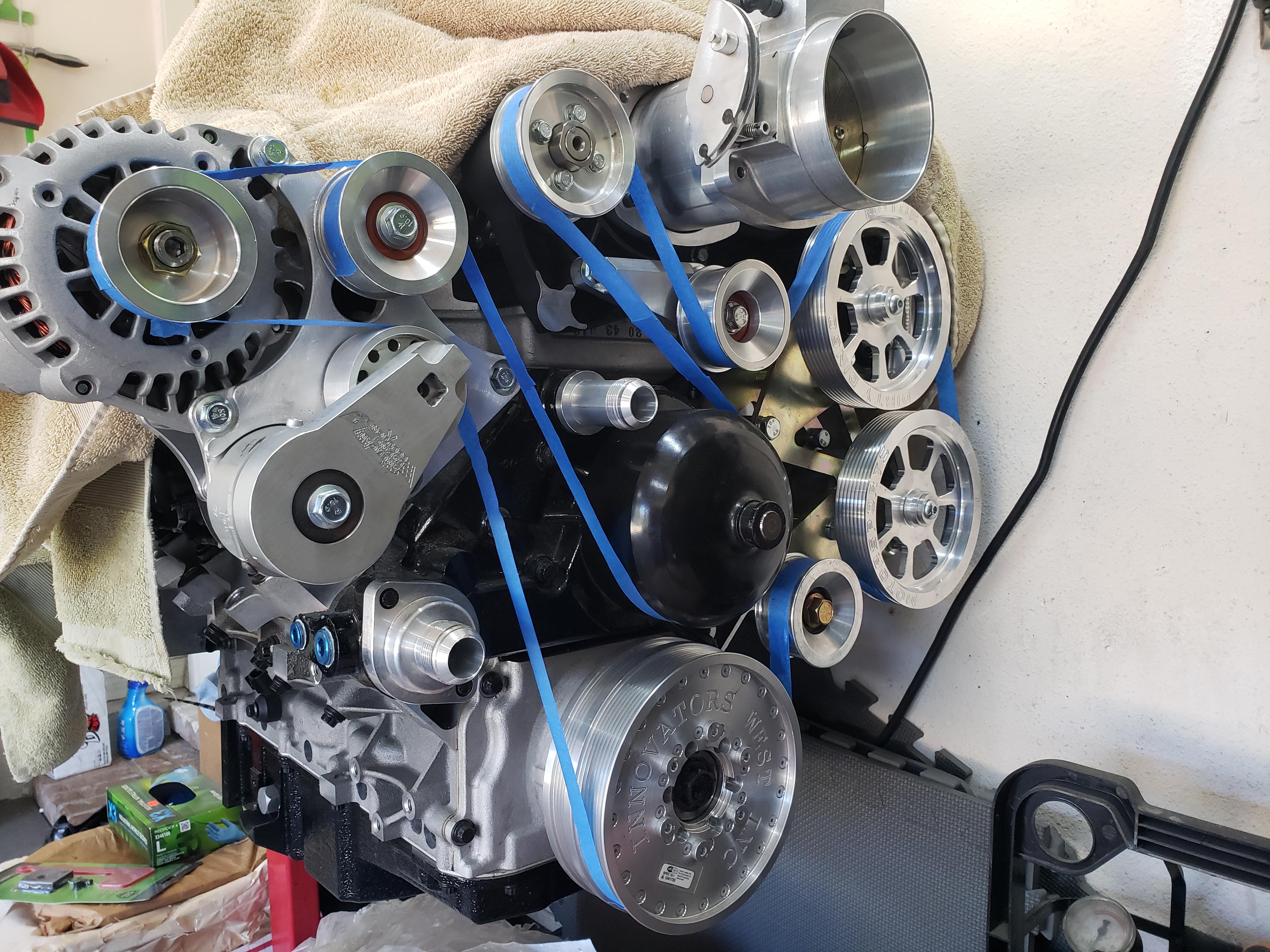

Any one seen a dual p pump setup on an ls? I know they are bulky but I have a few spares and factory truck brackets I could slap together
Took me a while to find it, but there is one company making some brackets :
I think they're the only ones.
I have the goatbuilt brackets posted by @EddieHall but they are for CBR/TC type pumps.
Thanks EddieHall they made the trip up the Canada and look great.

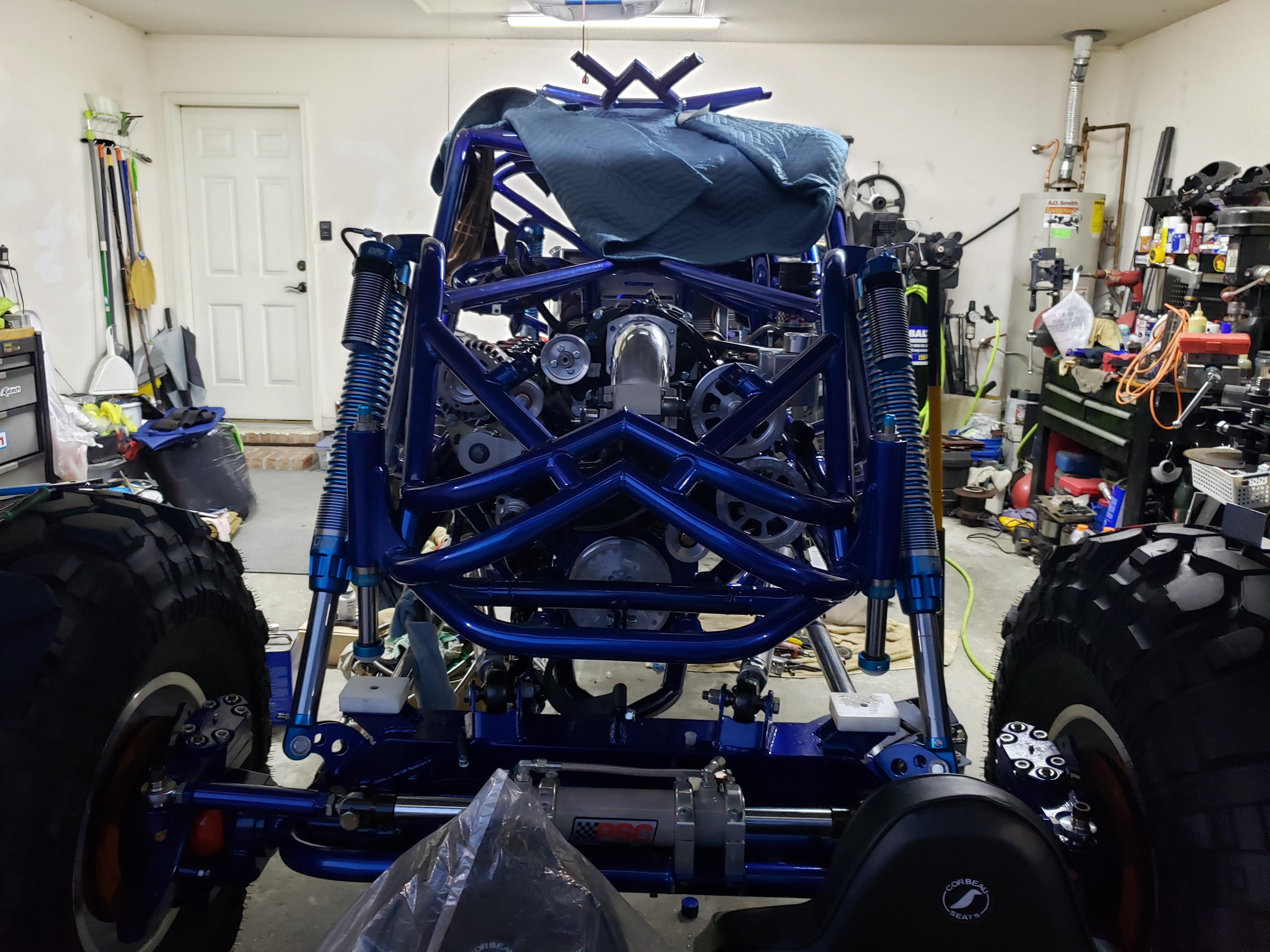

So my plan was to run equal length inners and that would put the pinion offset about 5".
Some how I missed the carrier offset in the 14 bolt. Unlike a 60 where the spline depth is the same on both sides of the carrier the 14 bolt has around a 2" difference.
so I'm bailing on the housing I've put about 5 pounds of wire into.
can any one give me some 14 bolt front measurements with stock 60 front shafts.
Like how far from center is your pinion and what stock length 60 shafts your running.
