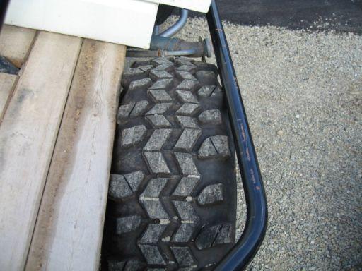

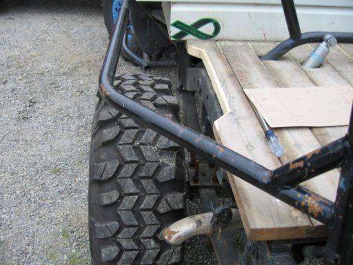

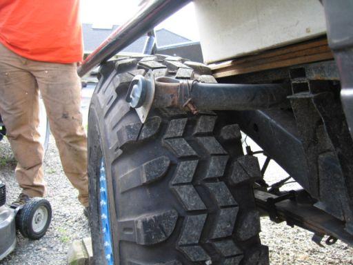

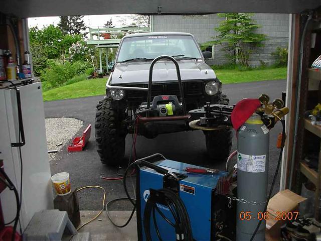

rubbin tough on the fender/firewall, and the flatbed/decking. so i hacked my fenders s'more, gonna tub my firewall, notch the decking for the tire, then if i have time before naches i will move the rear fender tube up. and then also going to 90* my gas filler into the tool box so you have to unlock and lift the box to get at the gas filler.

also got some tube coming this week. my priorities for memorial weekend are finishing the front bumper and fender armor, gettin the winch wired up as well as the 6.5" infinitys and the 10" JL bump bump. tubbing the firewall, and if i have time after that i will maybe do some more tube work. i had to eliminate the hood latch support bracket due to the winch sitting so far back, so i ordered up a set of hood pins. if they are here tomorrow i will get those done and start into tubbing the firewall.

thank you. is 27" under the front tire good? i dont know what kind of articulation people are getting out of leaf sprung rigs. i think it will do over 30 once i get the firewall tubbed and the decking in the back cut, because both the front and rear still have more to go, it's just getting held up by rubbing issues.

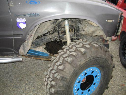

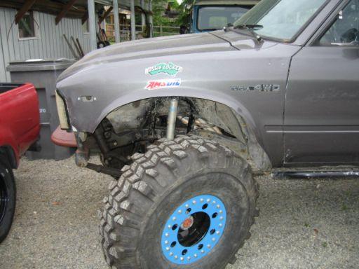

got the fenders cut more, did some woood work. figured about where im going to plasma the firewall to tub it, and started working on getting my speakers mounted in.

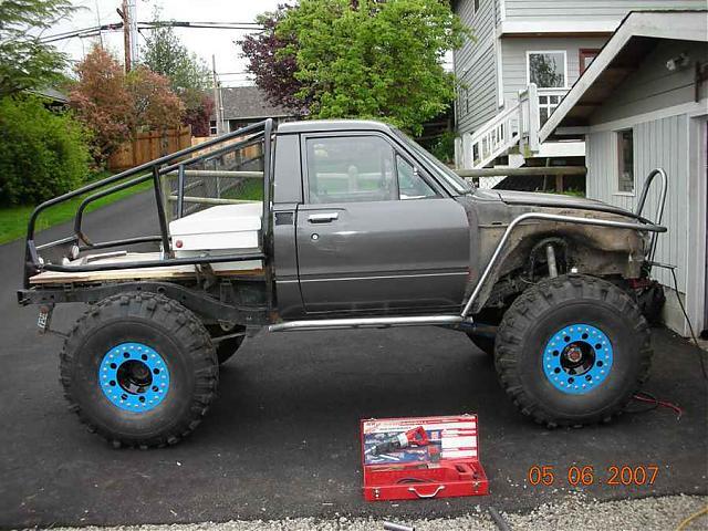

started on the exo today. got the stinger tacked on and the two fender bars bent up and tacked to the stinger. hopefully tomorrow we will get the roof and the a-pillars done. chevyxj should be posting up some pics.. and i plan on running fenders over the new tube. ill need to notch the fenders for the fender tube and punch the a pillar through it. ill post more pictures tomorrow.
A few pics of the start of the cage for now
