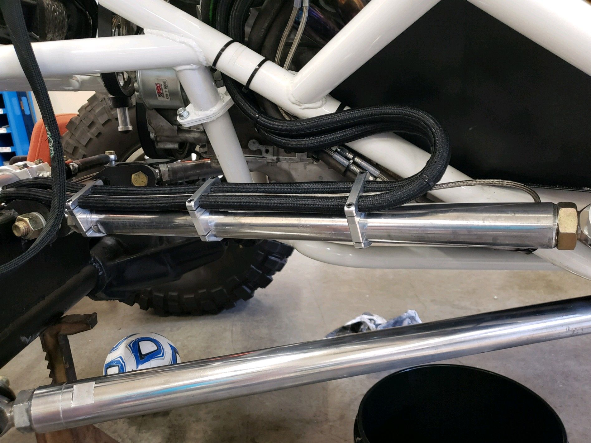

AJK Offroad Clamps
Re: 2.0

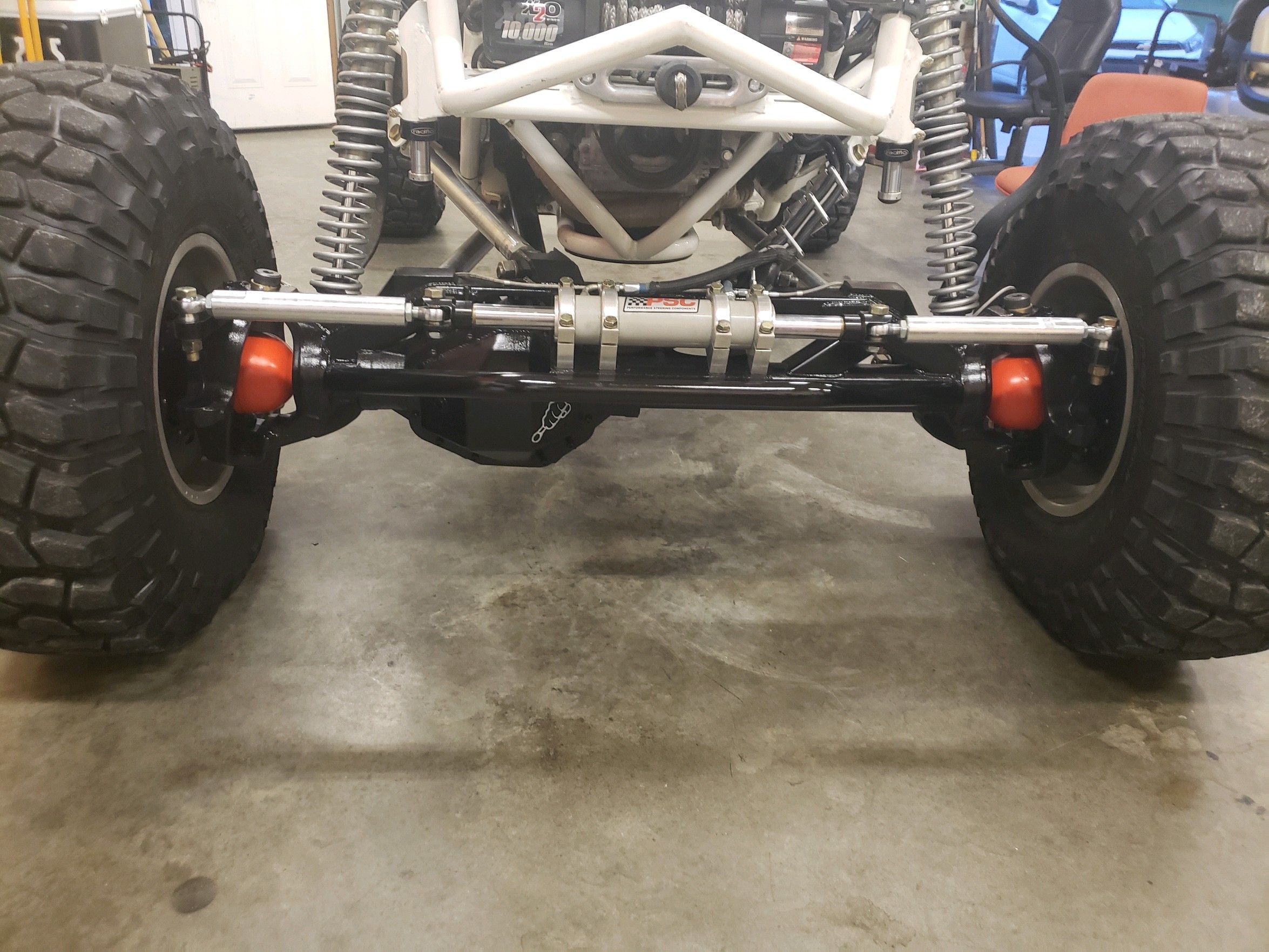

I use the Fox rubber coil over reservoir clamps on my links, with heat shrink over hose clamps to secure my hydro and brake line.

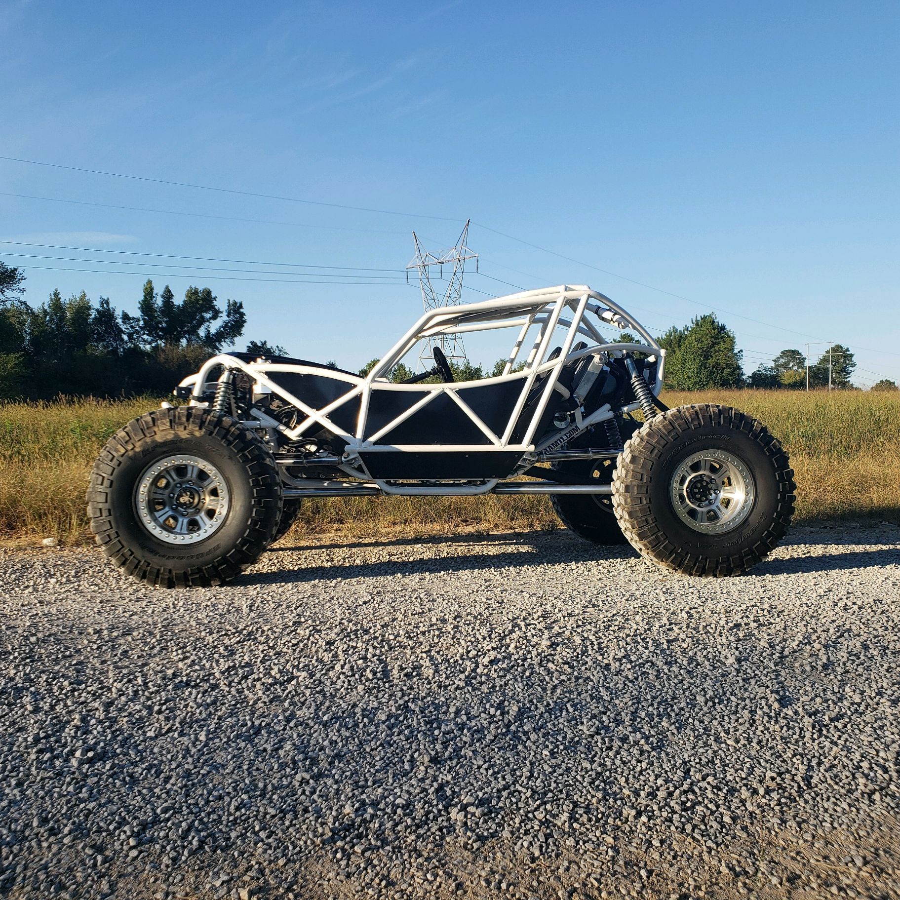

Specs.
L92, bullet Cam, new rings and gaskets, LS3 intake, Billet Rails, 92 mm
TB, k&n filter and pre filter
Th350, rmvb, 2800rpm stall
3.0 Atlas
60 front, 4.56 gears, spool, btf steering arms,
Shaved 14 bolt rear, spool, 4.56,
Fox Coilovers
Radflo Bumps
7075 Links with 1.25 heims all use 1.000 bolts.
PRP Premier Seats and Harnesses
Griffin Radiator with Dual Spal Fans, lingenfelter thermostat, -16an
fittings.
DeRale trans cooler with fan.
B&M Street Bandit Shifter
WOD, hanger bearing 2 piece drive shafts. 1410 front 1350 rear
AR400 skids
Stainless headers, vband clamps, flowmaster outlaw muffler.
PSC steering, billet aluminum pulley. PSC rollover vents for steering,
Transmission and Atlas
Walbro Pump, wix filter
Ajk offroad link clamps.
All hoses are braided.
Autometer Gauges
Optima Redtop, motobilt battery tray
Currie Sway bar
39 reds and racelines.
