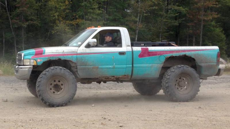

We are collecting parts right now to do something similar with a friend of mines truck. For the moment we're going to use stock 1500 springs with 2" spacers in the front and a shackle flip in the rear and bilstiens all the way around. We're going to trim accordingly to fit 37's.
I've seen a pic of a stock 2500 with 42's......
