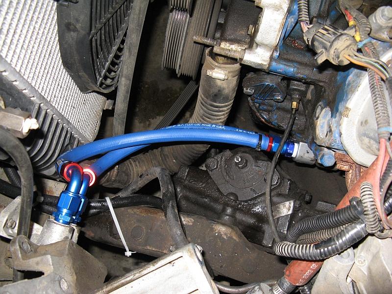

Jesus... I thought I went a little hack on some of my 5.0 swap....:wowwow:
So, he's using the oil filter adapter that's supposed to mount to the block to feed the oil filter... :eeek:
Spend a little more and plumb it so it will last...

This might help someone............the NAPA GOLD oil filter part # 7035 only protrudes from the block 2.125 inchs and is just under 3 inchs in Dia. Will do away with most peoples need for a remote filter.
