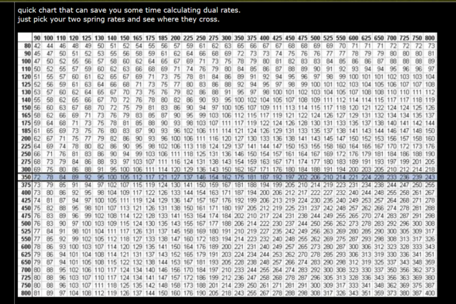

From another thread
Here is a link to a calculator I did to find spring rates based on preload and using measured values from current springs.
http://metalwerxdesign.com/files/springcalculatorv2.xlsx
