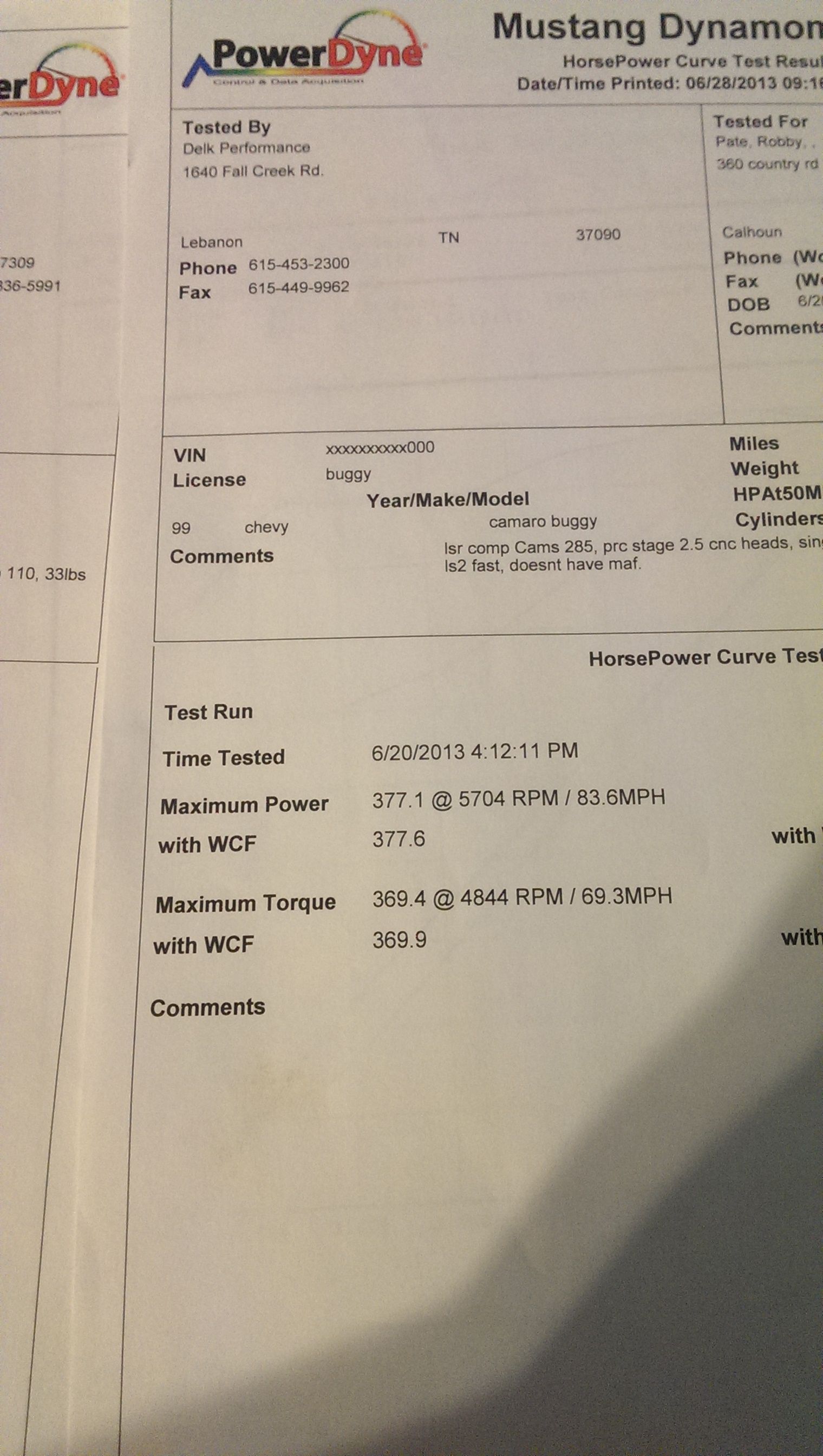

Not sure if he just got a good one or what but Wizzo on here has a stock 6.0 outta a Hummer and Jonathan at Dyno proven dynoed it at rear wheels. First pull was like 306 then changed map curve to suit him and left it at like 302 iirc. I'm sure he will chime in but that's completely stock no head work cam anything.
Here's some of the dyno papers.

I've seen all different levels of drivetrain loss even with similar combo's on the same dyno. 40% is not uncommon with some of these offroad vehicles but his is likely more efficient and isn't really losing 40%. For instance, Todd Puckett's Silencer buggy only put down around 180 hp to the tire but he's running a heavily warmed over supercharged 3.8 that's well over 300 hp. Probably closer to 400 hp at the crank. Lot's of variables come into play on a chassis dyno.

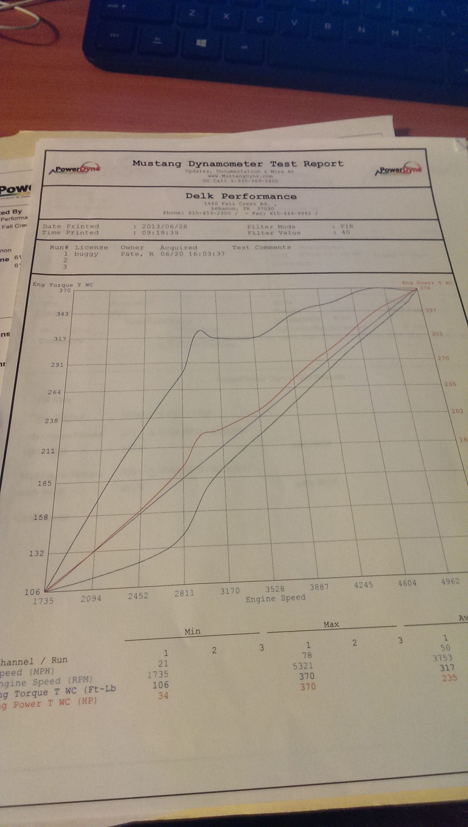

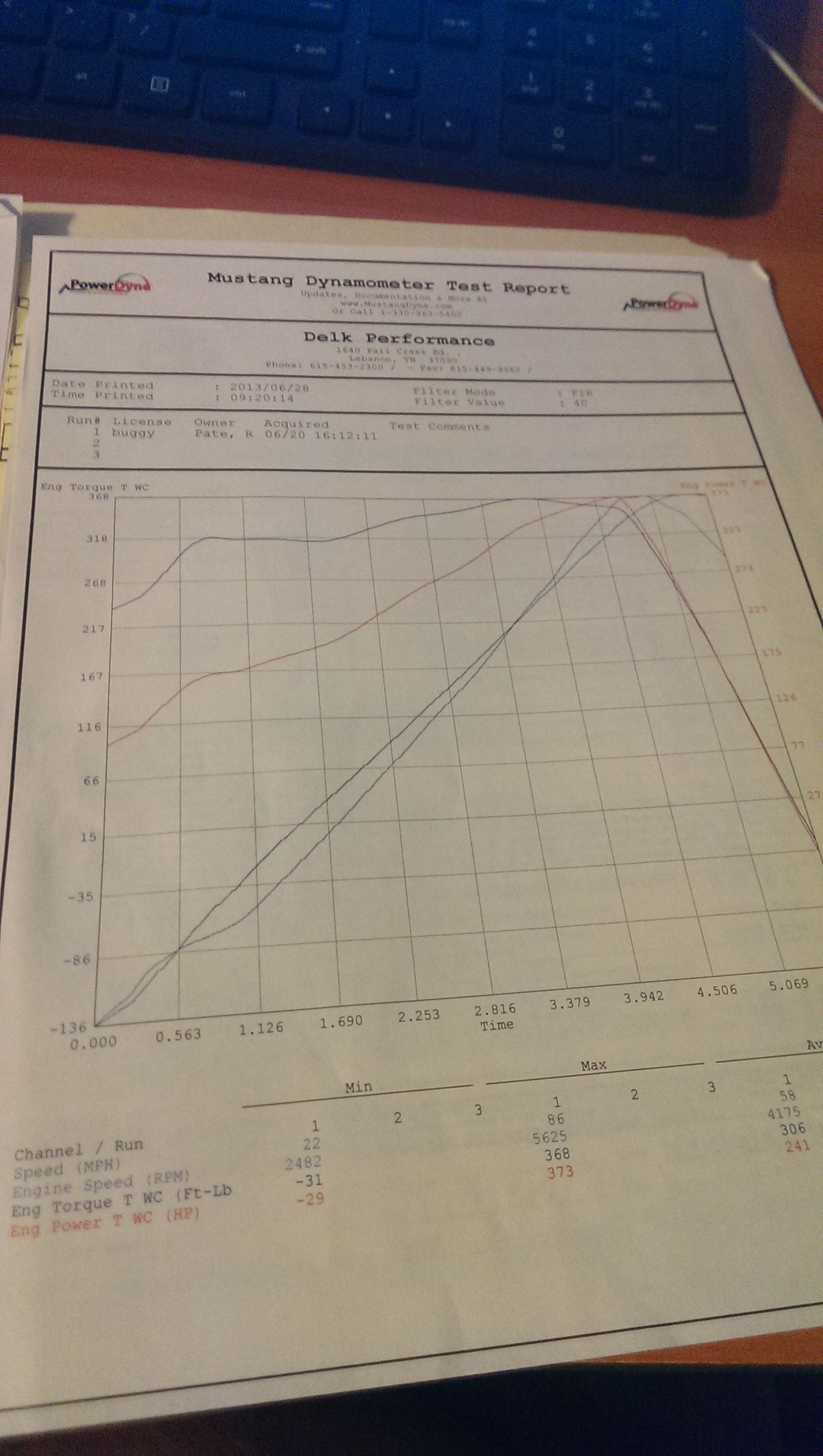

This is the two pulls showing what it did at the wheels.

Wonder what rpm it topped out at?
I can find out but when we took it to the drag strip this fall he was shifting at 7000 and tickling high 9's in a 2900lb Camaro. It'll go deep 9's with more chassis work. Gonna hit it with a 300 shot this spring once the chassis is ironed out.
I would guess that the 40% thing is an assumption to make people feel warm and fuzzy.
