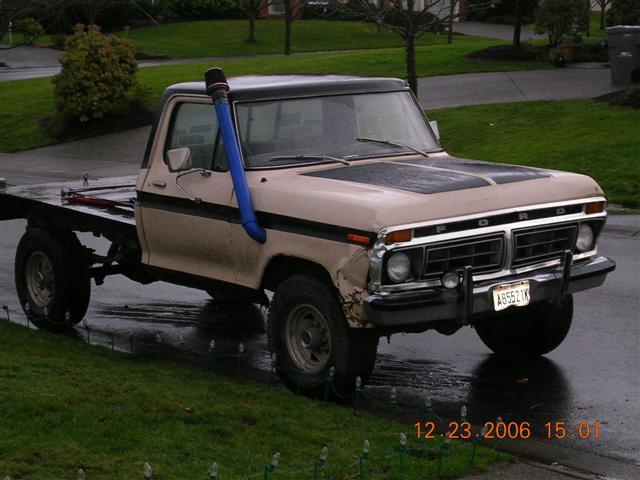

I finally lost the blue snorkel and the wood flat bed, along with finally got a steroe so no more headset:looser: . I have been going 4 wheeling at a buddies house and decided it was time to get involved with ya all again.

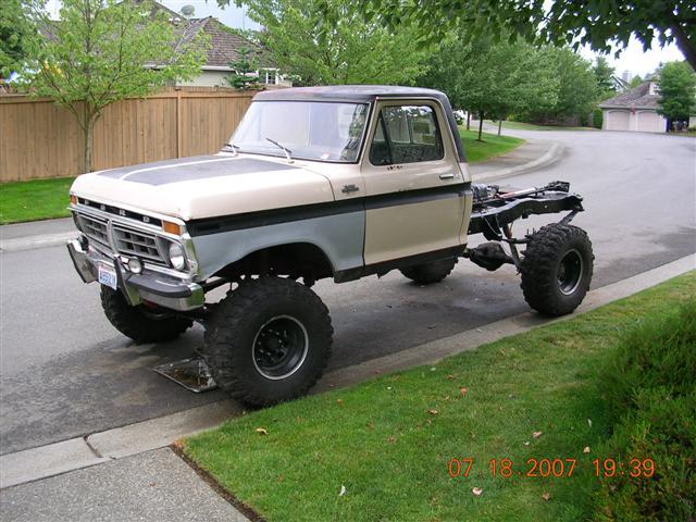

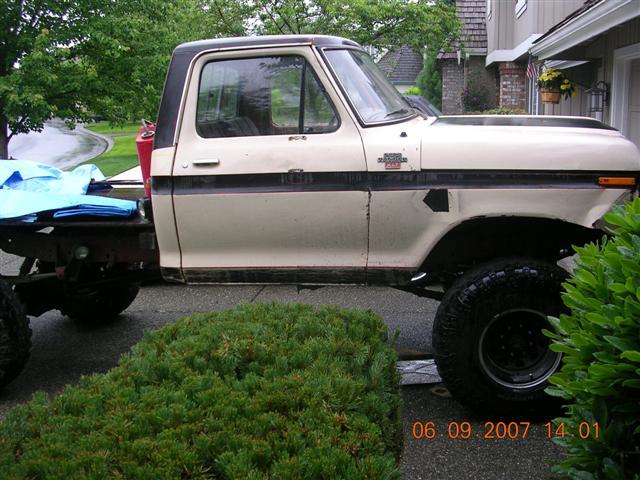

JUst a couple more some body damage and the new t-case.
Notice The last pic that was 2 months into owning it, I'm at 10months now

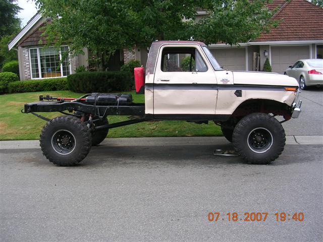

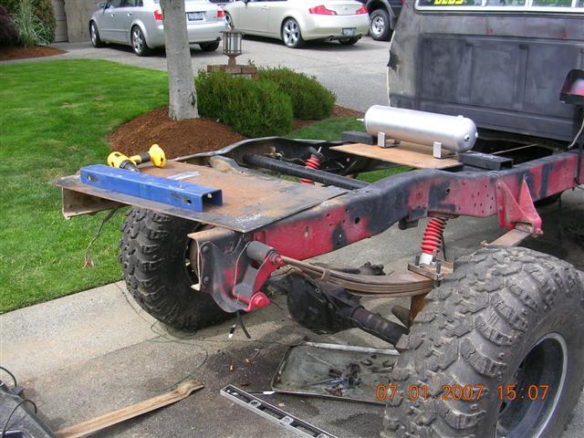

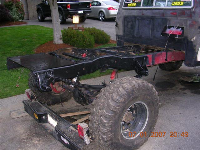

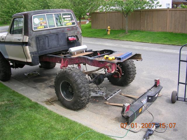

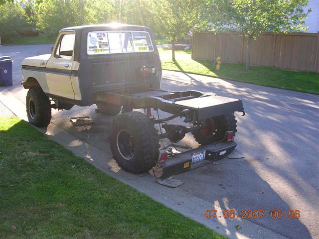

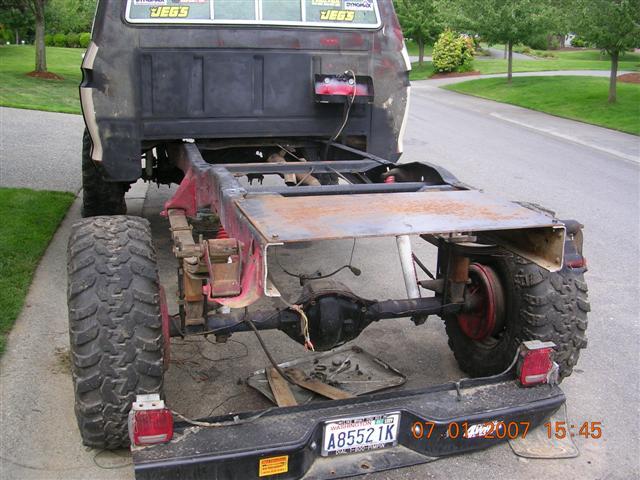

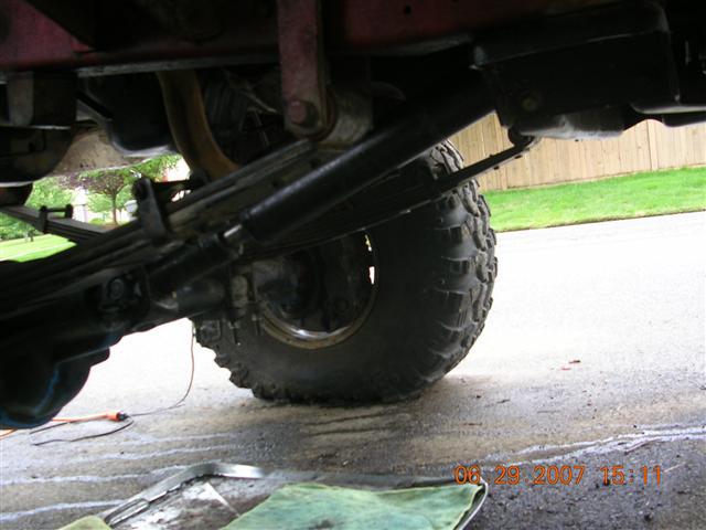

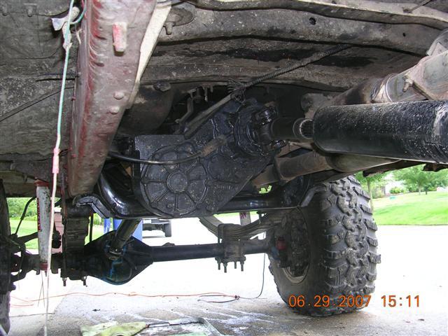

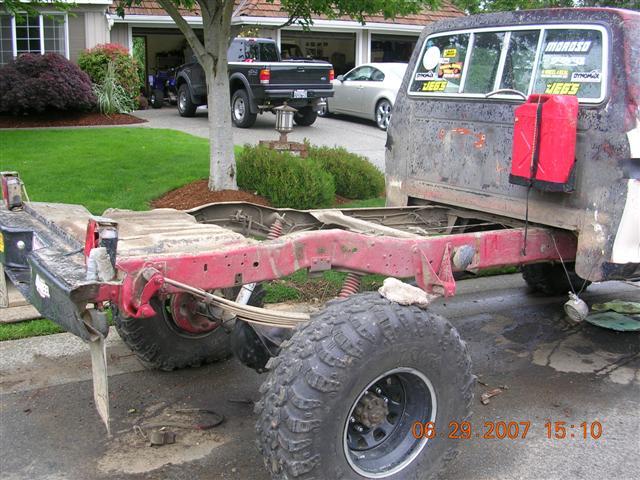

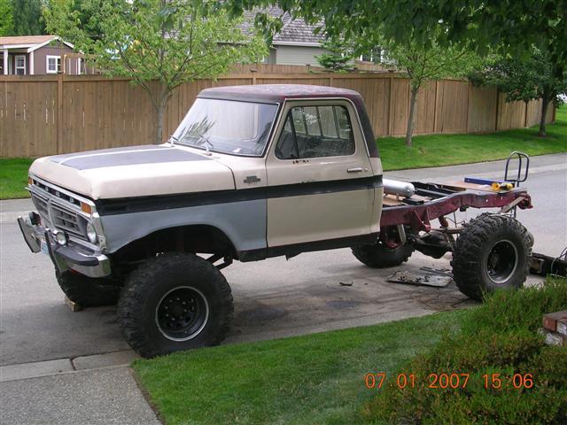

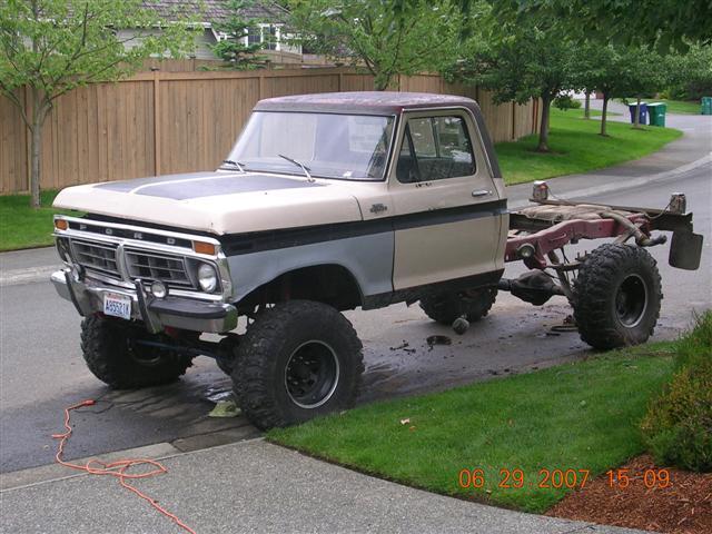

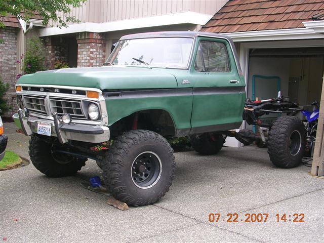

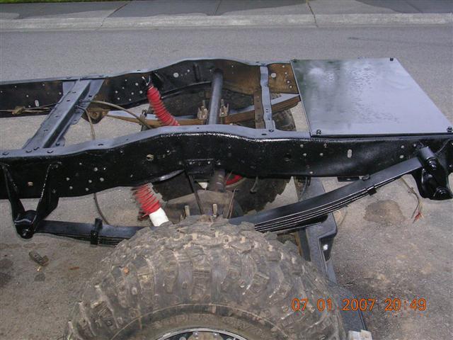

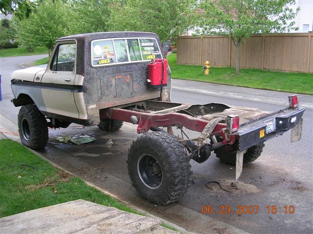

Got so more work done today cut the rear frame up the the leaf mount and removed my gas tank, fuel and brake lines, and cut and drilled and installed the rear plate on the frame. I painted the frame black except the section i'm cutting out of the frame rails tomorrow. I'm gonna start building my t-case skid tomorrow once i get the rear suspension cut off and the frame cut:cool:

heres a few more, where i left it today:stirpot:

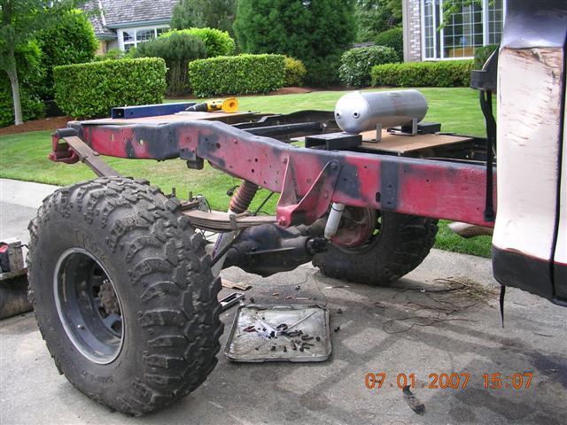

Well i pick up the mig tomorrow to finally do the major surgery and to finish the pile up! (for now):cheer: I got all the sheets of plate cut out into the shapes i want and finally got the rear frame plate and tow hooks installed.
I also scored a C02 tank for OBA today but need the fittings to make it work still! I found out i have 3 compression fractures in my lower back so progress has been slow, but its looking like a solid 2 weeks grind and she should be ready to hit the trails FINALLY!!!!

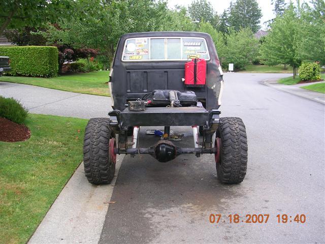

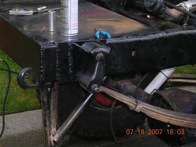

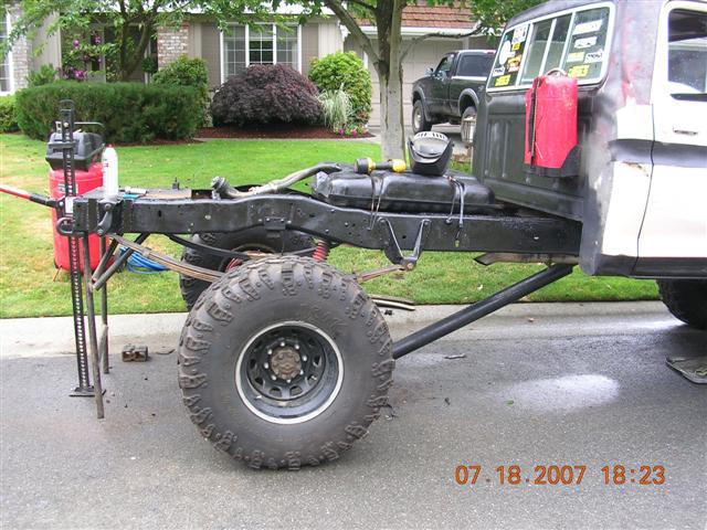

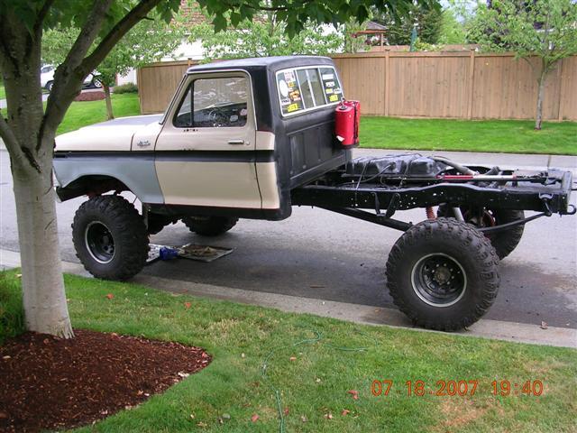

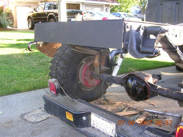

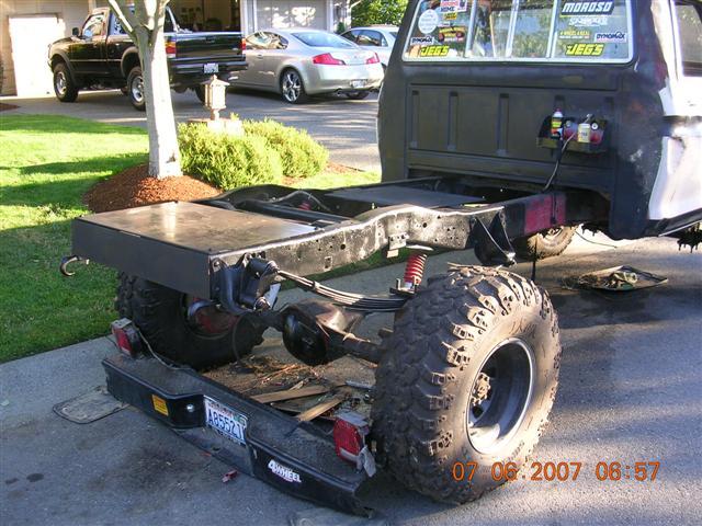

Well I finally got the shackle flip done in the rear. Everything i wanted to do is taking twice as long with unexpected problem(damn women cant ever win:mad: ). I got the fuel tank set in finally along with the rear brake lines extened and bracket dropped. i had to kinda completly redo my spring buckets and shackles, i chopped, cut, the stock ones and reinforced and rebacked the stockers to work for my shackle flip, since i was unable to find any aftermarket kit for my app:eeek:
Will post pics tonight
Well got the shackle flip done today. I think i got the shackle angle about right?????
Everything is coming together I think i finally found a trailer to use, so i'm hoping that i can get out to reiter this weekend and test it all out:cheer:

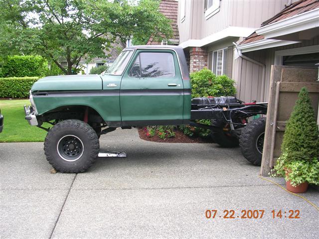

OH FAWK YEAH. The green and black is getting it. If i was you i would try to get more weight on the ass end of it and cover that hole in the pass fender....a stick(or something) is bound to get in there and rip up yer fender.
The whole is actually covered rivveted a plate in behind so its golden. I haveb't worried about weight in the rear because i shortening the wheelbase.
If i measured all right (like 20times now) my rear tires will be only 9in away from my cab or some crazy number like that so it should have a very centered weight to it! . . . . . . I hope:eeek:
Damn 9" from the cab :eeek: that thing is going to be stubby.
