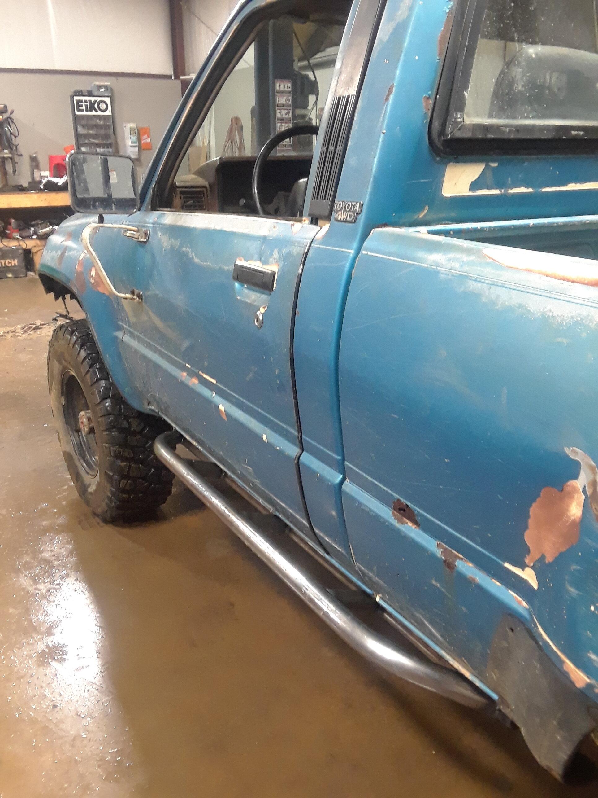

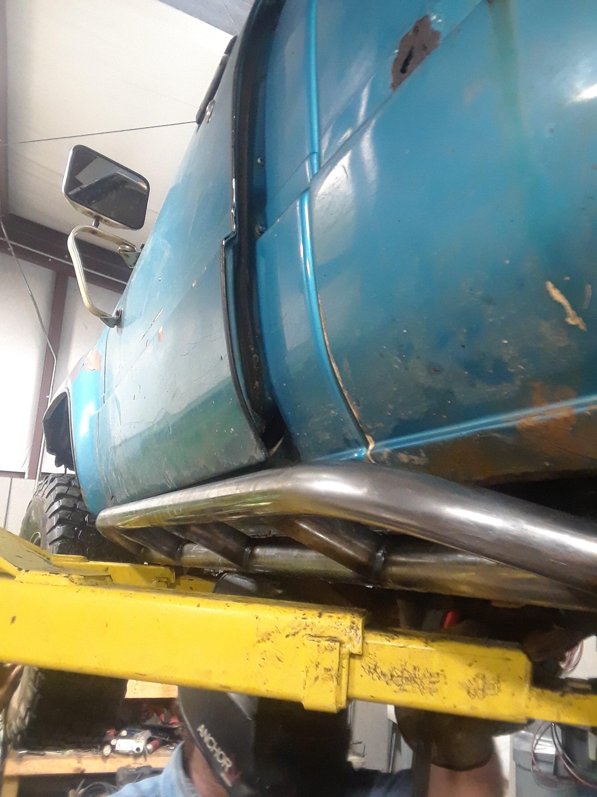

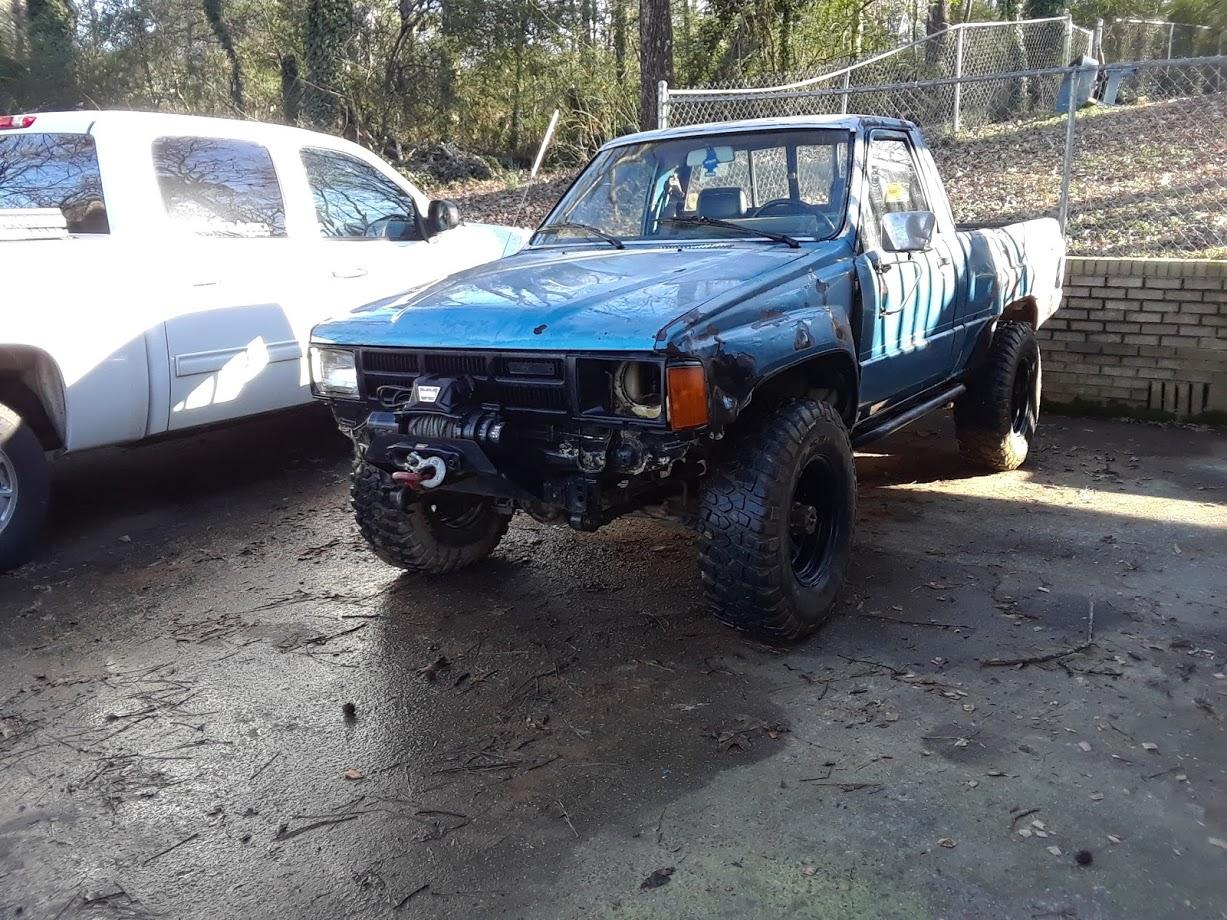

I had so much fun with this thing for the past few years with just a rear locker and 31s. In February 2018 me and handful of guys planned a weekend trip to Stoney. I pulled a few parts from the pile and went ahead and threw on a Weber carb and a set of Trail-Gear sliders.

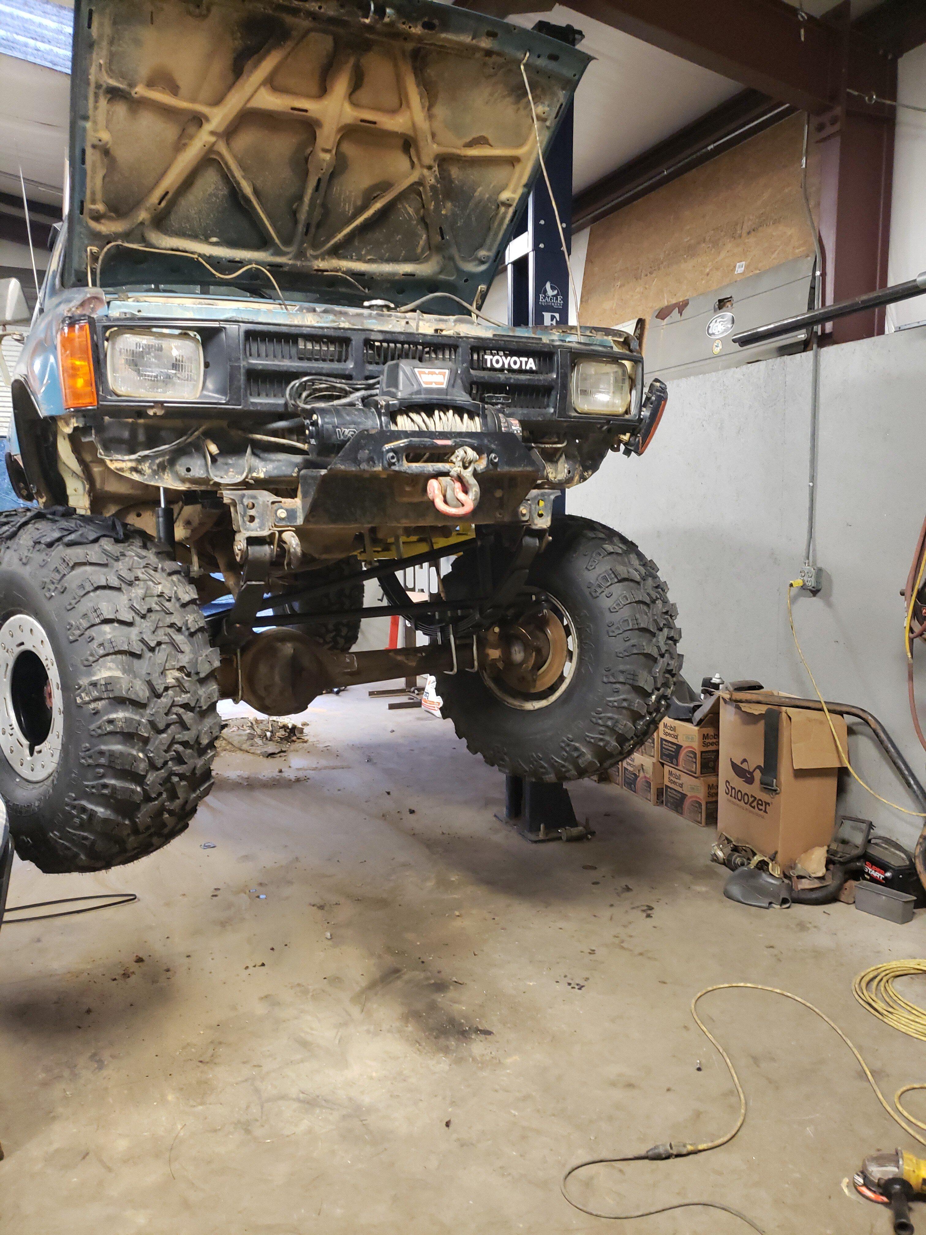

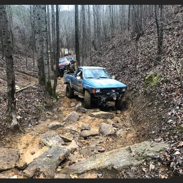

Wheeled around like this for a year or so. I've put countless trunion bearings and tail lights in since. At some point I put disk brakes on the rear. Riding some local land I broke the tie-rod end out of the steering arm in the middle of the woods. Put it back together with a hose clamp and got it to the trailer. At this point I had everything to build it except for a few small parts. We were planning a trip to Coppinger Cove the next month so I borrowed another push pull tie rod, threw in RCV shafts, and welded the front end.

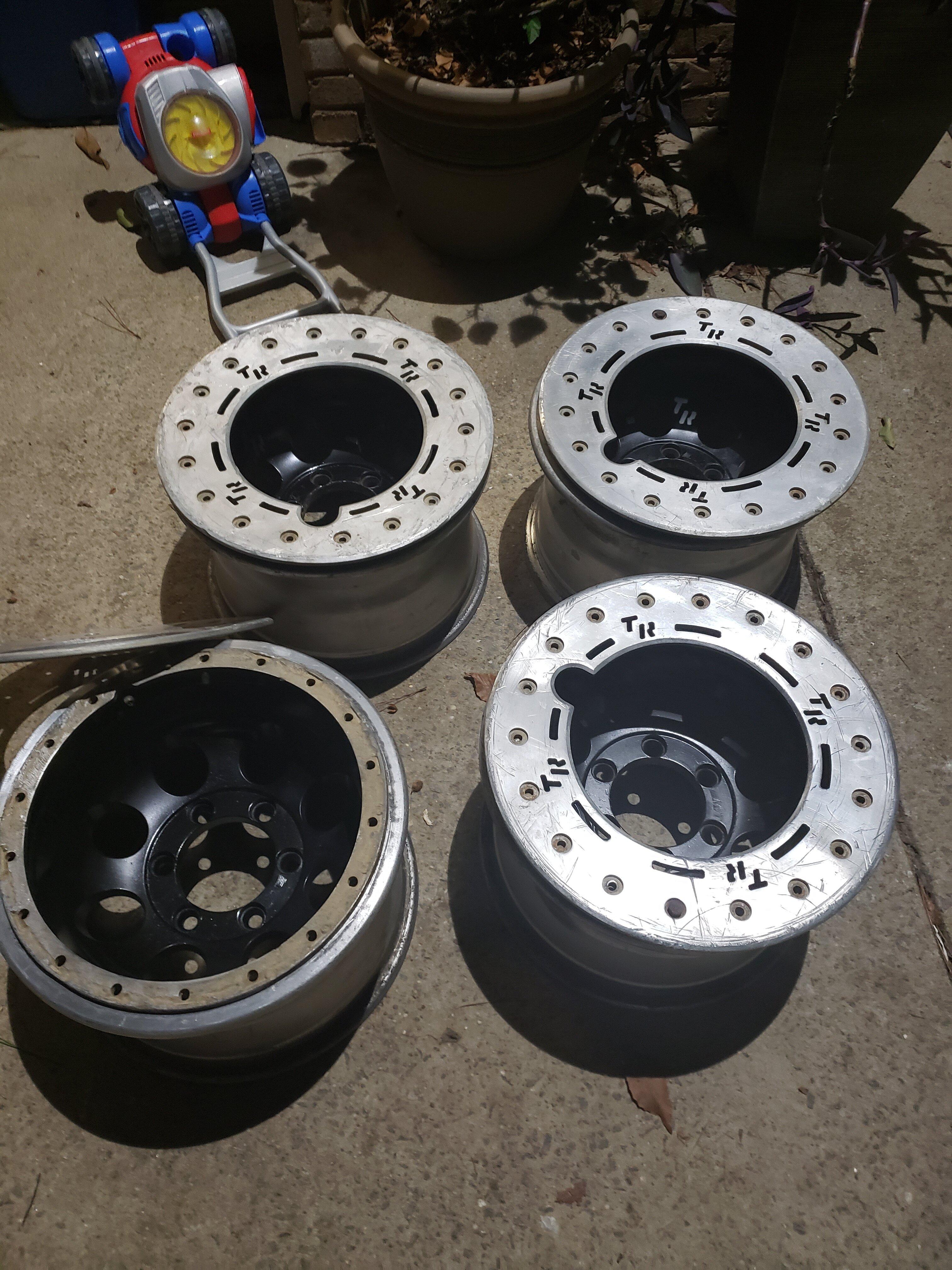

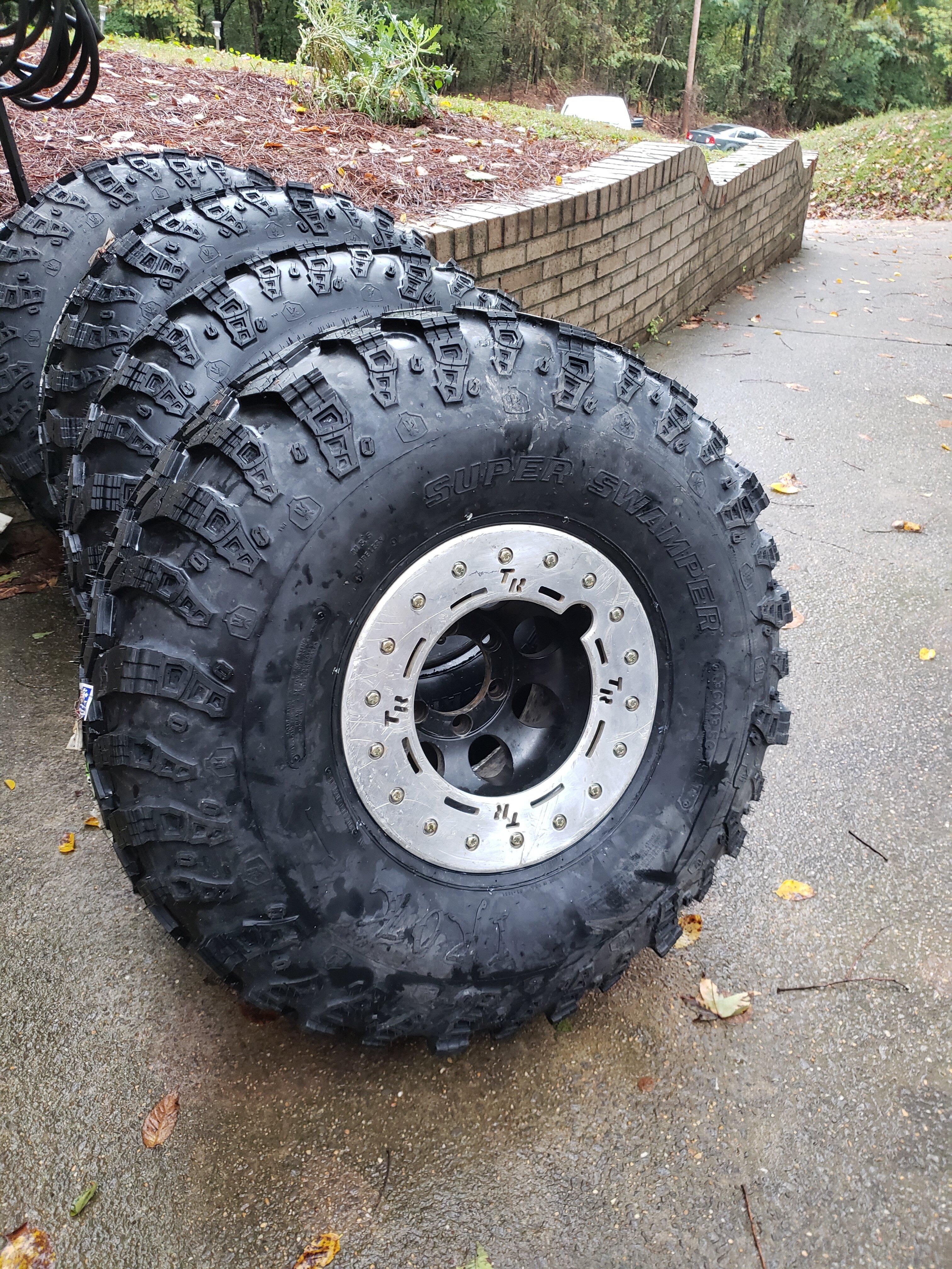

After this ride I was over the **** springs, steering, tuning...and 31s. So immediately after it was torn apart. I needed a set of beadlock wheels. I was going to buy a new set of Battleborn wheels until Red94YJ found these on Marketplace for $200.

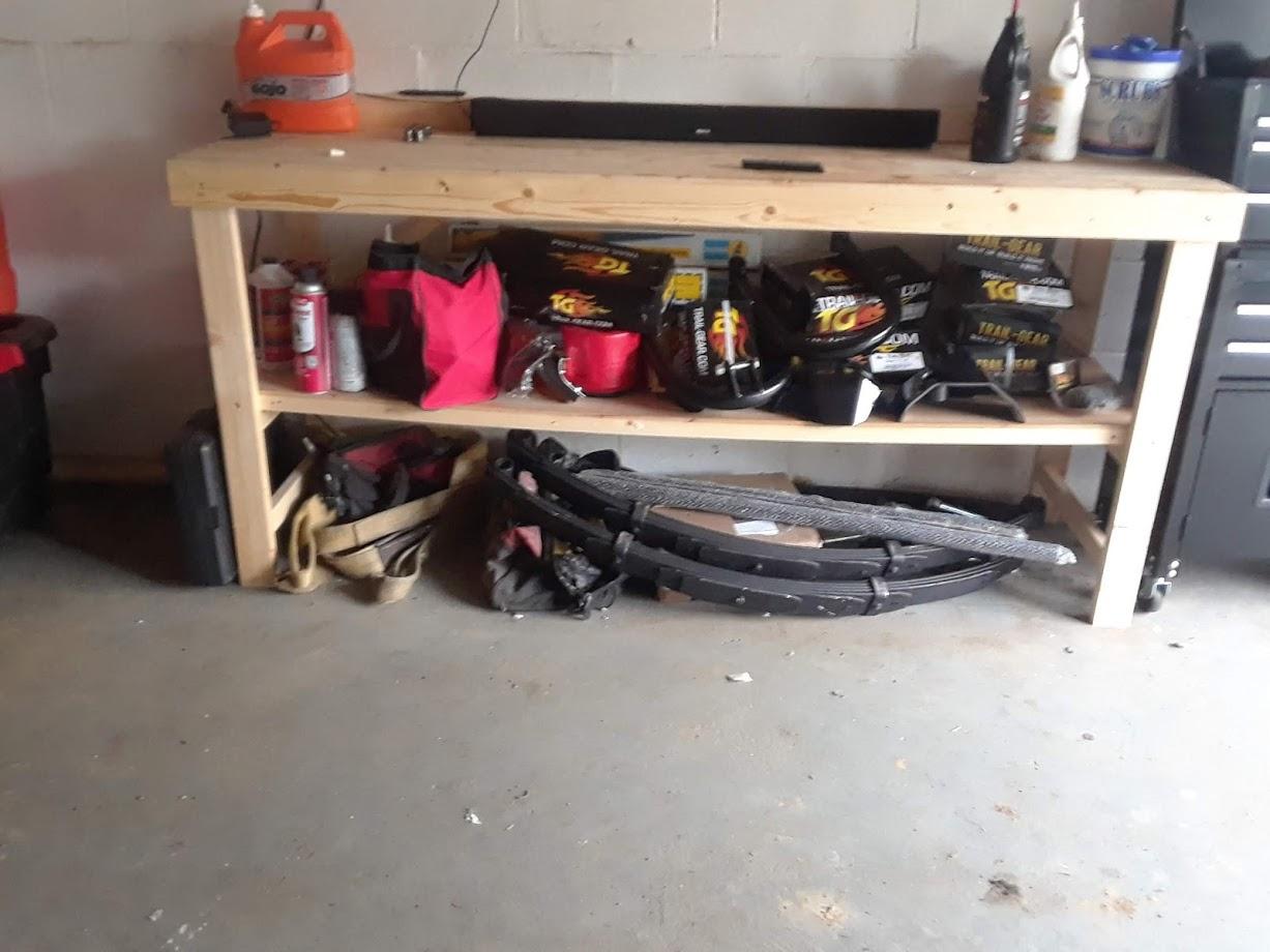

I bought 4" TG front, found a set of 2wd 63 Chevy springs for the rear. Both with a 5.5" shackle. High Steer, ARP knuckle studs, dual cases, Bud Built skid plate, Bomb Proof motor and transfer case mount, Bilstein shocks. I'm sure I am forgetting a few things.
Did the 63's make a big difference?
