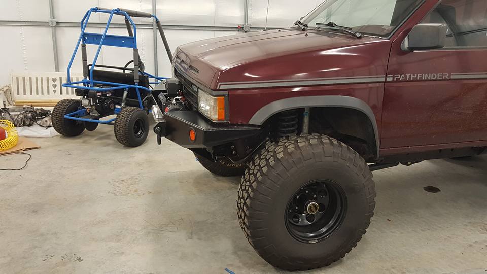

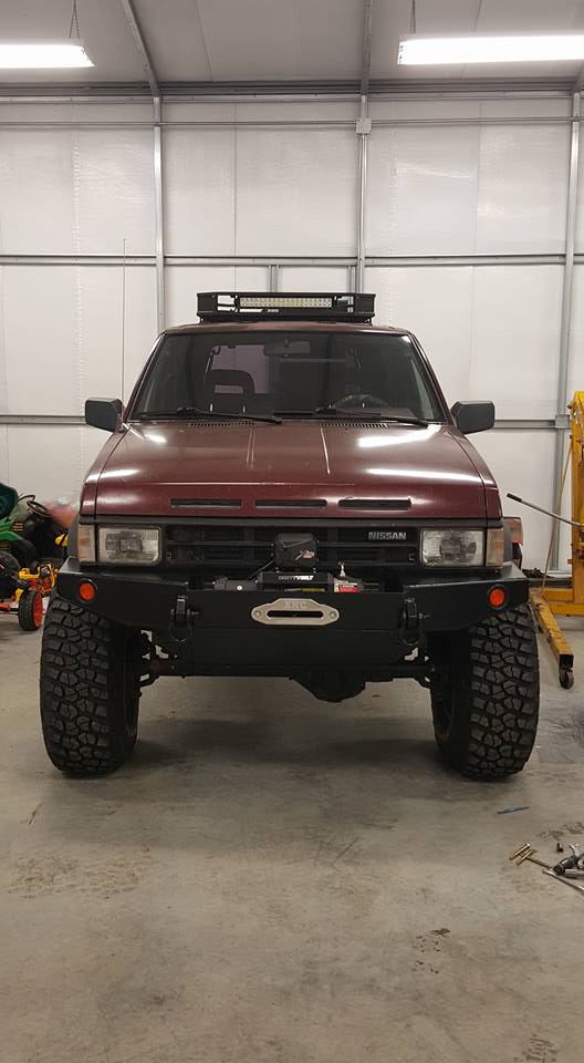

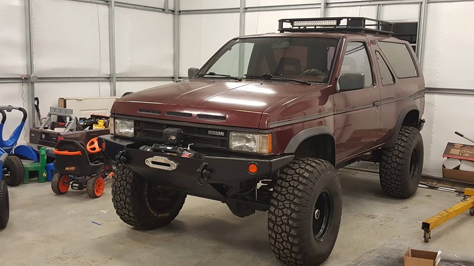

Finally got around to building a front bumper. Rear is next.
