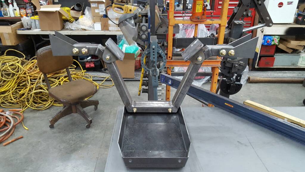

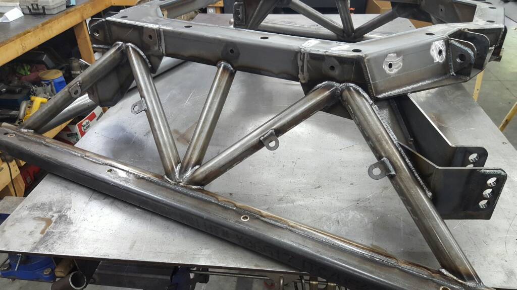

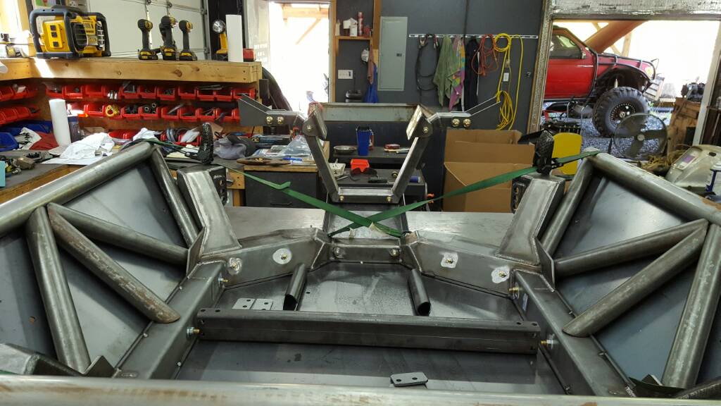

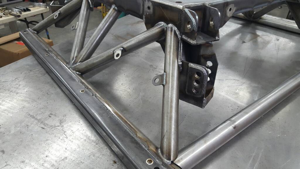

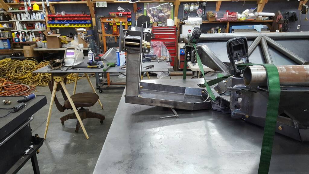

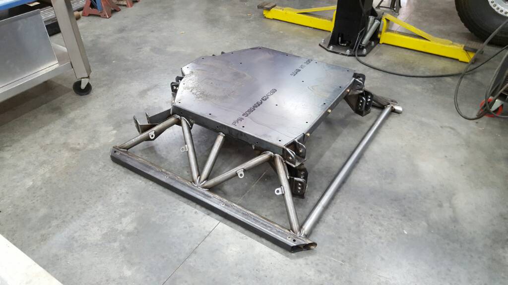

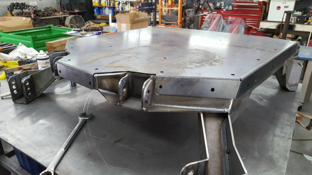

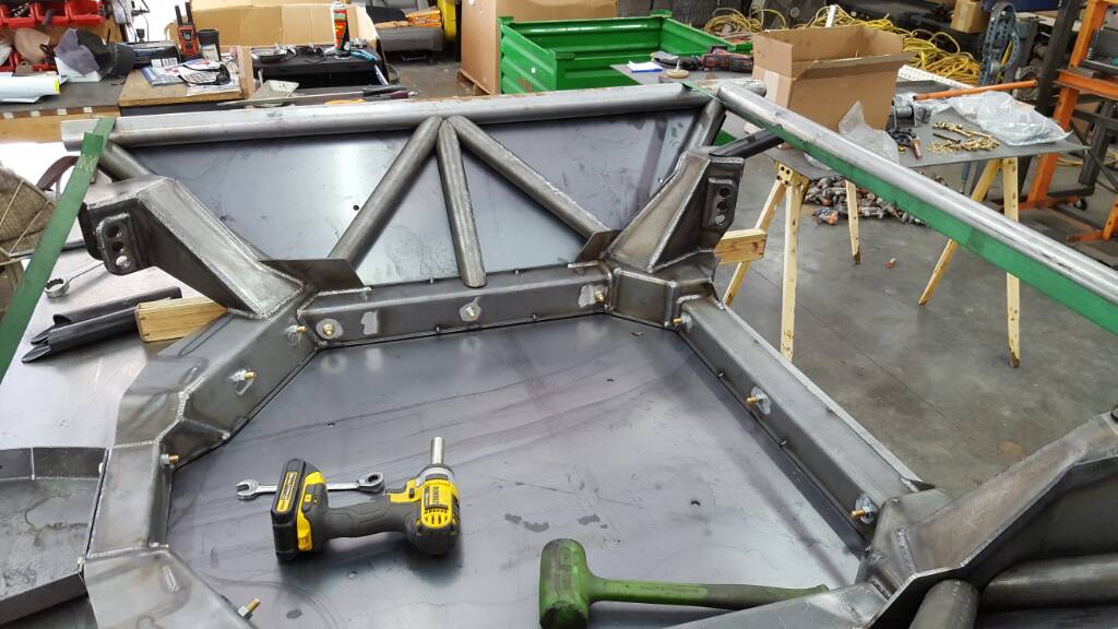

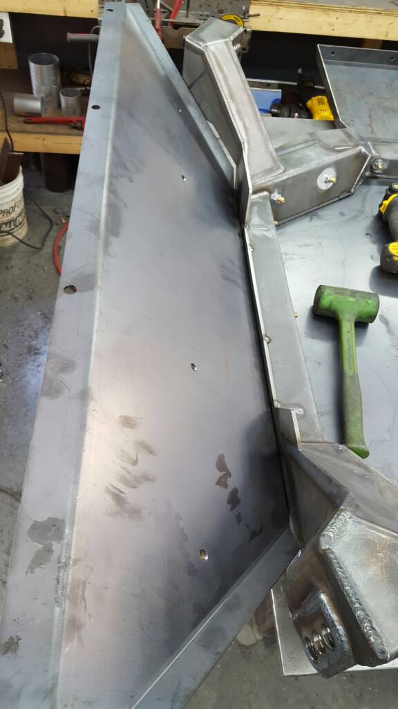

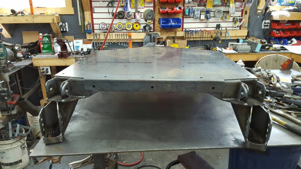

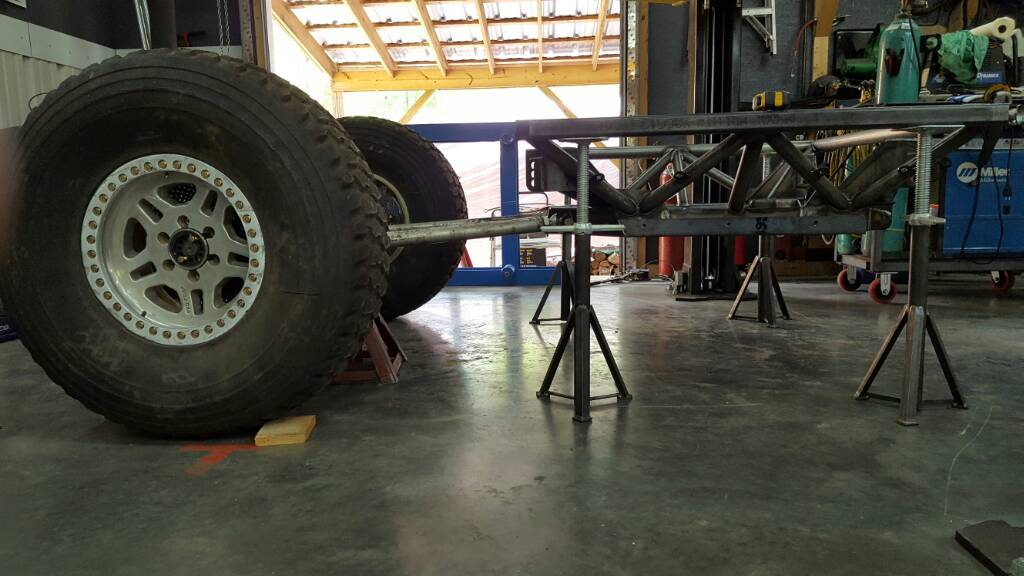

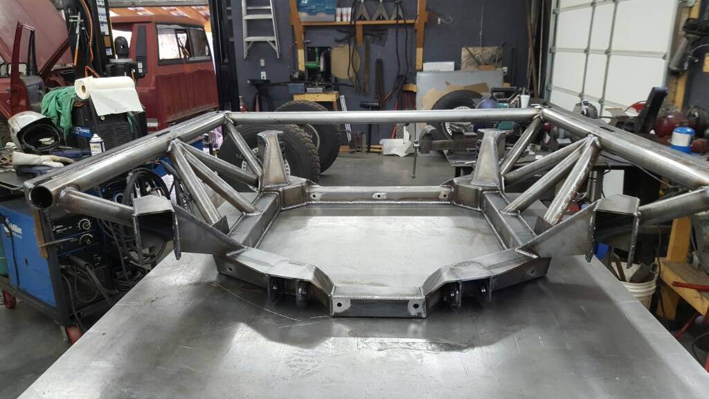

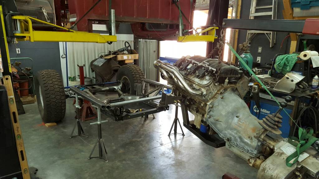

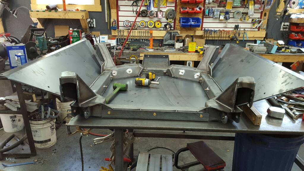

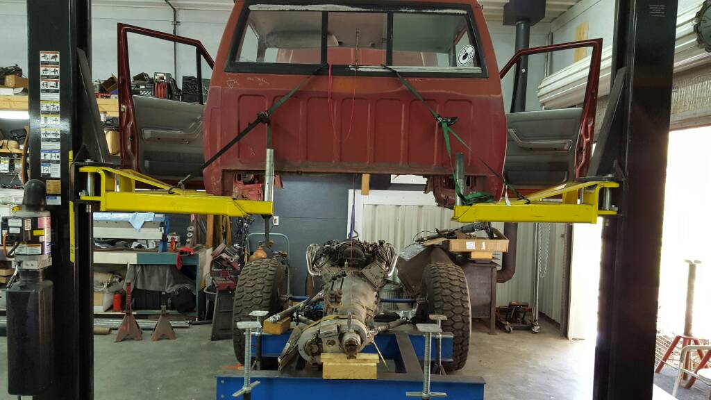

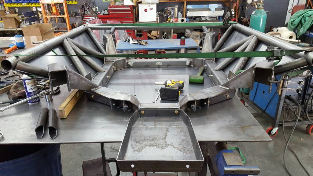

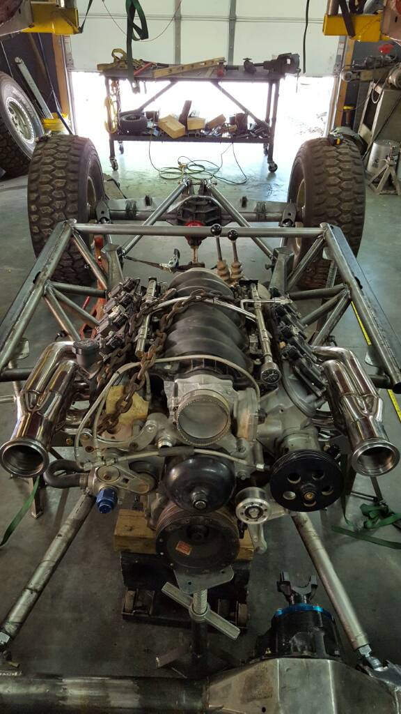

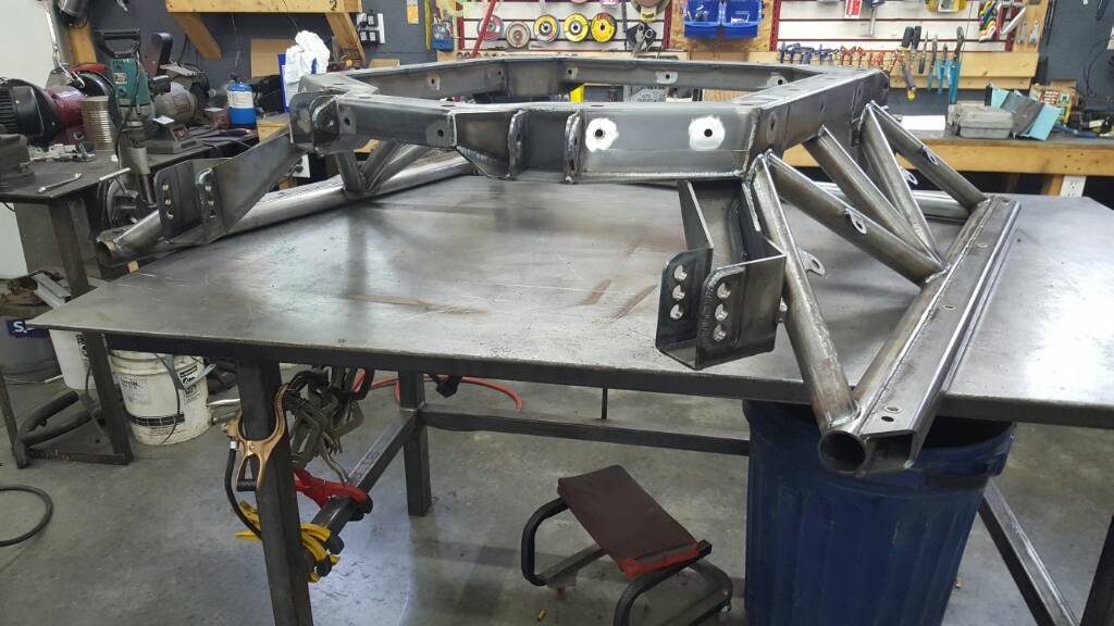

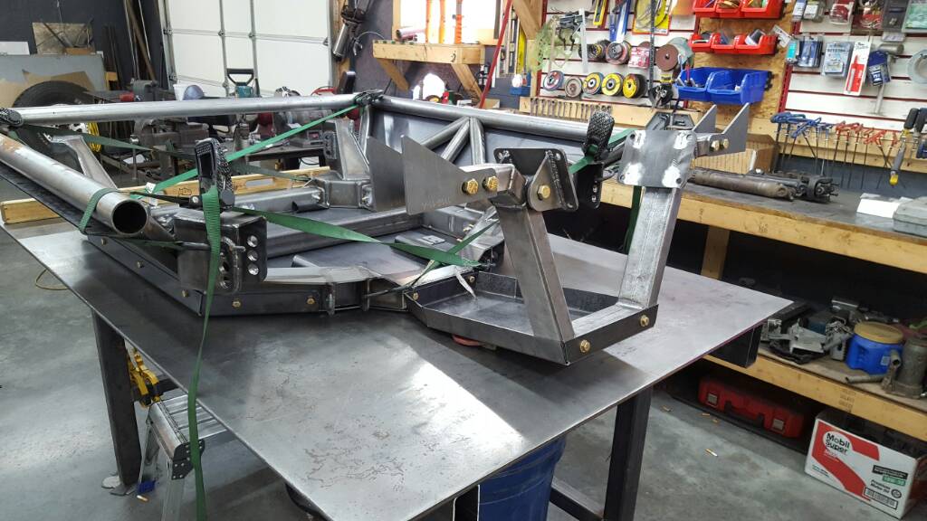

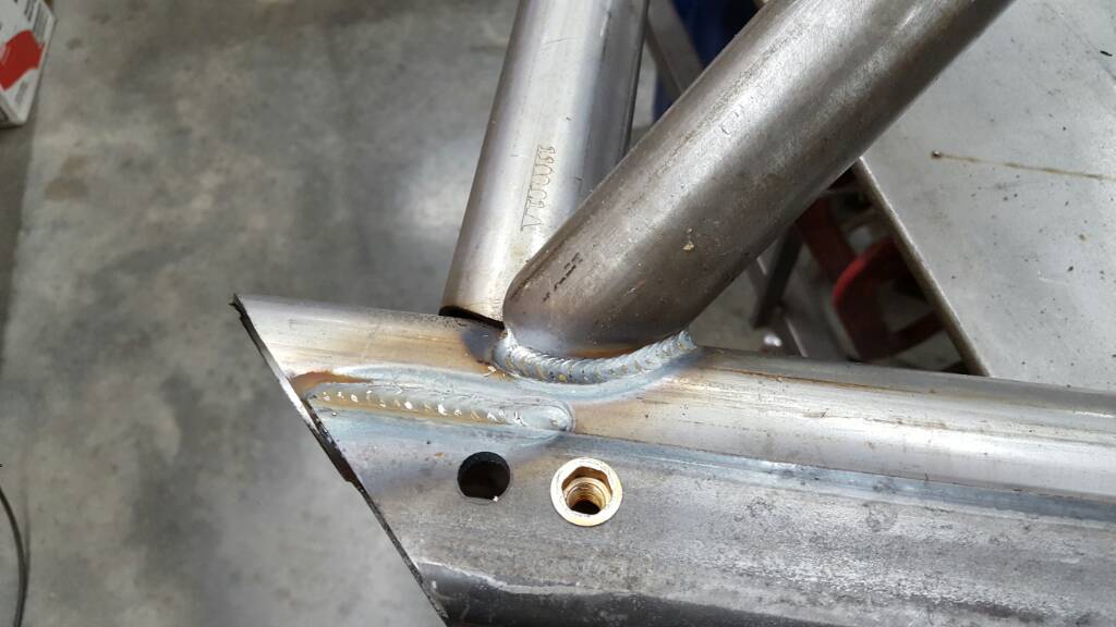

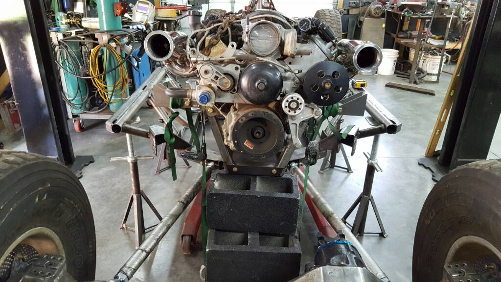

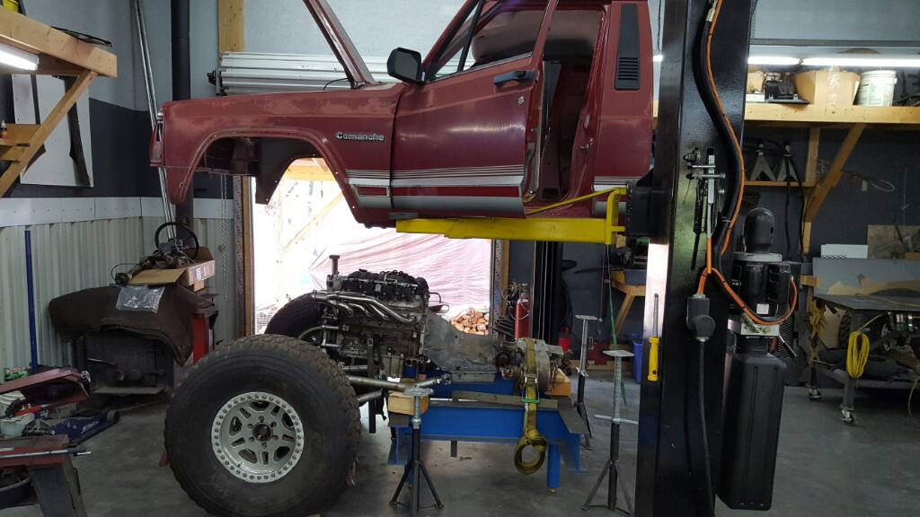

Got the rest of the subframe and skids mocked up. Almost done with all the welding on the base.

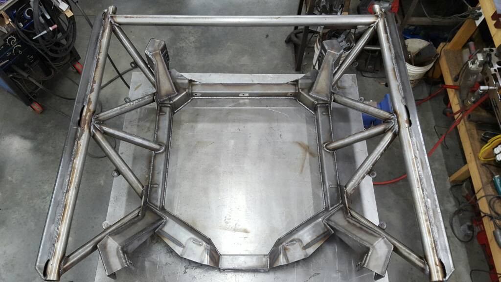

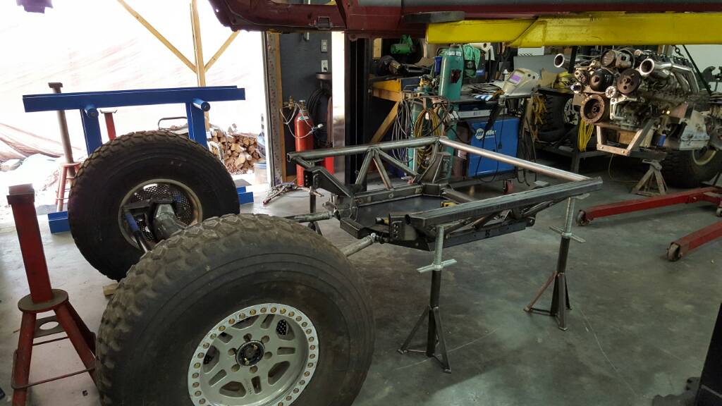

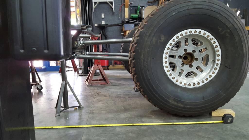

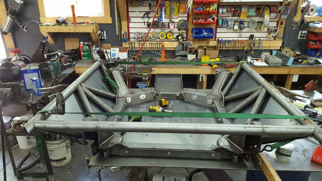

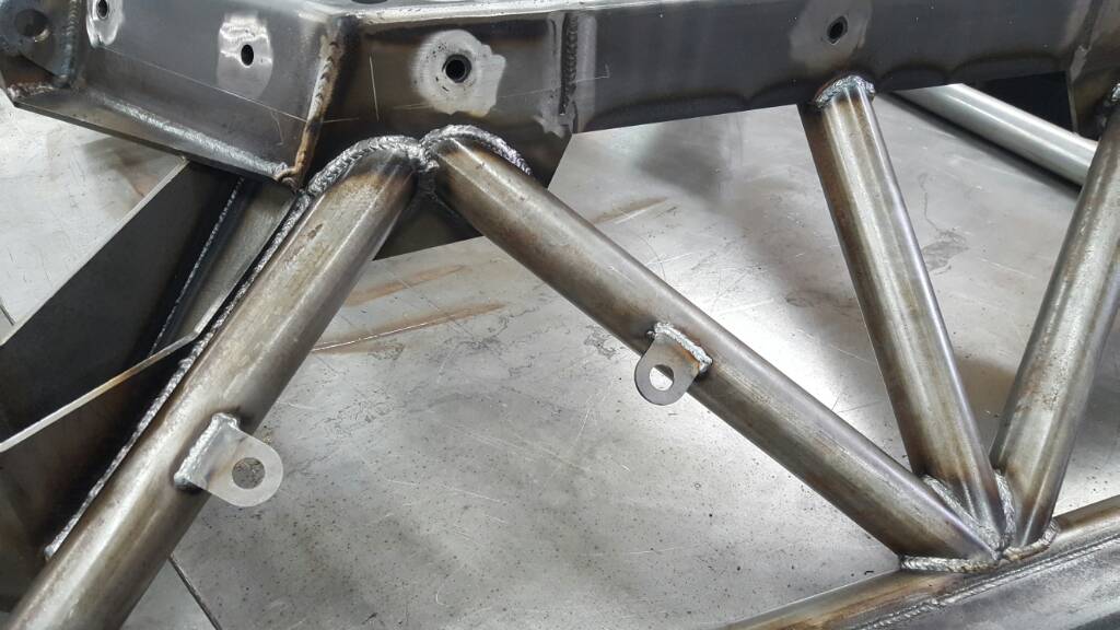

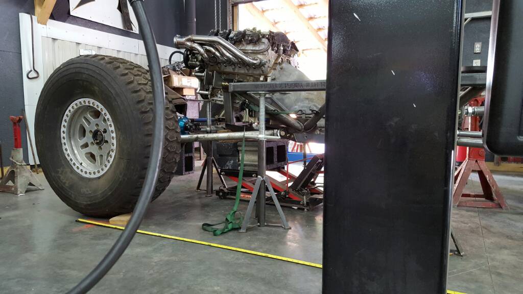

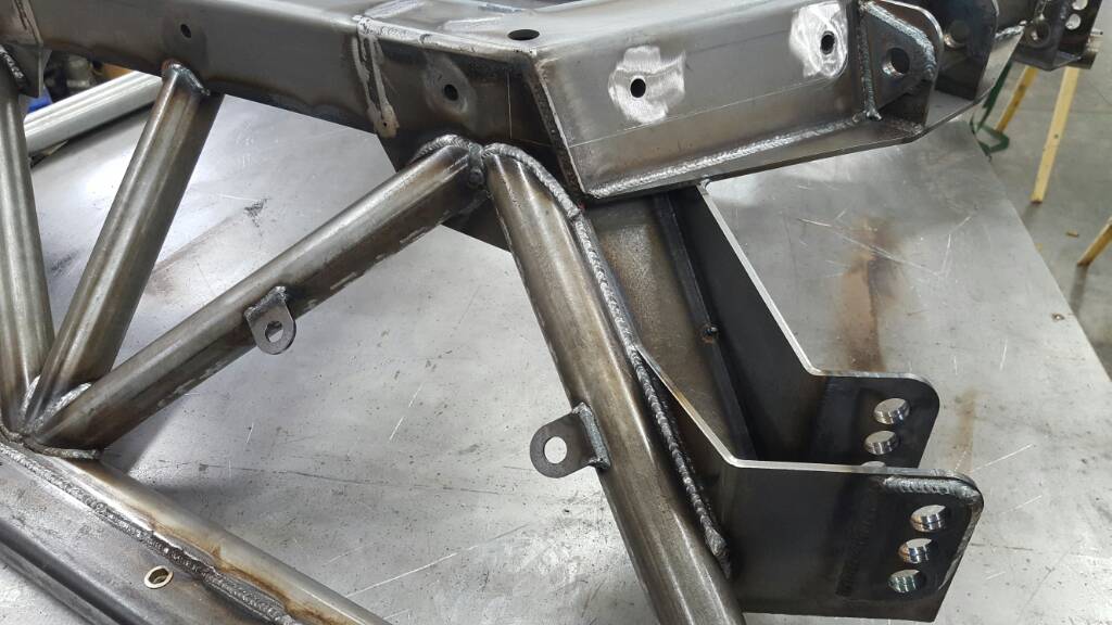

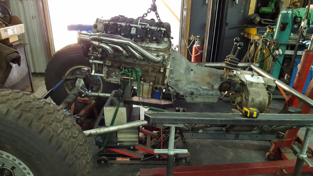

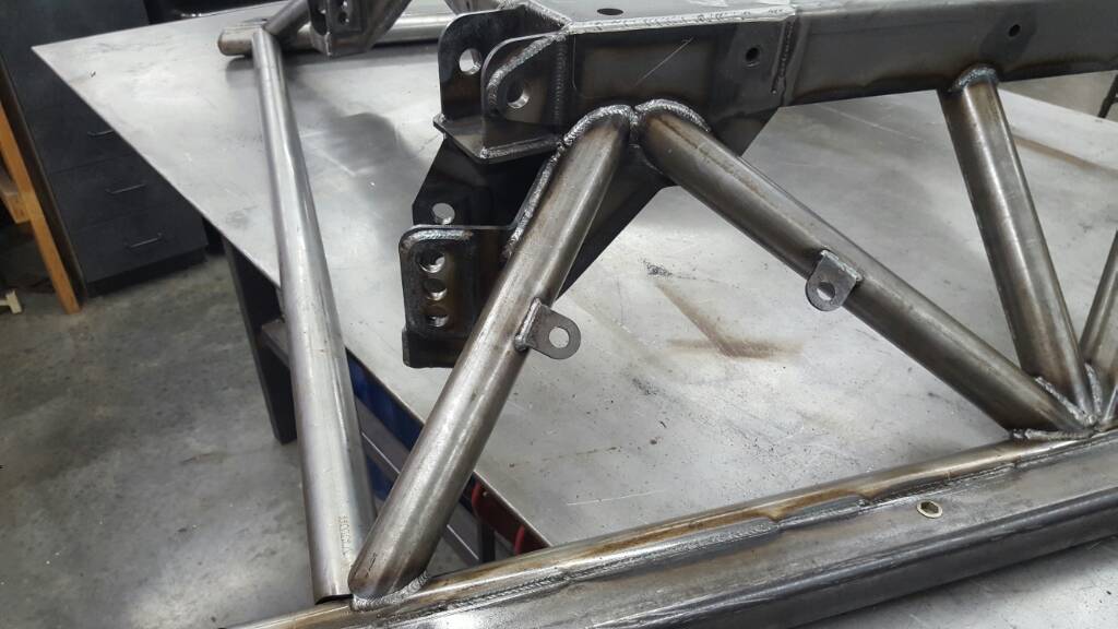

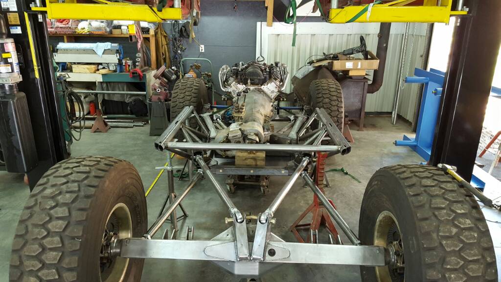

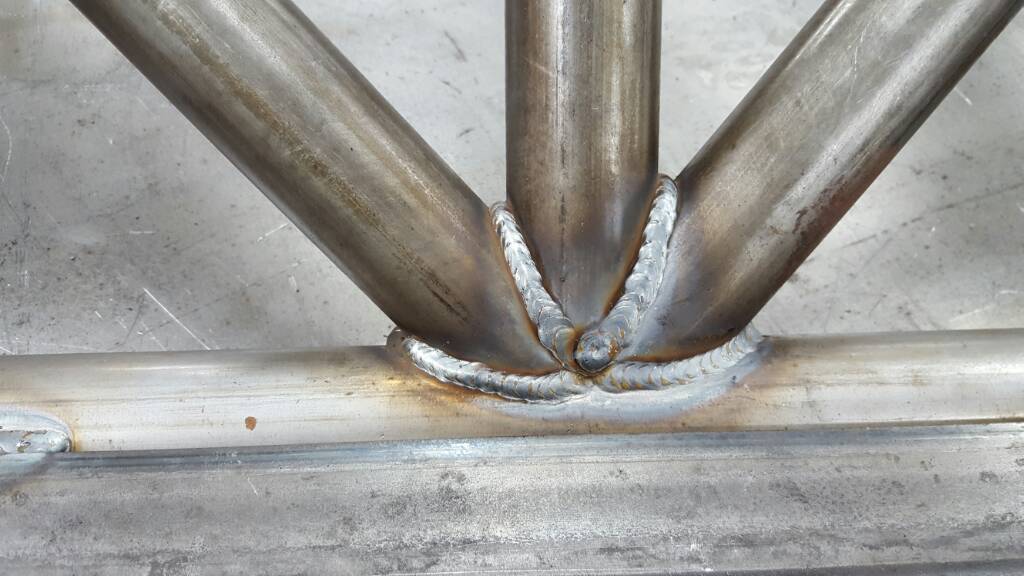

The subframe is almost ready to have some links and a powertrain attached to it. One more flip for a couple small welds, and then time to really get to work.

BTW, more props to Drew at goatbuilt. Didn't have to touch even one of the notches with a flap wheel. I actually built the sides in reverse. Bolted skids on, laid the tube in, bolted the tabs, bolted the rub rail, brought all the dimensions to spec, and then tacked the rubs and skid tabs before I made any hard tacks on the tubing. Then removed the skids and finish weld. Worked like a charm.

noracin said:
Did you weight the subframe?
Hell no, sorry, got so excited to throw it down with the links and drive train, simply forgot. Easily 200 lbs though.
