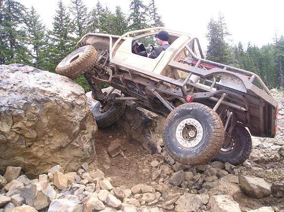

the strut will not work well for the rear of a toyota. your going to give the rig more instability than it has with poor articulating leafs. Get ahold of BINDER he has a pair of coilovers on the rear of his rig that are used and may help your budget a bit and your end result will be much better. Besides Binder needs to get on struts..... as well as Porter. BTW PORTER I have a buyer for your coilovers so when your ready gimmie a dind so we can get ya hooked up.
I think this guy would disagree he drove his rig all the way to moab and back and spanked alot of trail ask Sam:D
