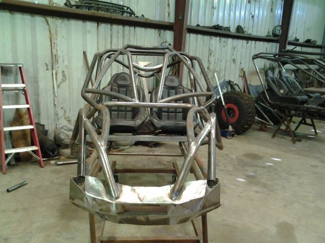

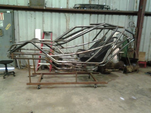

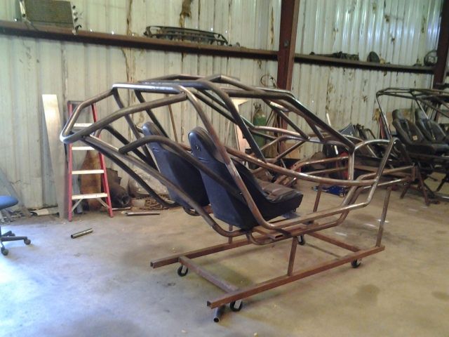

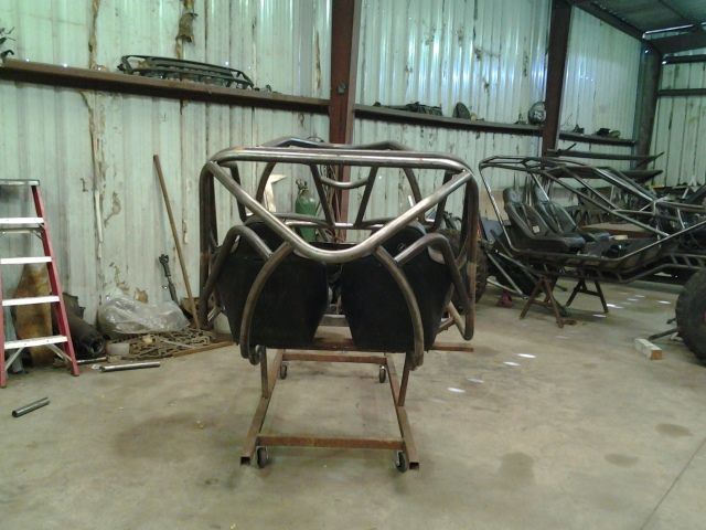

Ok here is the next one will be ready in a week or so (unless my ADD takes over again) this one has a lot of .188 wall dom in it as well as .120 wall dom an some .120 wall hrew :driving: this one is small I built it very tight on me so it wouldn't look so big on a smaller person
Re: angryfab finally got back to work
**** forgot the picture's (if its to early to drink then what was 2 hours ago) :dunno:
Looks good, I personally believe the one I got ahold of has the best appearance. Even tho Im going to modify the roof need a couple more inches of clearance. :driving:
Sent from an iPhone using Tapatalk!
tks bud an that's what its all about :driving: making it your own :dblthumb: when u build it u know how u want it an at the end u know every bolt in it an you know what u got :spin: :spin: :spin:
Love the lines! Great looking chassis! Would love to snatch one of these up in the future. 8)
good looking chassis, saw it in the shop last night. ;D
That's a good price who is it for . where are you located?

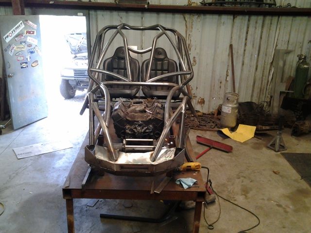

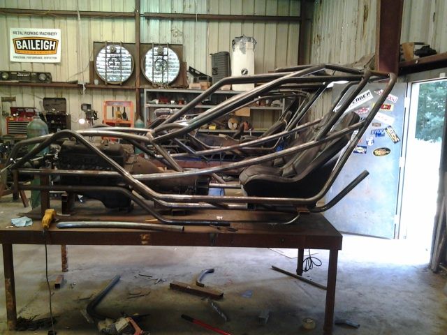

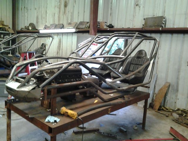

Updates still got a lot of filler an this is not going to be ls friendly unless u want to bring it in from the bottom

Could you not use them football shaped flanges and make those two bars removable and connect engine cage to them? Just a thought....
Got mor bars going in but I will look at it . Went up to jamies an got some more parts for my ls mock up motor an I will see if I can't just make them part of the motor guard tks smurfy that's the kind of input needed :dblthumb:
