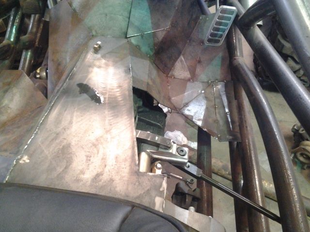

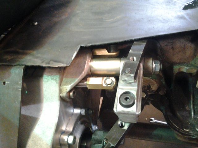

So I am trying to feep the shifters out of my leg so I am going to try this for now

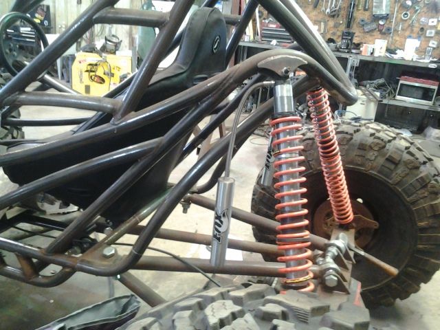

So with no propane tank I have a bunch of room to strech things out an then I will build a fuel cell to fit in what I have left

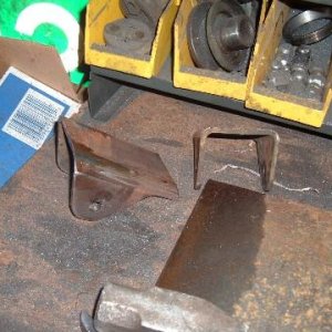

Taking care of the belt sliping problems
George, this is what zaynes turned out like... it was the only way to keep the shifters out of the legs and still easy to operate.
It did change low to the back and high to the front. :dblthumb:
Just a thought
Re: angryfab one seater
Well that's just freaking awesome . I don't know if that's what I need I'm not sure I could reach them with my big belly .I might pass out from lack of oxygen. I'm pretty sure if I'm in the situations where I need to use them I'm going to be out of breath anyway from excitement.
I think I've come up with something but I'm not going to do the rest of it until I get my regular shifter in

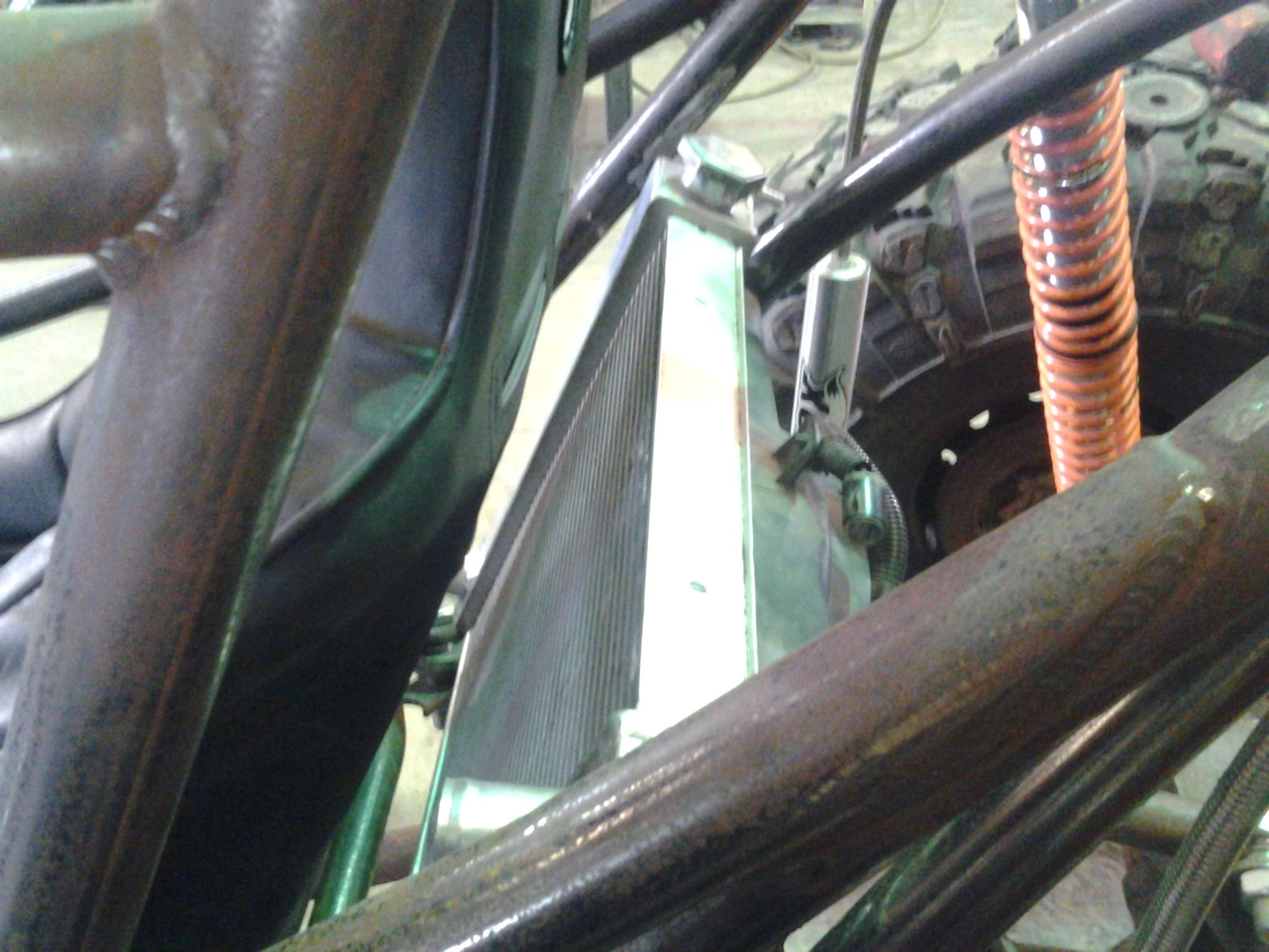

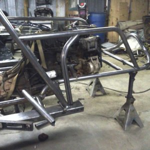

Ok so I ended up cuttin the outlets out of the radiator. and swapping sides to where they come out the front of the radiator. this gave me about 3 inches more room so now I can mount trans cooler on it an not have to have an extra fan

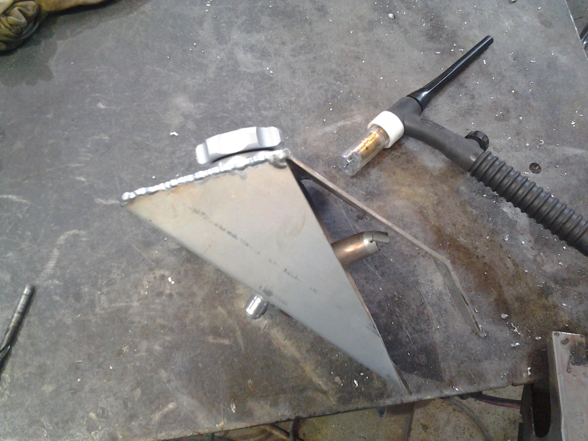

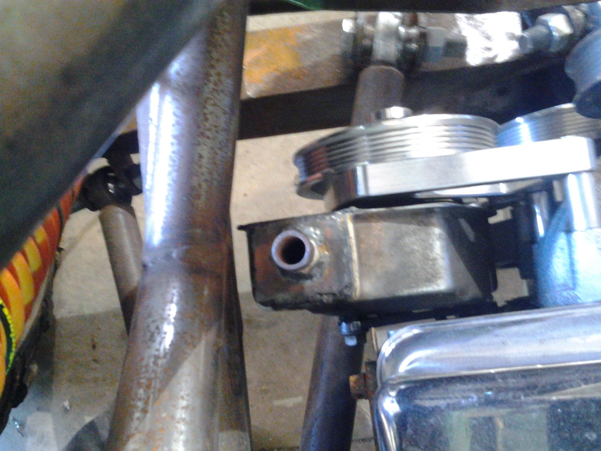

On my hydro sterring I didn't have much room to have a p pump an a regular size reservoir without it sticking up above the motor cage. so I took a power steering pump off of a 2008 LS motor modified it for higher pressure kept the reservoir that was on it and cut the lid off an welded up the return in the back. I put a nipple in the top an I am building me a smaller reseroiver that will fit . This way I will still have plenty of fluid with out starving my pump an a big ass reservoir sticking up out my buggy
Here is what I got of the reservoir so far

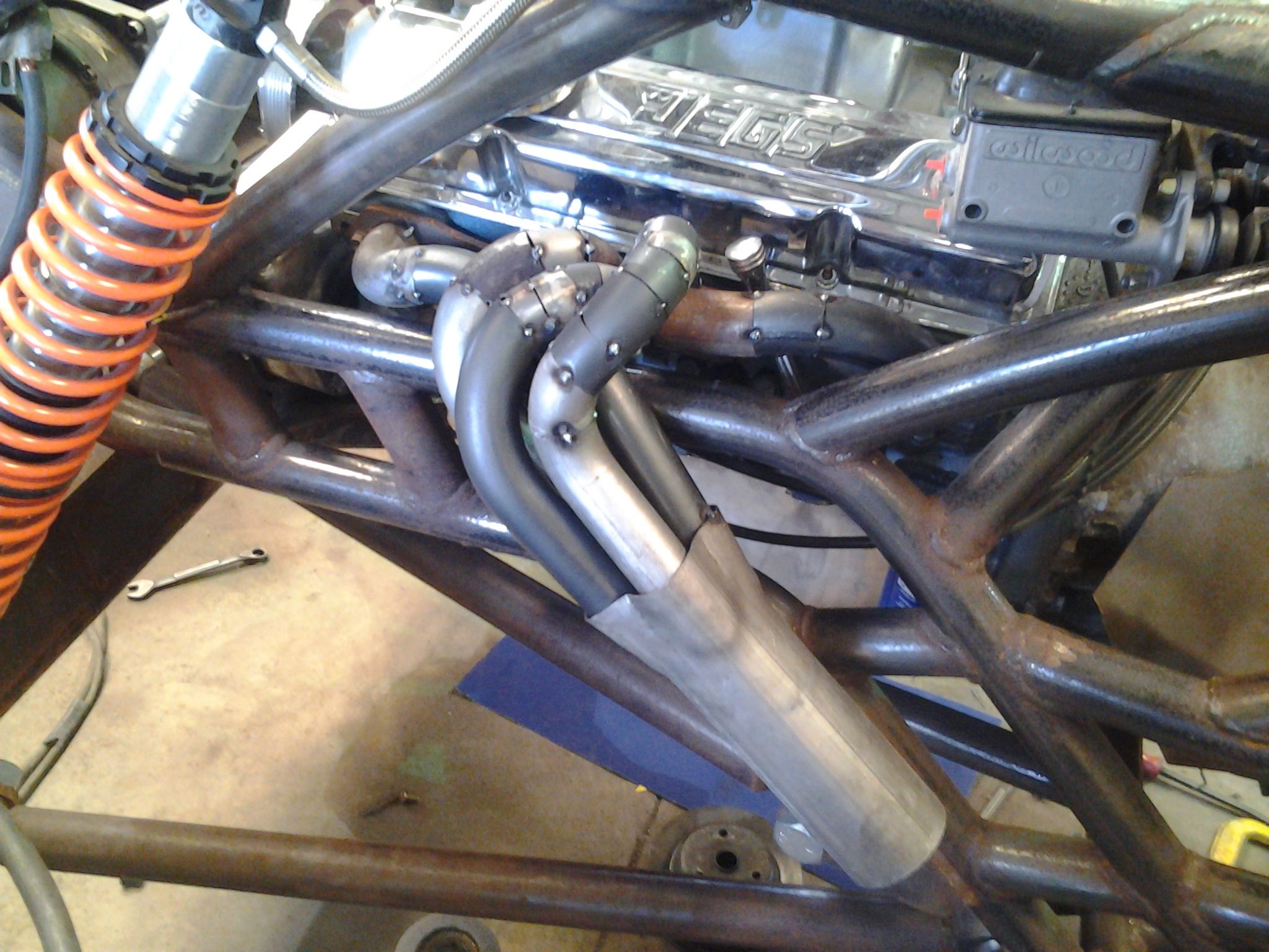

Got up this morning with a hangover . An thought what can I do that is easy so I tacked up the other header for thr one seater . I will tig it up an grind it when I feel better
