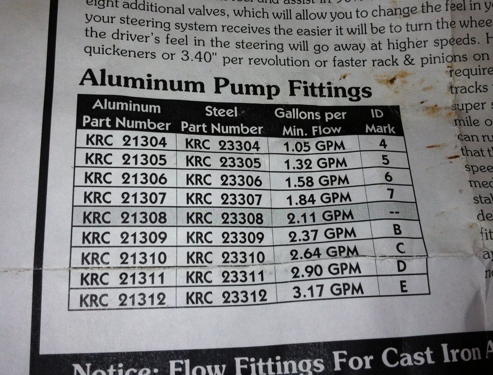

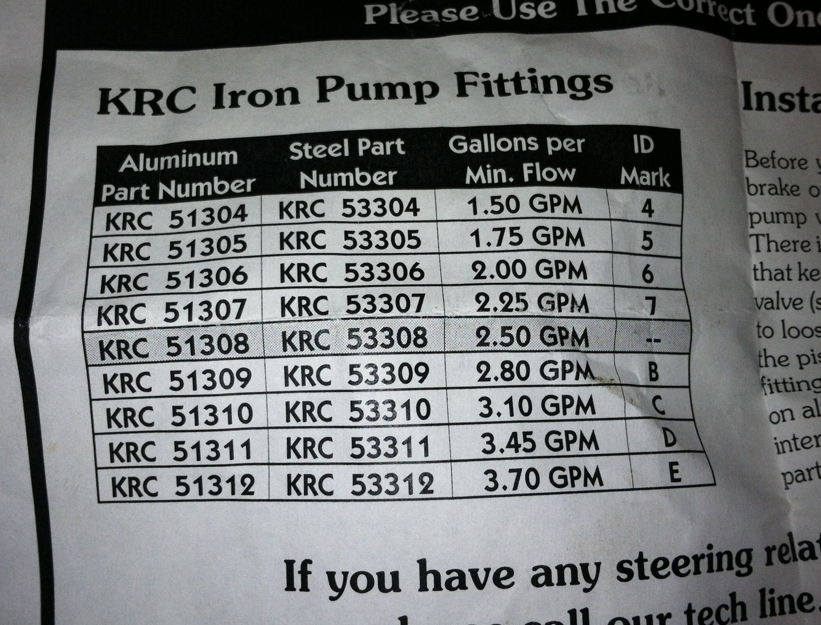

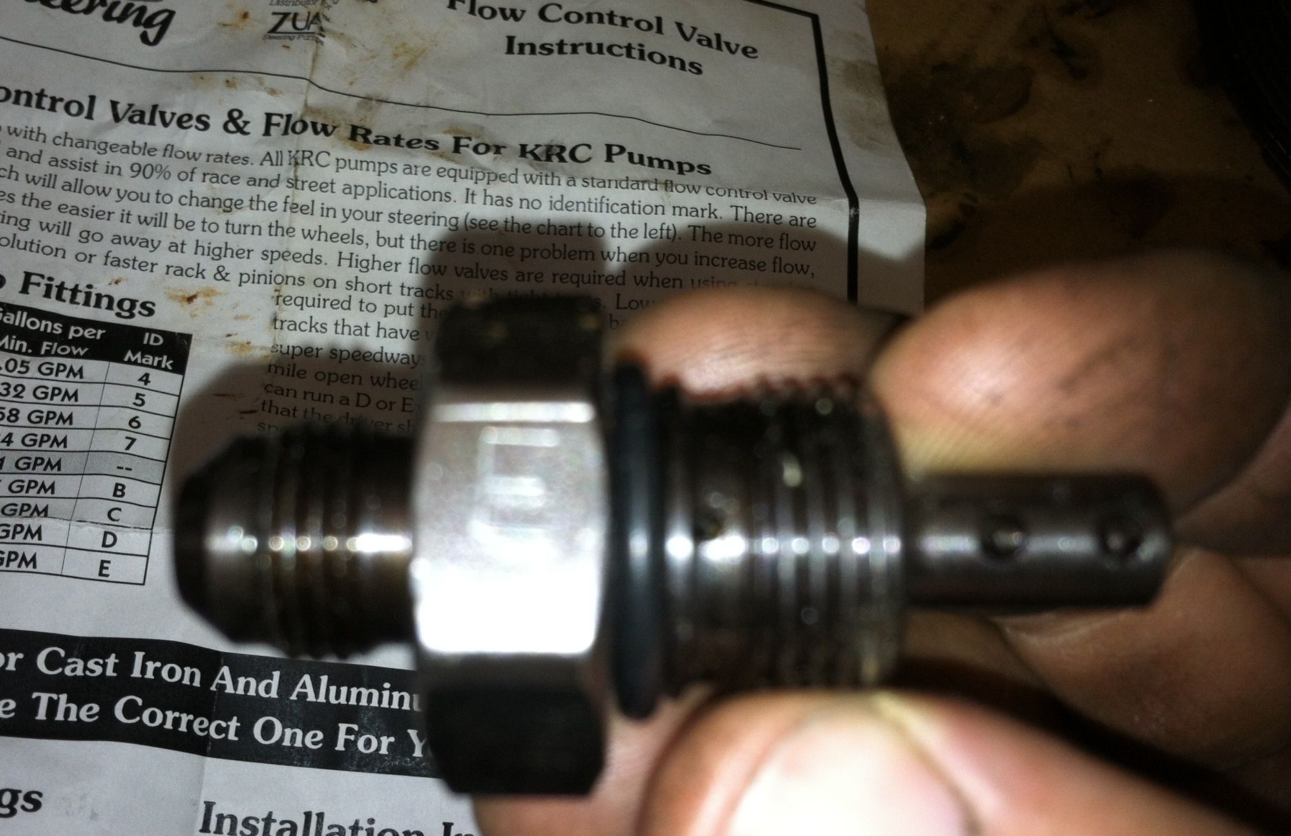

Anybody use the 13.5cc KRC pumps
Pic

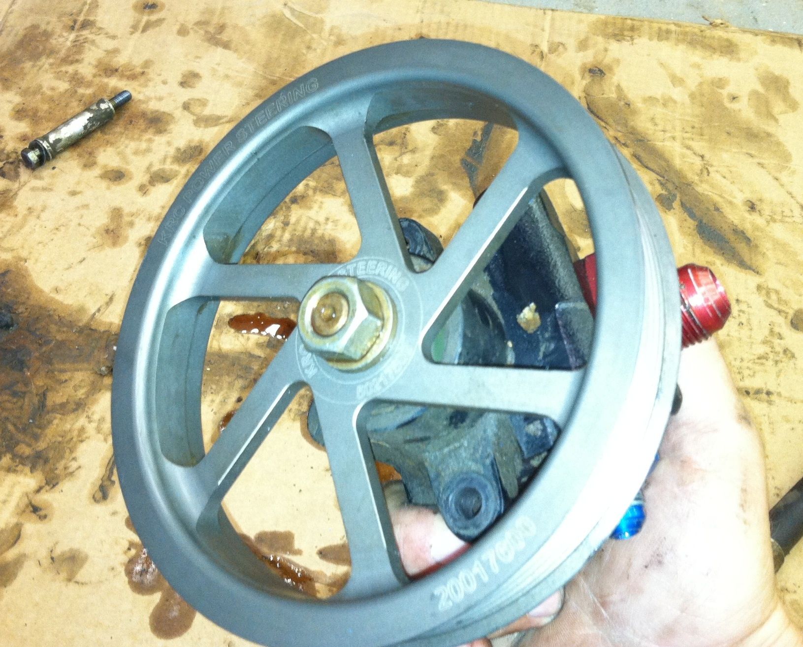

Well I'm diggin up this ol thread to report that I have been running my twin KRC pumps on my 4wheel steer bouncer and I have been VERY pleased with them!! I'm runnin the 2.5gpm fittings and it works great for me!! I also done a self centering rear steet setup that works awesome!!!
Elliot, I'm using the 6" serpentine pulleys on it and I started out with Patooyees twin pump bracket but it wouldn't clear my chassis with the upper pump so I used his to template the engine mounting holes and cut a new one and relocated the upper pump to accommodate my needs. I cut some 5/8" tubing with a 3/8" hole in it for spacers to space it out where I needed it.
