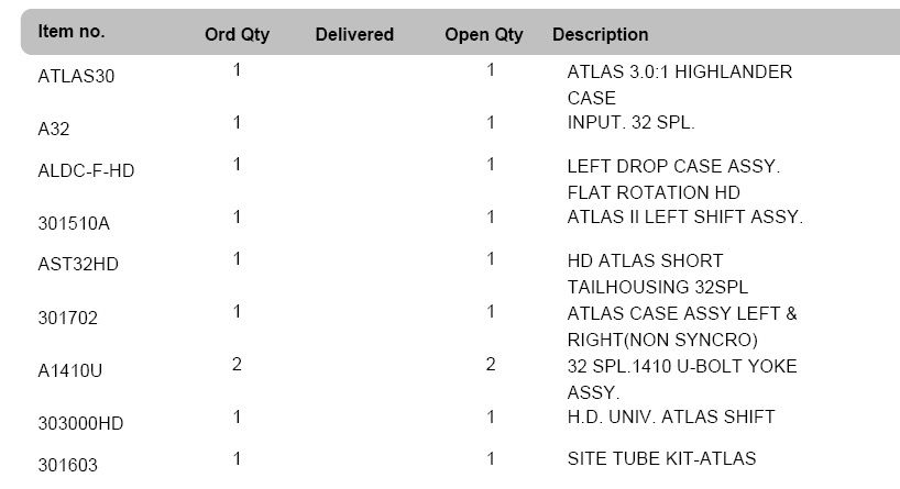

redneckengineered said:
IMO their website Atlas builder kind of sucks, at least for the advanced user. Some builder options are not listed at all. They probably do this to make it simple for the typical joe blow. I have found out way more about these cases from talking to people in the know at AA and that is how I came about on the "no synchro" option. As for build sheet, it's mainly a copy of your order that you get. It will list the options you selected and part numbers. Then you will get an invoice when the product ships.
Care to post a pic of your list for reference? Could be a good resource for the site.

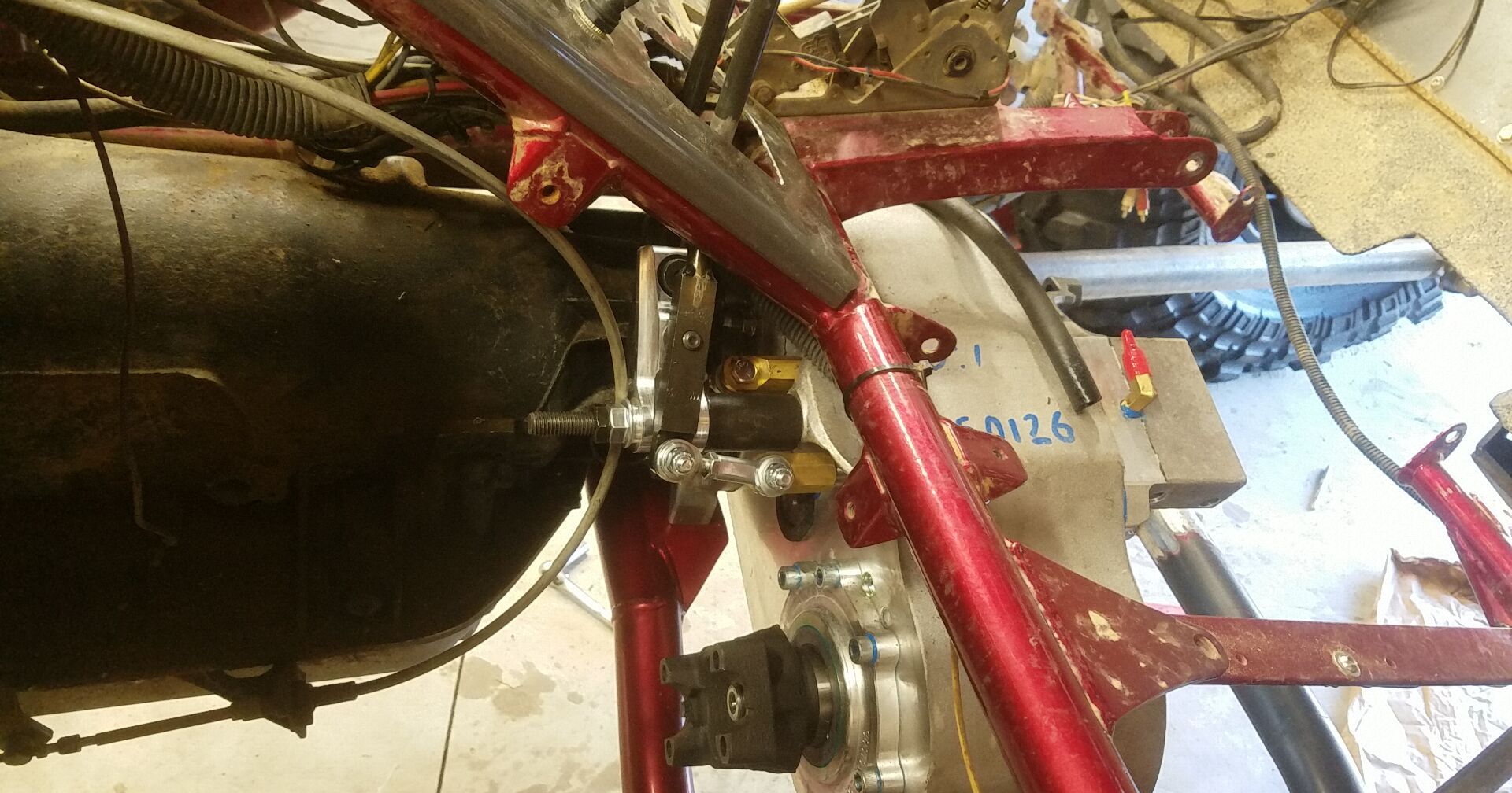

Here's one more tip. 2nd from the bottom line item, HD shifters. These kick the **** out of the cheesedick brass bushings with plastic inserts and e-clips. Little more expensive but worth it.
Forgot about this! Those were bad ass too!
Here is a pic of the HD shifter linkage set up.
I scratch my head to this day over their standard shifters.
AA engineer #1: We just finished development of the best transfer case in the industry. Thousands of hours of R&D, CAD work, machining prototypes, and testing have finally paid off! Now we just need a way to shift it.
AA engineer #2: Digs around in scrap bin...Here's some all thread, plastic bushings from my kid's R/C car that he broke, heat shrink tubing left over from when we rewired the coffee pot, and e-clips.
AA engineer #1: Hold my beer.
I will say when i threw those pos cable shifters in the garbage and went to the hd shifters mine is night and day. It will still give me fits from time to time though
