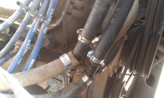

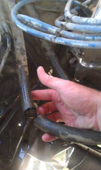

Cut into the hose from waterpump to heater

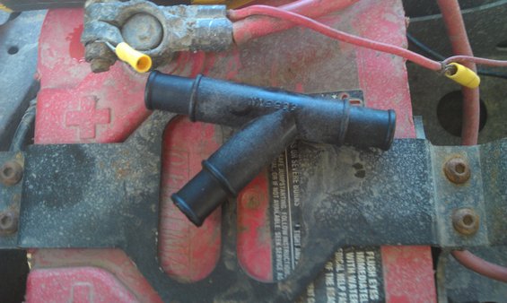

Added the T's
Cleaned up the hoses some :)

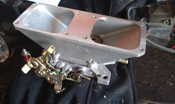

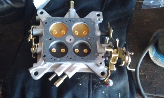

Assembled the throttle body

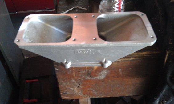

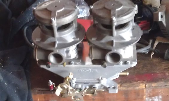

added the dual mixture manifold to throttle body

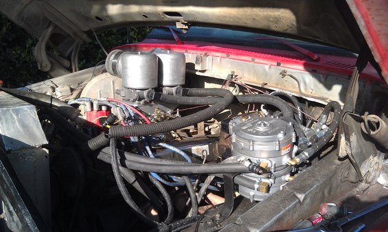

Added mixers to the top of it

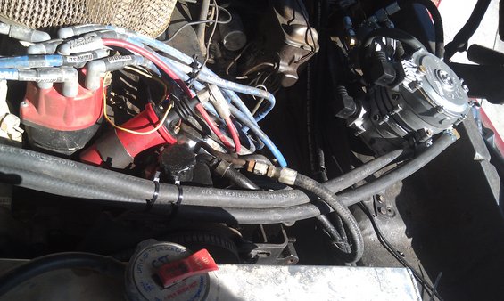

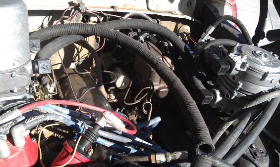

Installed it on the 460.

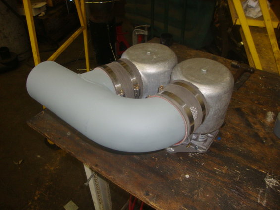

Painted the first coat on the snorkel air intake.
