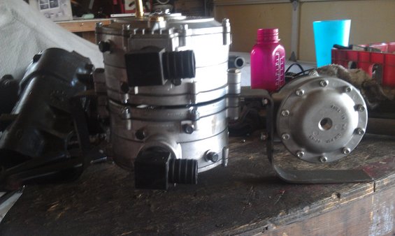

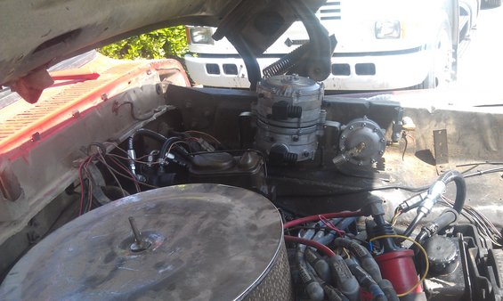

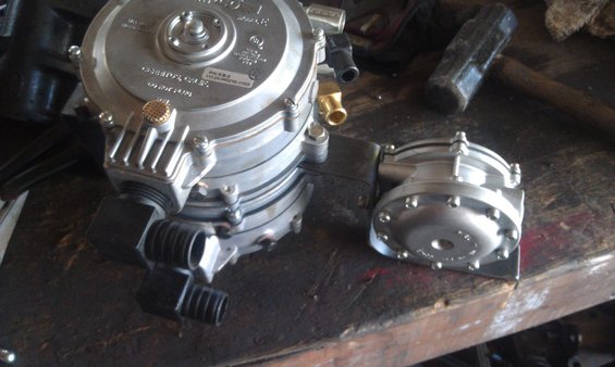

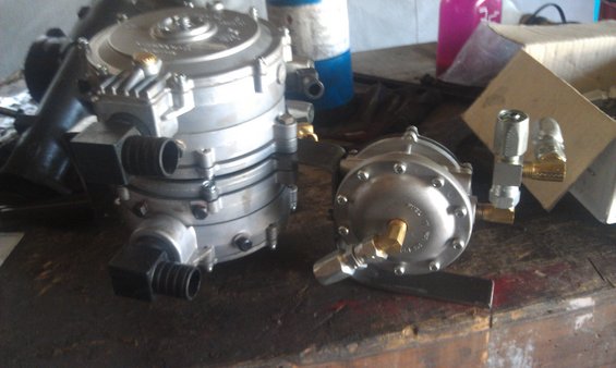

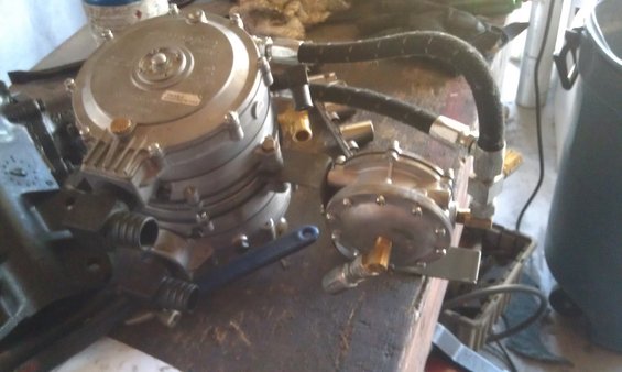

I have 2 425s on 521 stroker.
Works good!
Worked on propane system some!! :goodfinge
Dual Carb intake
The bracket i made to connect the 2 vaporizers and regulator
How it will set on the fender
Made some hoses
