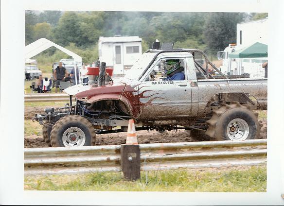

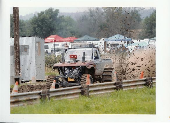

I know a guy that runs a yota with a 440 with an air shifted lenco and divorced 205 on 3/4 tons and 39.5 boggers. It fit good as the mopar engines are MUCH smaller than a chevy.. even a 460 would fit better....
Wonder if it's Ron's: Yota, 440bb, rearaxle yota/60 hybrid , frontaxle Land cruiser, 39.5 boggers, Radiator in BED, ETC.
If so the Rig was NASTY. It was a alright Crawler. It was a hell of a bogger and did AWSOME on the dunes with 33inch Paddles in the rear!
He just tore it apart to build a Land Cruiser.
