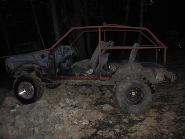

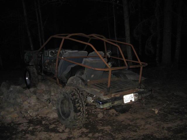

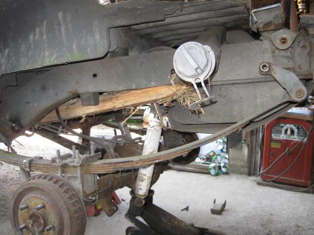

So mothers day came around. and it was either take her to breakfast or work on this damn BII, well BII work was cheaper than Bfast, so you know which one I picked.
I think she worked harder than me tho!:redneck:
And yes the other end of that tree is sticking out the front, over the diff and under the pan! :haha:

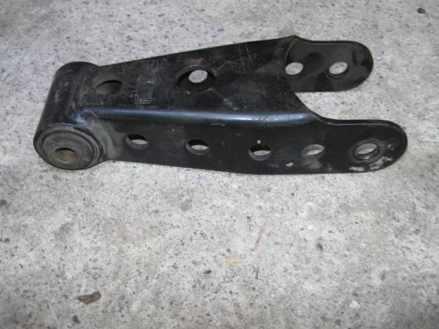

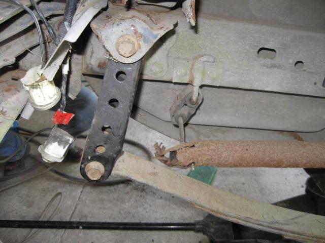

put a set of belltech shackles on it. Also swapped out the old owners aluminum lift blocks for some cast iron ones.
The internet taught me that long shackles and lift blocks were all wrong, so we installed them ASAP.
The ol lday is getting good at the tool part.

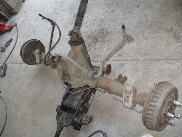

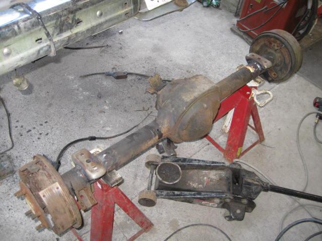

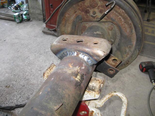

Cleaned up the ol Bronco 9 inch and put a couple new perches on it (actually old perches I cut off something else).

Please, dude. Thats more than the whole budget.:kissmyass::haha: But thanks.:beer::cool:
She already got an old cage cut off an old wheeler for free. I will continue to weld free scraps to it.

heres a sneaker. Pure baddassness. :bananallama:

Old rear is 3.54s, its $free.99 if ya want it.
New rear is 4.10. She got the rear for $50 (thanks super sami Brian) a locker off of CL for $75 and the 4.10 third for $75.
$200 for a narrow old bronco 9 inch with gears and a locker aint to bad.

PS, I think you put the shackles on backwards, unless the sideways pic is deceiving.
PPS, them be 3.45 gears. RBV noobs. :shaking::flipoff:
